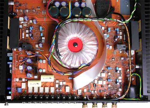

In this picture you can see a trim for each side of the amp. I think it's for the bias adjustment.
I'll post some pics here !
Otherwise, is there a procedure to control and adjust bias on this amp?
The emitter resistors appear to be 0.47 Ohms each. No bias info is given.
I would not adjust the bias pot unless you get good information about it.
Often in many amplifiers the bias is adjusted for around 26mV across each emitter resistor,
which would be .026V / 0.47 R = 55mA bias current.
Others adjust by the heat sink temperature after about 1 hour of idle, around 50F.
But maybe someone knows what Rega specifies for this particular amplifier.

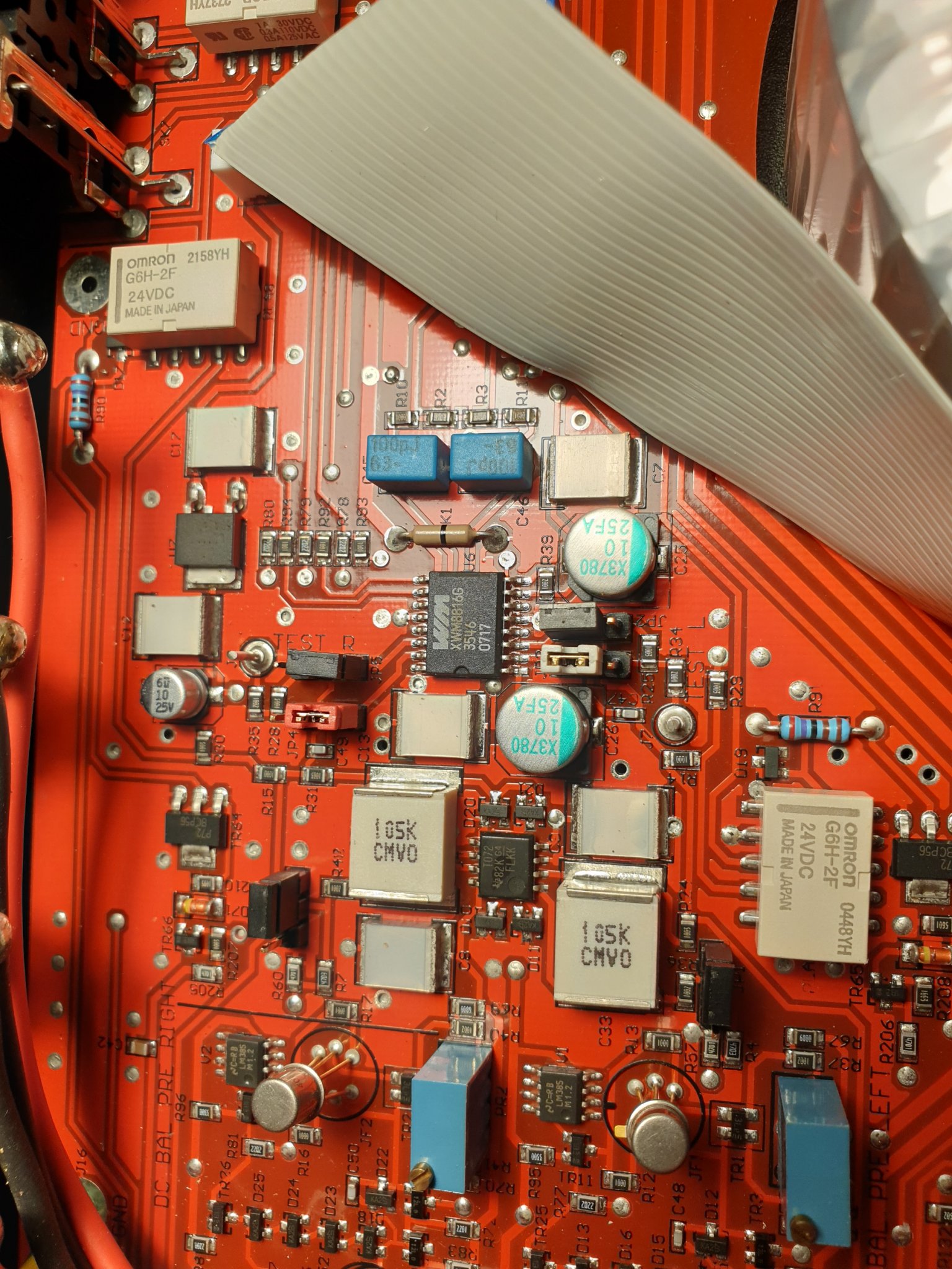

On each power amplifier there is a "DC TEST" jumper.
It allows to insert or not 2 capacitor in the circuit.
Does anyone know what this kind of jumper is for?
Other informations, the emitter resistors of my amp are 0.22 Ohms each and the is 2 IQ tests point per side amp.
Some news, I haven't done any measurements yet because my probes are too big, I'm waiting for finer news!

Hello,
I made progress on troubleshooting.
it is located on the preamp part.
When the amp fails, I no longer have a signal at the output of the XWM8816G (pin for 15 R and 2 for L ).
the R and L input signals are still present. the +5V supply too.
The chip have a little brown aspect.
If someone know where i can find a original XWM8816G for a good price ...
I would try touching up the solder joints on the chip before trying to replace it.
The smt joints can be bad but still look ok.
