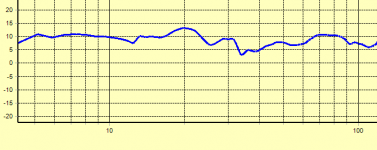

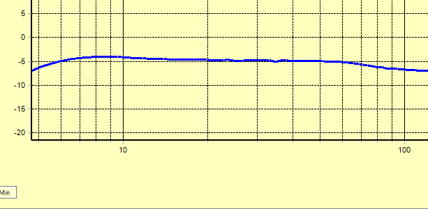

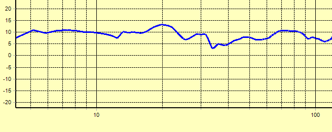

Two images, one without EQ and one with EQ. No smoothing on measurement
