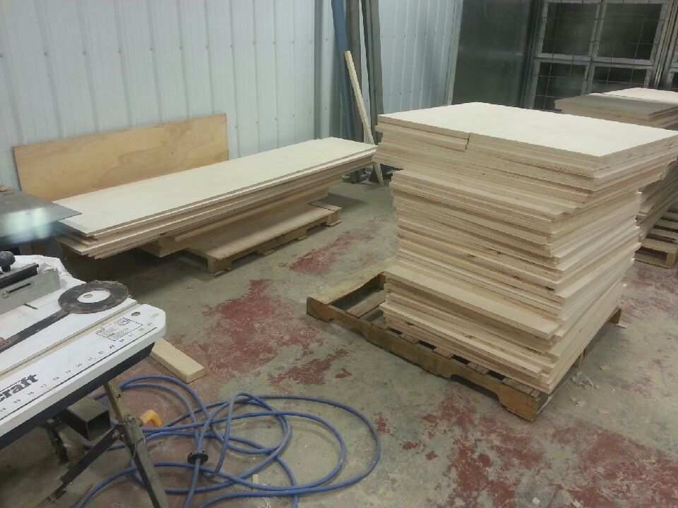

Looking at 6 boxes for 6 x 24"
I can get 4 x 8 sheets of .75" Baltic birch and only 5 x 5 of 1"
Not sure if .75 will work for 24
If adequately braced, .75 BB will work fine.Not sure if .75 will work for 24
FWIW, you gain more stiffness quicker by adding more bracing, so material thickness per se only dictates how much bracing is required and since these are subs, the lighter, cheaper, well braced 3/4" void free plywood panels is the best overall choice and why it's so popular in prosound.

They are both $70 each but obviously more panels out of the 4x8
I figured 220 lbs empty with 1"
280 loaded with PDN 24
31O with PD 24
ISH
31O with PD 24
ISH

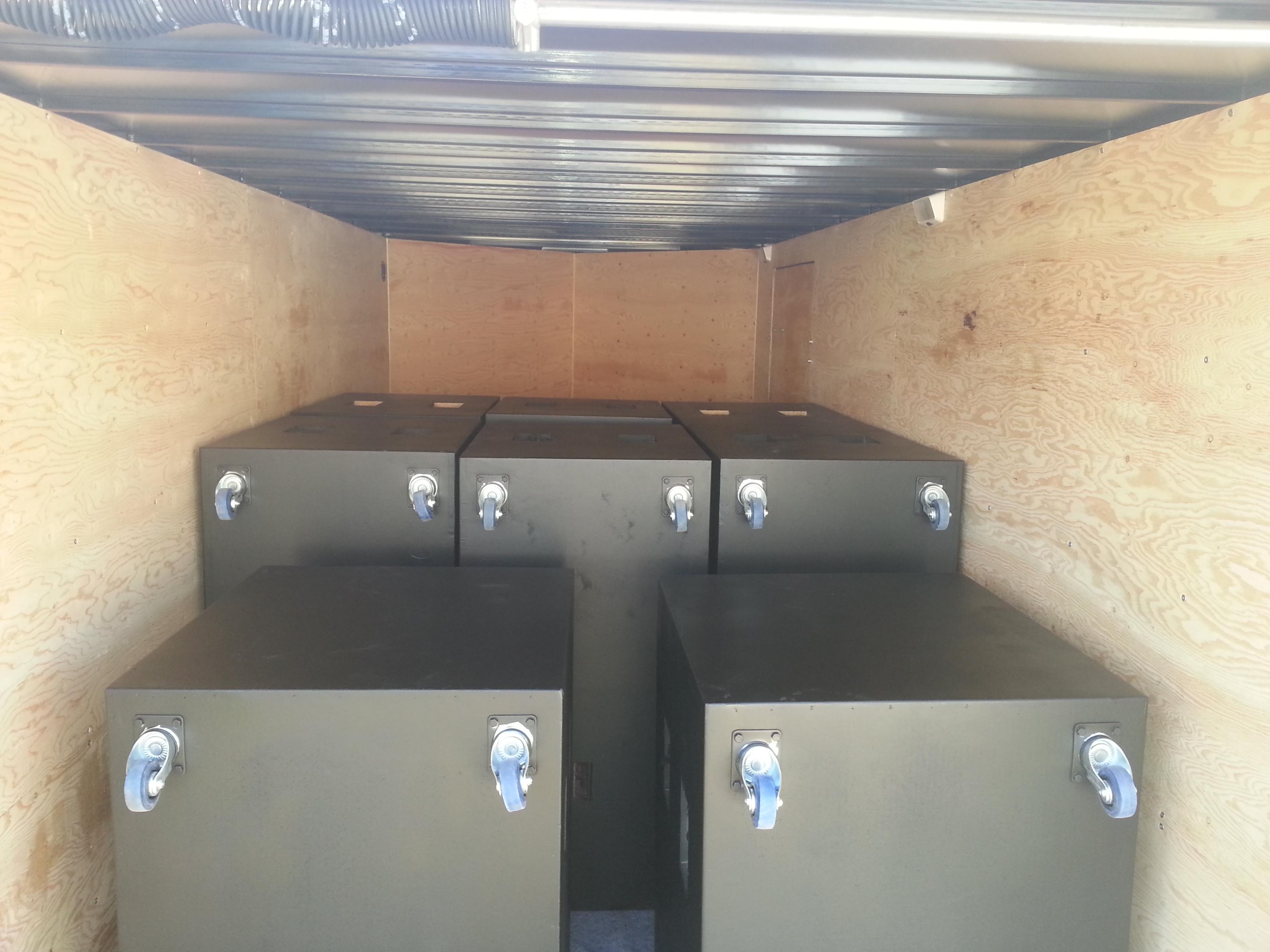

My cabs weigh close to 300# each with drivers and even with the appropriate sized casters and push/grab bar, they were a struggle for two of us moving them from my original shop to house to new house and all the stairs, etc., this entailed back when still fairly young and now I can't safely even tilt them back to engage the casters, so will either have to pay some locals to move them or saw them up/splice them back together, or not.
Four casters would help of course, but still requires at least two strong people and for HIFI/HT apps, spacing them off the floor compromises performance a bit.

I use 21mm ply for the 21" driver cutout board, not to save braces, but to ad a little stiffness when the hammer goes crazy.
I guess 1" is something like 18+18/3mm = 24mm right?

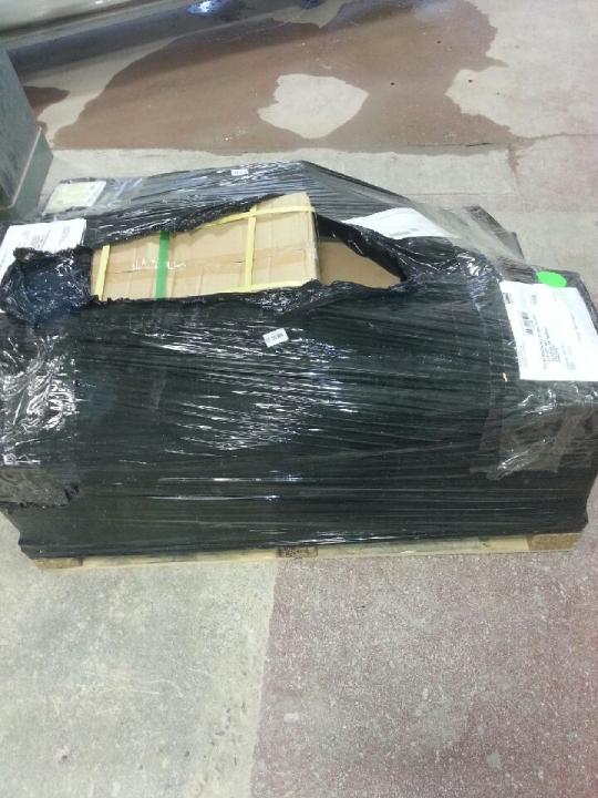

I have put in a big order for drivers only and since this all started back when a dealer for a local speaker company called CSW (SW-218) quoted me $1900/box and I actually thought about 6 boxes for a 3/side combination. .
But somehow the final numbers came to $15, 500..ish so I declined(his profit/taxes) and said to myself. ....
"Self, what can fourteen thousand buy me"
And here is my list...
PRECISION DEVICES(subwoofer)
2....PD-2450
4....PDN-2450
12..PD-186
FANE(midbass)
8..Sovereign.15-600N
B&C
8...ME-60 (60x40 horn)
JBL
6...2246 compression driver
20...4x8.... .75" BB
8.....5x5.... 1" BB
This was alot of shopping around though
Still need grills...handles...connectors ....wheels
But in the end I will have
4 tops
3..2x18
3..24...Per side
all for the price of 3...2x18 CSW
Hell the dealers cut alone bought me 3 ....2x18 boxes. ..diy of course

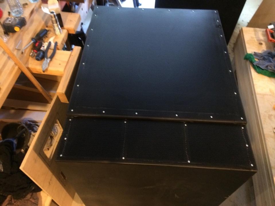

I have my cabinet design
26w x 30d x 38h =17.15 ft/3
Vent tuning to 29hz...6h x 26w x 20.5d
I may look into 2 corner triangle vents
Handles and casters and speakon plates all arrived. .
22 sheets of 3/4"BB & 15 of 1" BB arrive on Monday
