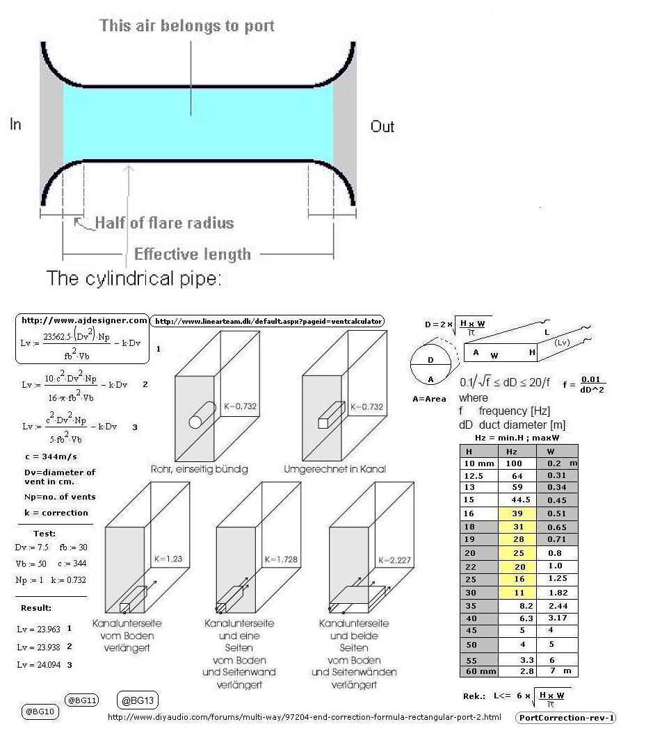

When using one or more of the cab's panels for a vent wall, its pipe end correction is greater, shortening the vent more than what a program typically uses, so will be tuned lower than predicted if not accounted for [see attached].

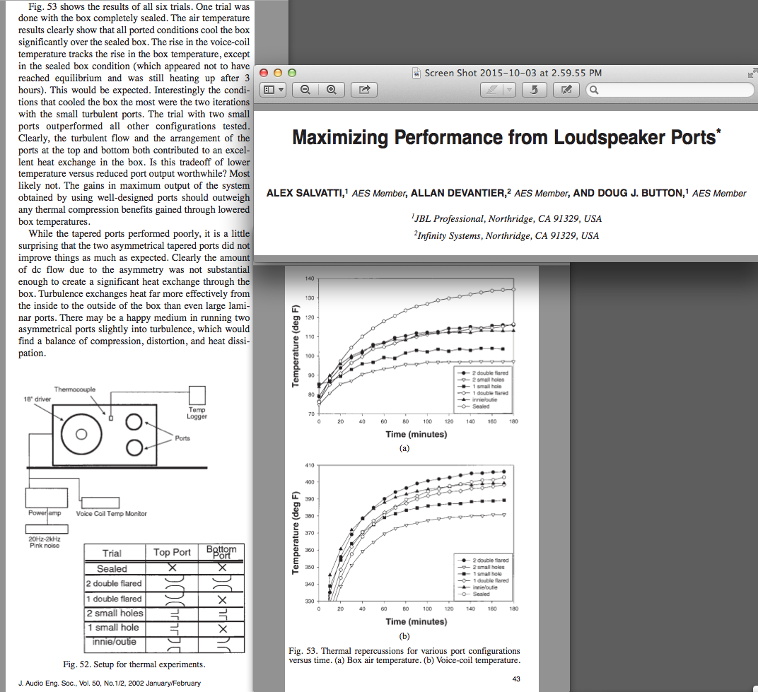

This paper has a lot of good port information :
Maximizing Performance from Loudspeaker Ports
ALEX SALVATTI,1 AES Member, ALLAN DEVANTIER,2 AES Member, AND DOUG J. BUTTON,1 AES Member
http://koti.kapsi.fi/jahonen/Audio/Papers/AES_PortPaper.pdf
An upper and lower port reduced voice coil temperature by around 10 F degrees compared to a single port.
Below are the thermal aspects of port cooling with various configurations. Of interest, though turbulent ports are worst for LF output, they reduce temperature the most compared to a sealed cabinet.

So your saying that using my dimensions of 28 x 28 x 39h=17.69cft is plenty for cooling vc
Also if using bottom panel to create the vent as In k=2.227 picture that the vent should be shortened for correction. .
So how do we get the correct h w l of the vent for 32hz tuning ...if thats optimum

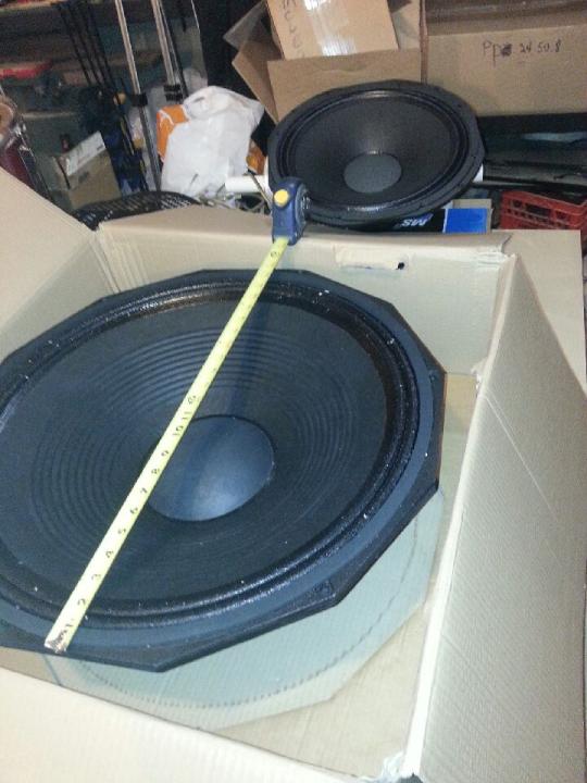

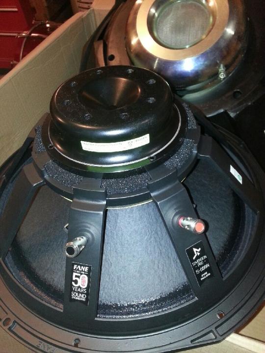

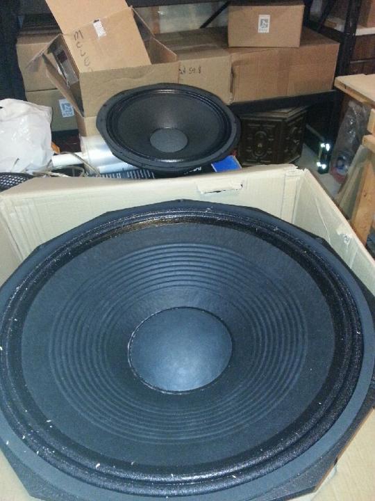

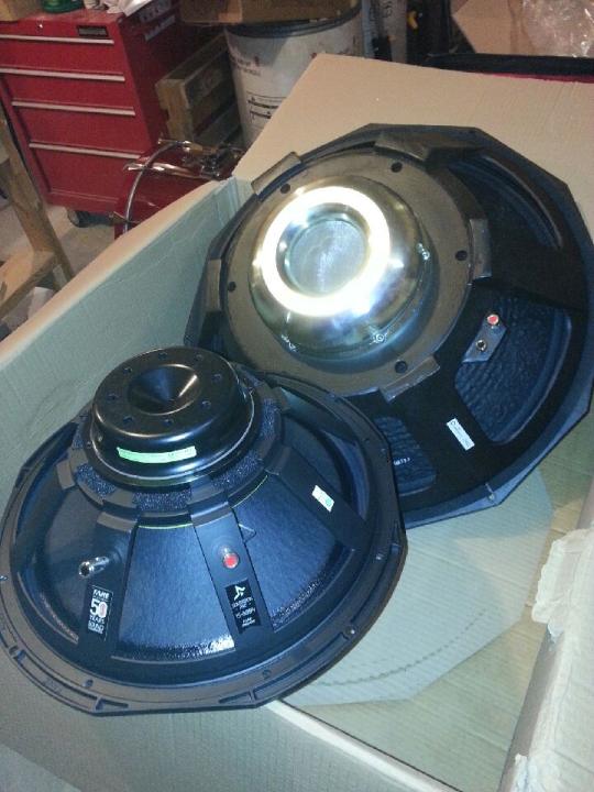

Wow these are big
And the PDN at that..30lbs lighter than the PD
Makes the 15" look like a 10" beside a 18"
Indeed they are rather massive, the magnet looks almost tiny on them, yet they are the biggest neo magnets I have seen 🙂
They are large enough to actually produce bass on their own, no enclosure required, this is how I use them at the moment, living in an apartment and all, but I understand that this is not the way they should be used.
