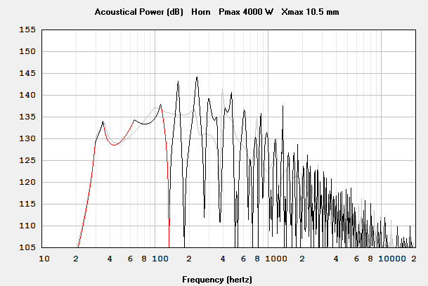

The PDN 2450 has an Fs of 31.48, an Xmax of 10.62mm Vas of 369.15L, not a whole lot of difference.
Given the same tuning, (with a larger box) the approximate 3 dB Xmax advantage of the PDN 2450 (requiring twice the power) would only gain 3 dB overall, hardly noticeable.
If you tune them lower, say 32 Hz, their output level will drop at least 3 dB, so their LF output level in the 32 Hz range will be about 6 dB less than the 2241 SPL in the 40 Hz range, about half as loud.
Did you measure excursion to see if your present box Fb actually is actually 40 Hz?
Why not tune the 2241's to 35 Hz if you want more "heavy 30's"?
Just happened to be looking at 24" today for lower tunings, so FWIW, scaled the PD2450 TH back to its published Fs and compared it to a vented alignment of the same total net Vb [Vb+Vv] = ~334.4 L using R.Small's recommended ~865 cm^2 minimum vent area for an unflared pipe, though didn't take the time to convert the rectangular duct to an equivalent [multiple] pipe vent, so the BR's net Vb might be more in reality if you go this route.

OK, then at a glance, with ~14 ft^3 net @ same Fb/1900 W x4 [closely coupled] = ~137 dB/m transients down to 24 Hz, assuming no significant thermal power distortion to lower it of course.

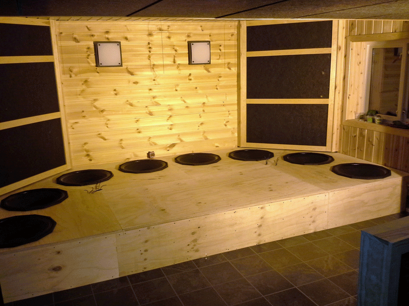

cool, I use 8 pcs PD 2450 in closed box
