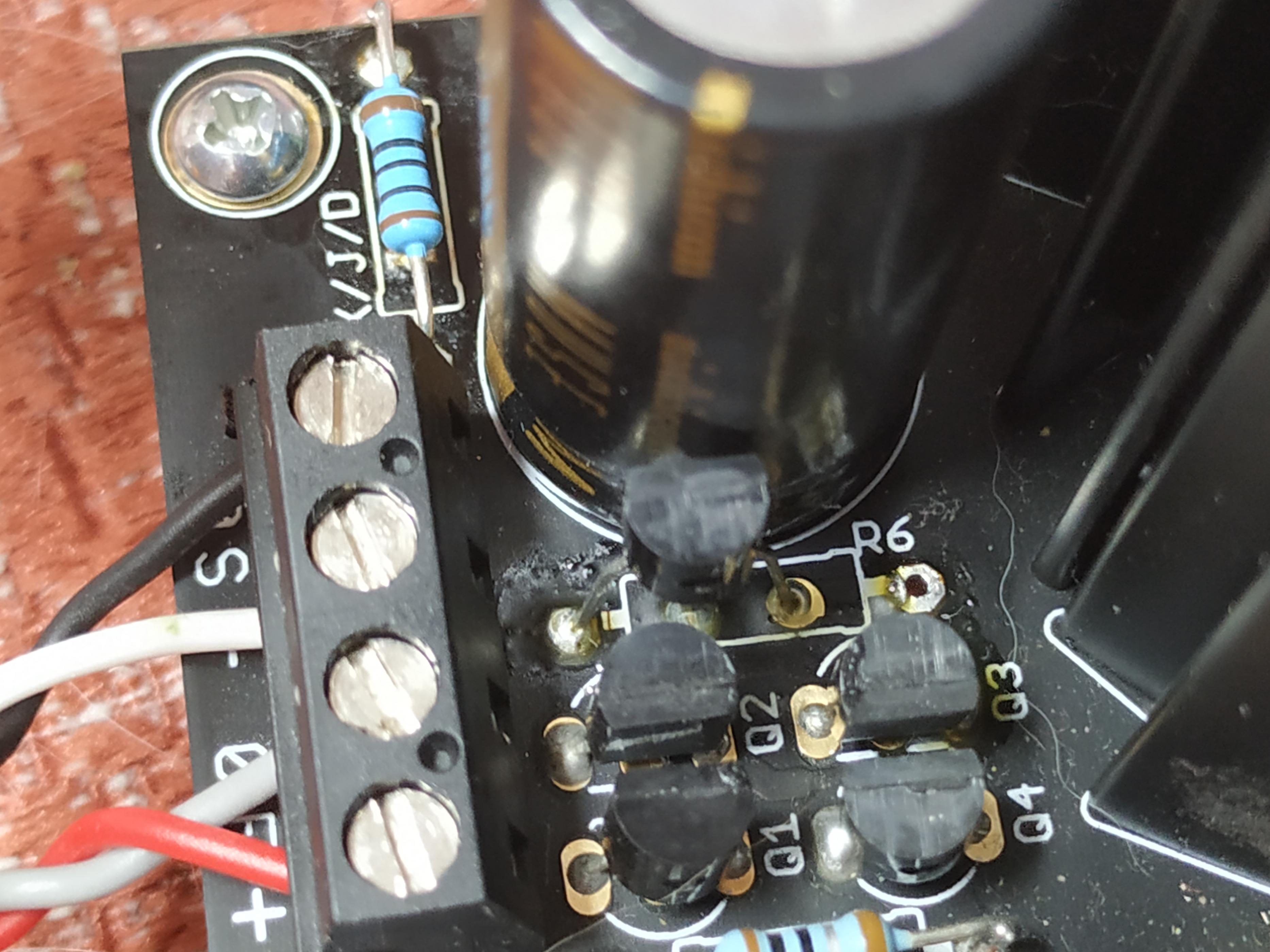

With the JFET in R6 the voltage has gone from 5.15v to 9.1V. How do I bring the voltage down to 5.5V?
Should I see if I can reduce further with one yellow led in 1, bridge in two and bridge in RxJD?

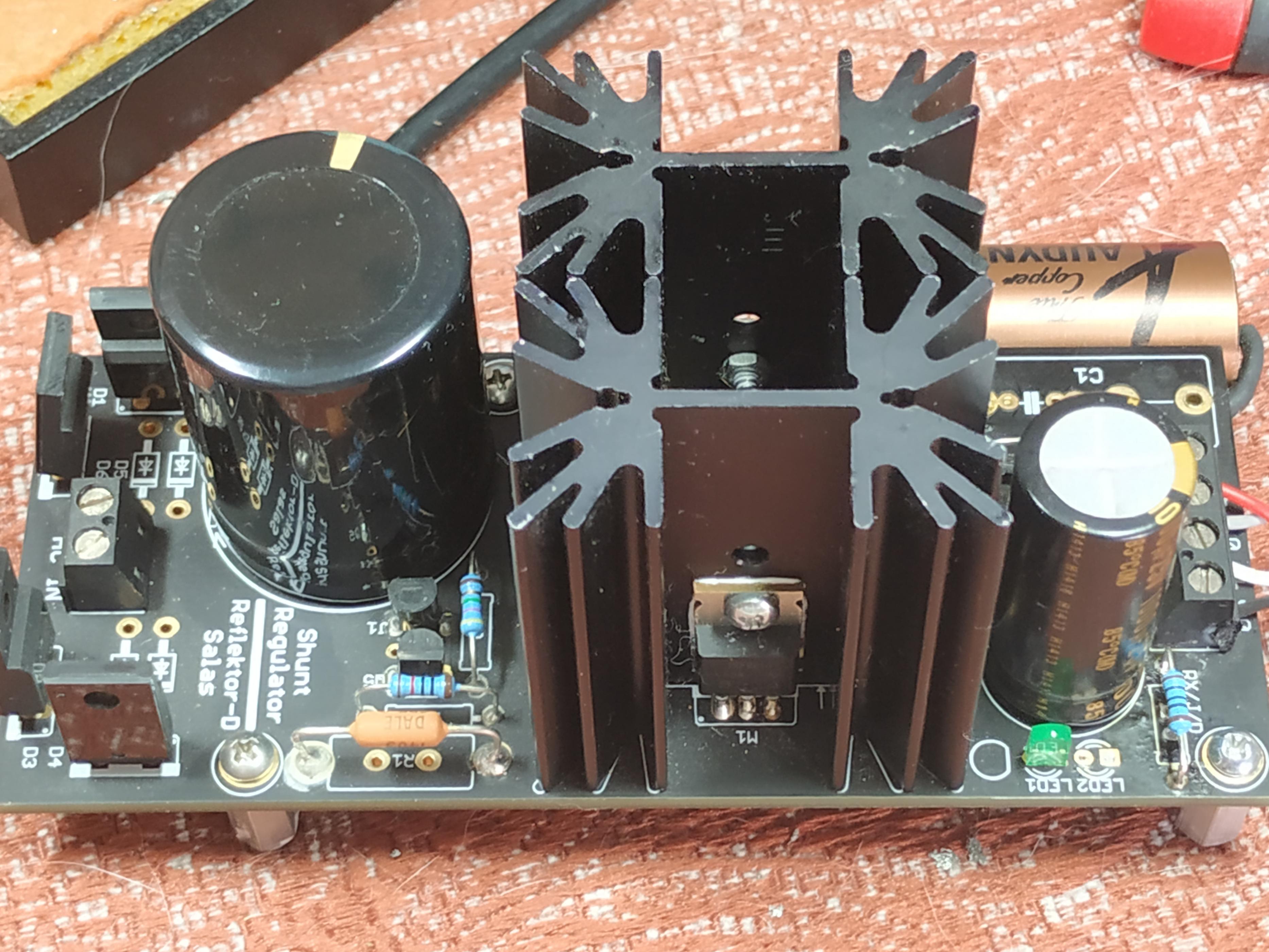

Here are some pics. Not exactly great soldering as Mundorf Silver Gold solder leaves a lot of residue which is difficult to clean.
without the 100ohm resistor in Rx it's about 8+V.
It needs a jumper replacement when removing that resistor. What voltage can you measure across the 100Ω ? That will tell us the mA running in the Vref.
2N 4403 E19
This is a transistor not a JFET. That is why you got a wild Vout bump.
I do have some K170BL 1H if this is a better choice. I used the parts from the full kits.
K170BL can still work although bit forceful. Lets check if it looks genuine. Show us a close up picture of it before you use it.
