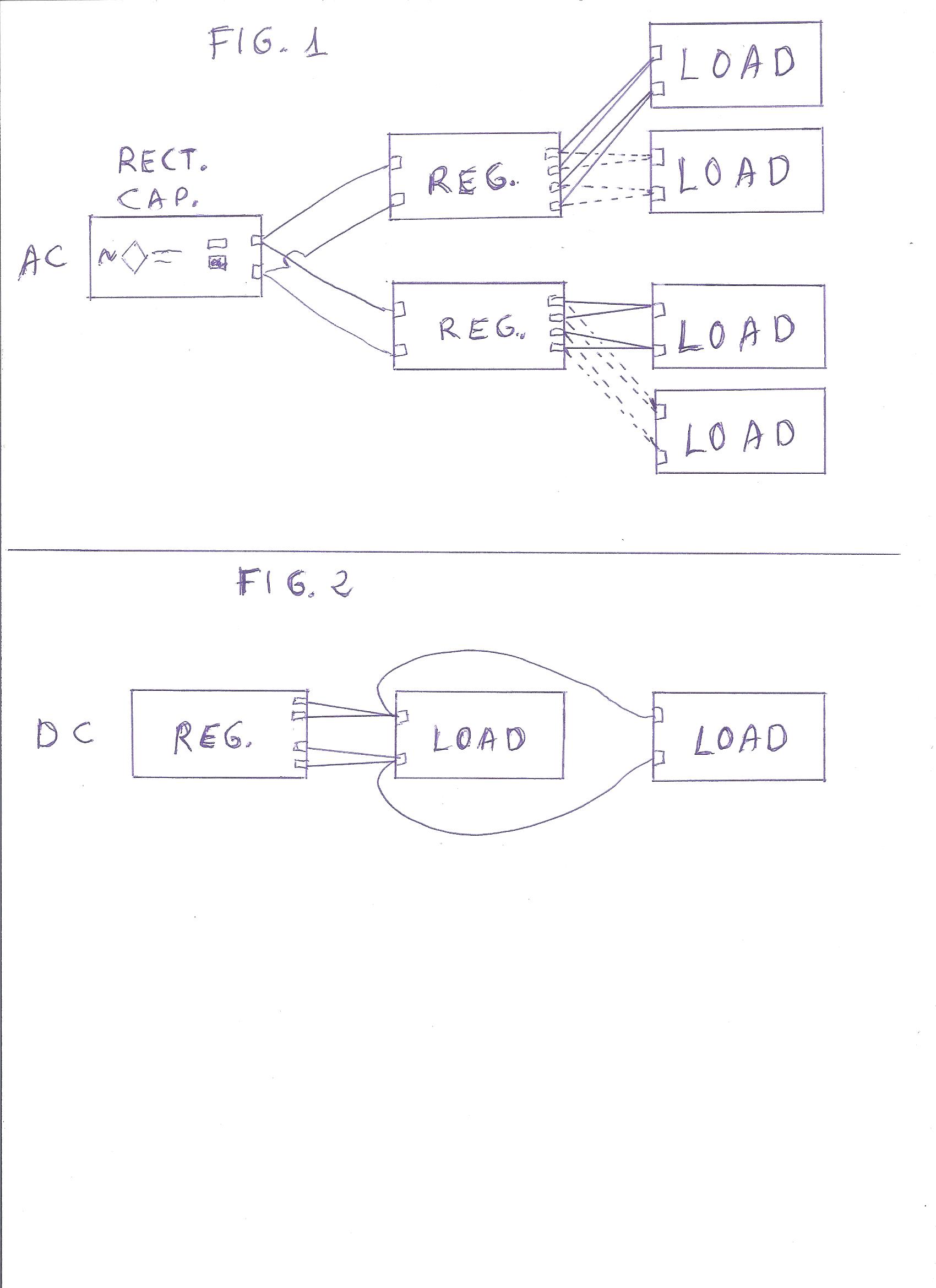

:up: Wich value 100nF? There is better SQ using one rectifier & one AC mains cap filter for each reg? I will do the question better? BiB is powering Amanero USB-I2S board + one part of I2S isolator. Reflektor is powering Cronus re-clock board + the other part of I2S isolator. The mains power transformer is a Selectronic R-Core with dual 0-9VAC secondary 30VA rated. As I more see it become more complicated. I forget the isolator need two isolated 3.3V, and I have only one 3.3V the other is 5V for the Cronus. Wow what a shock, I read the the IC USB-I2S isolator to know the working voltage & the Recommended Operating Conditions min. 3V & max. 5.5V and max. rating 7V Attached a couple of figures, I guess I have to use fig. 1?

Thanks Salas. The only I know for sure is that the USB-I2S isolator needs to be powered with two separate regs. to be isolated the I2S line. Could be a problem to isolate the I2S line to share the rect. & mains AC cap? I used BiB with Amanero a lot of years with great result, I prefered the SQ of BiB over Reflektor because I only listen DSD. So BiB for Amanero & Reflektor for Cronus. I have to left you Salas, today is the happy birthday of my wife and we will go to the restaurant to celebrate.

What is the tradeoff if wiring in normal two wire mode... not kelvin? My wiring won't be that long.
If wiring in Kelvin and then going to a terminal strip, do I need to continue with Kelvin wiring to final destinations. I have 3 destinations (isolation/re-clocking) that will be close to terminal strip.
Thanks in advance.
With two wire mode you avoid exposing sense runs to external interference and it can be a logical choice when killing little added short thick cable's resistance isn't a priority for the client circuits. Kelvin works best when all destination nodes come to a star arrangement with short copper lanes at a common terminal.
