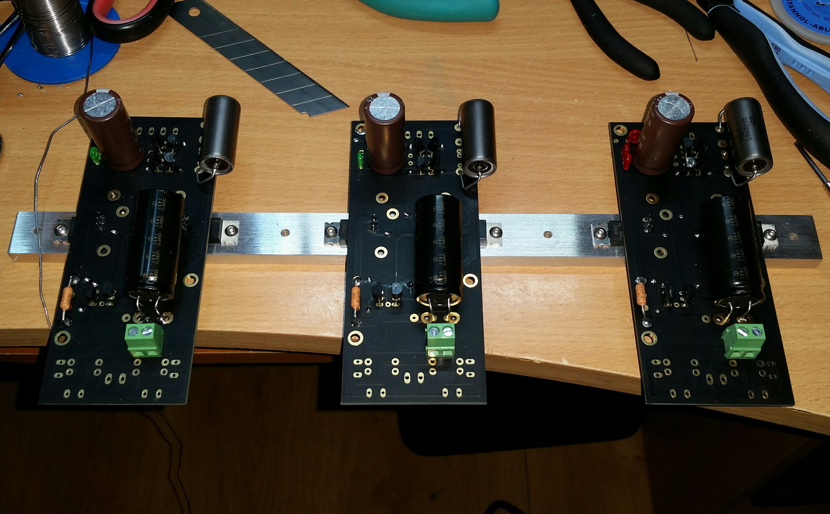

Ok, so three Ref-d's are almost done, all for dc input.
Two 3,3v for avcc supply: R1/2ohm, green/jump/62ohm,
C1/0,1uf K40pio +0,01uf mkp, C2 SilmicII 25v/1000uf + 0,1uf mkp,
Cm/ Silmic 16v/2200uf + 0,1uf mkp.
One for 5,2v WaveIO: R1/2ohm, red/red/red, same caps.
The plan is to mount them to the underside of a 500x500x1,5mm
copper sheet metal. Should be enough colling I think.
Guys I want your opinions if you may.

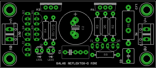

I got an idea to also have a smaller configuration for space challenged builds. Not that self sufficient or that versatile version as the regular Ref-D so to save in size i.e. DC input only, external sinking only, two wire output only, R6=JFET only. The MOSFETS located at one side's edge so to can mount/cool them either on side panel, bottom panel, common external side sink. In all those three mounting styles they need be electrically isolated.
The layout is ready at 76mmx33mm. Kept it through hole technology so it can be assembled or serviced with components we can still see and hold. I named it Reflektor-D Mini.
I want to know if you think it will be useful enough as an alternative so I will propose it to also be included in the GBs?

There need be some already proper spare DC line to feed it or some available space for Tx and rectification+filter cap somewhere in the box though. But the mini itself will be more maneuverable to position.
I have mounted the small parts on the top side and what you see is the bottom
side. That way i could get the parts that need cooling turned the right way.
They are mounted to a hard aluminum bar that will be bolted to the copper
sheet metal.
Creative mounting indeed. You have also insulated M1s & M2s I would think. Now I see why you particularly would prefer a mini as I described it in the previous page. You don't need the AC input or the self sinking in your build. You could even chop off the rectifiers end. About oil capacitor, other C1 biggie, or large local Cfilter DCin, the mini would not have the space though.

Its the same circuit with same component designations as Ref-D but without sinks, rectifiers, large filter capacitor, instead of R6 it has J2. Output connector is two pins. I have added an image in post #567

You mean the extra pads inside Rx/J/D for a third LED we have in the Ref_D to reach 7V also. That was to can be used used as pre-reg for digital unit with own 5V LDOs. I did not see much use of 7V here so I forgot to include it again. Good catch, I will include it.
