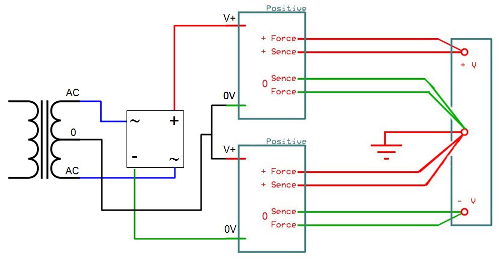

if you have dual secondaries and dual rectifier to create two isolated supplies then you can use either +ve or -ve regulators on either of both of the isolated channels.
Then combine them later to create a dual polarity or multi voltage supply.
If you have a centre tapped transformer (or dual converted to centre tapped) and a single rectifier then you must use a +ve and -ve regulator pair to create a dual polarity supply.
Thanks for AndrewT clarifications. On my BIB, it uses centre tapped transformer and a single bridge rectifier (+v and -v pair). I am pretty happy with this configuration.
Problem is, there is no -v Reflektor-D pcb from GB. I have been thinking to modify +v Reflektor-D pcb to -v since the circuitry is quite simple.

So, I'm using Tea-bags reflector boards and parts to power the 5v5 for the Twisted Pairs Buffalo Sabre II DAC board.
When I connect it up the voltage shows 4v85, and only about half of the LEDS on the Trident Regs, mouted on the DAC, light up?
Checked the current draw of the DAC by running the B+v in series through my meter and got a 406mA reading, which it should be. Then noticed that the LEDS were all on? Also, the voltage read 5v5, which it also should be.
Powered up again with out the meter and got 4v85 and some LEDS not on again!!??
Did this back and forth several times! I'm stumped. 😕
Solved! DODO had sense & force wires crossed up.
