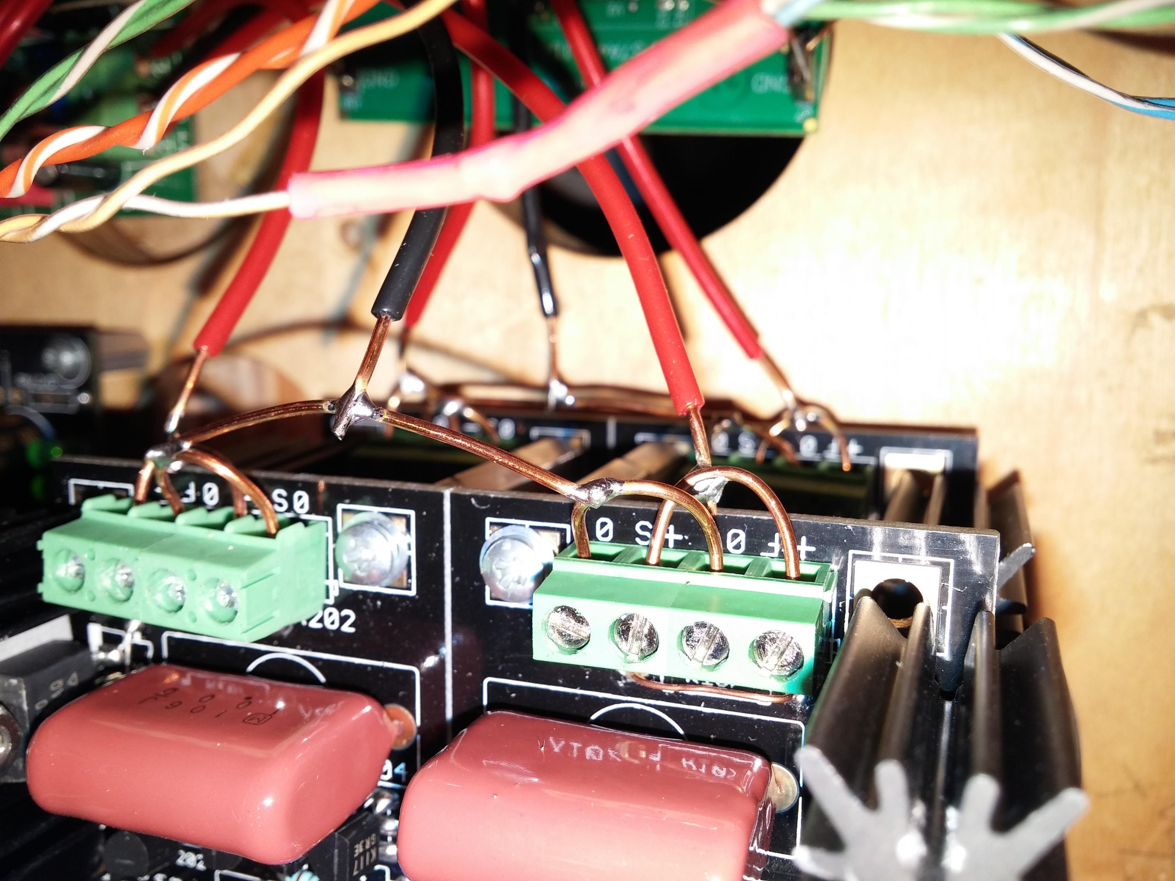

Wiring
I removed the single wire runs to the legato and made jumpers. I use 2 15 volt+ and - ps, so 4 total. This way of wiring defeats the sense function but sounds more dynamic and open. Did the same with the reflector powering the Buffalo III. More direct and punchy. Didn't expect any real change due to wires were only about 5 cm long.
Salas,what is the technical explanation for this difference on the sound reproduction.
If the sensing isn't representing the real consumption nodes with what is sees at the client board's power connector it may well be better to just go nearest possible with heavy wire and bridge the sense at the reg's connector. No info is better than wrong info.😉
Say the client PCB has various consumption points for ICs etc. along a long thin lane that ends up to some power-in connector or pad. And a general ground plane. No star connection for anything. Some blending goes on along the power line's intermediate track resistances. Plus presenting a ground point which is general and about. If the reg senses an undefined situation for its reference then its no better off than sensing closely to its own output to at least keep shortest antenna area to possible noises. Check both methods i.e. two wire and four wire when in doubt. Distance, wiring style, and load PCB peculiarities will maybe show you enough subjective differences on what to prefer. Possibly visible on a scope as least power line interference as well.
