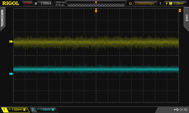

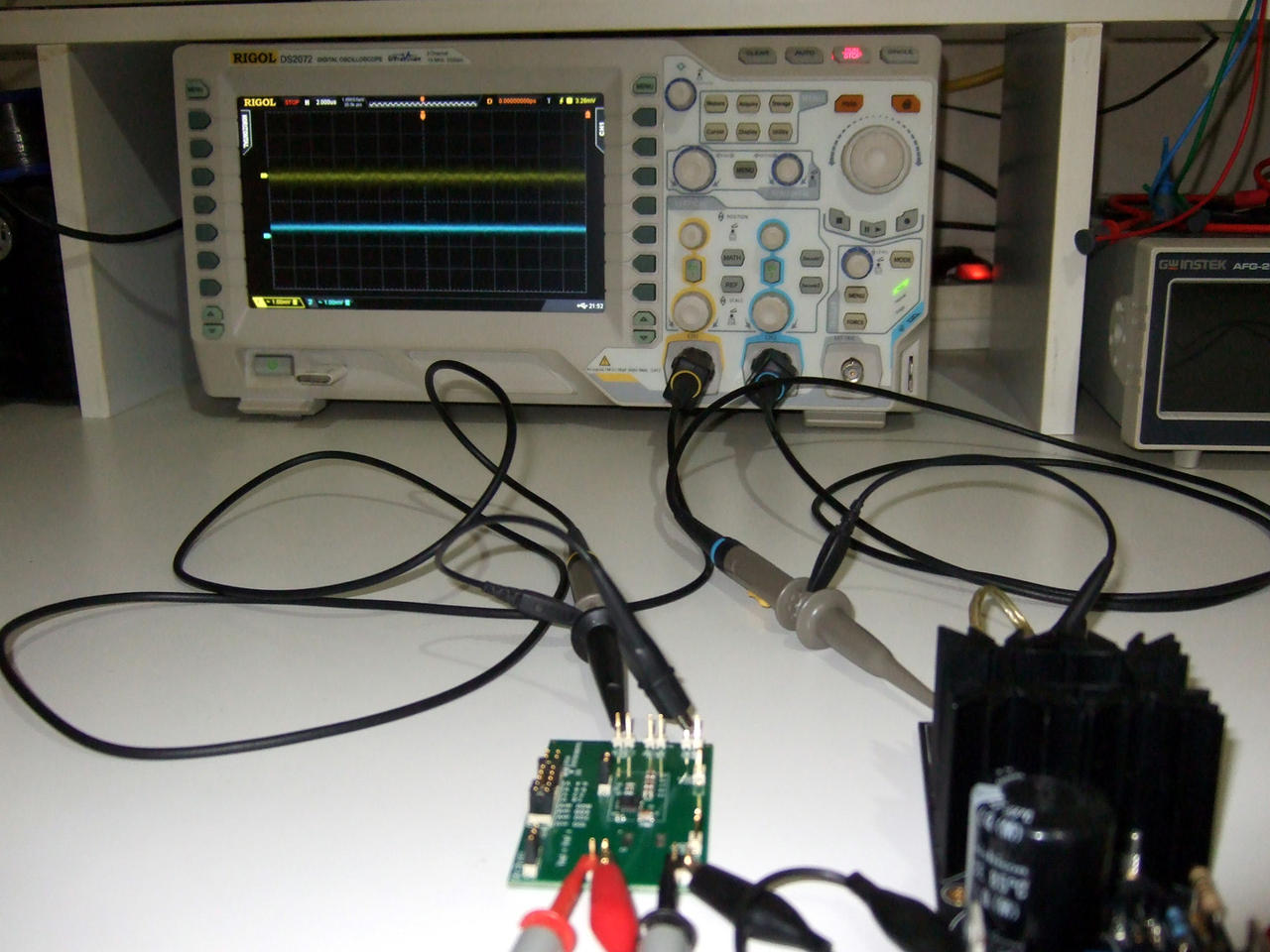

There is also a zoom lens to left click on those two. I did not have them as saved files sorry, only had the links. But now I can save them.

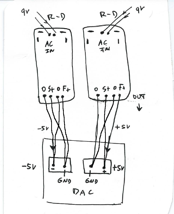

Hi!
Can you someone please help me here?
I am trying to make things safety.
I have all settings to connect two R-Ds to a 1702dac board.
I just want to be sure that I am not making mistakes, about the -/+5 volts to the dac board, feeded by two RDs.
You have here a draw with the squematic.
Can you please tell if I am doing it right?
Thank you very much!

Of course it works. Making a double polarity supply out of independent and isolated positive polarity supplies is like stacking batteries and wiring a middle tap between them.
