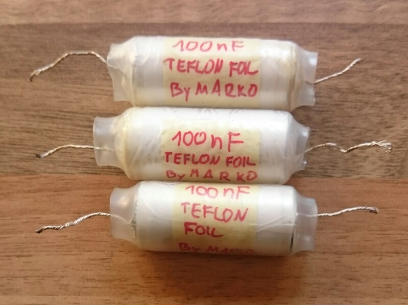

Inspired by the tweaking here I ordered some Russian old stock Teflon insulated Al foil capacitors for C1. They need some tweaking as they are encased in an iron can and have magnetic output leads. After they are freed from their "prison" they should do magic especially considering they're worth only a few bucks.

Here's the board, I'm not particularly proud of what I've done but i managed not to kill anything. And the now custom russian Al foil teflon capacitors.

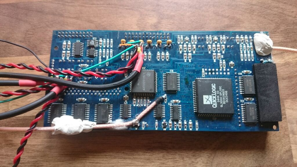

After I installed the new clock and glued the coax cable, the glue failed to hold on to the teflon insulation on the coax and the cable teared the traces it was soldered to. I managed to track and repair the traces, they passed the continuity test but the DCX failed to start after that. I also had issues with oscillations and grounding. I have to carefully rethink the whole project.
Bad news. Wishing you better luck from now on.
Is it a wide bandwidth power amp with no series output coil? Are the speakers alright at least?
Could there be further layers meeting in the pad that the cable pulled out?
