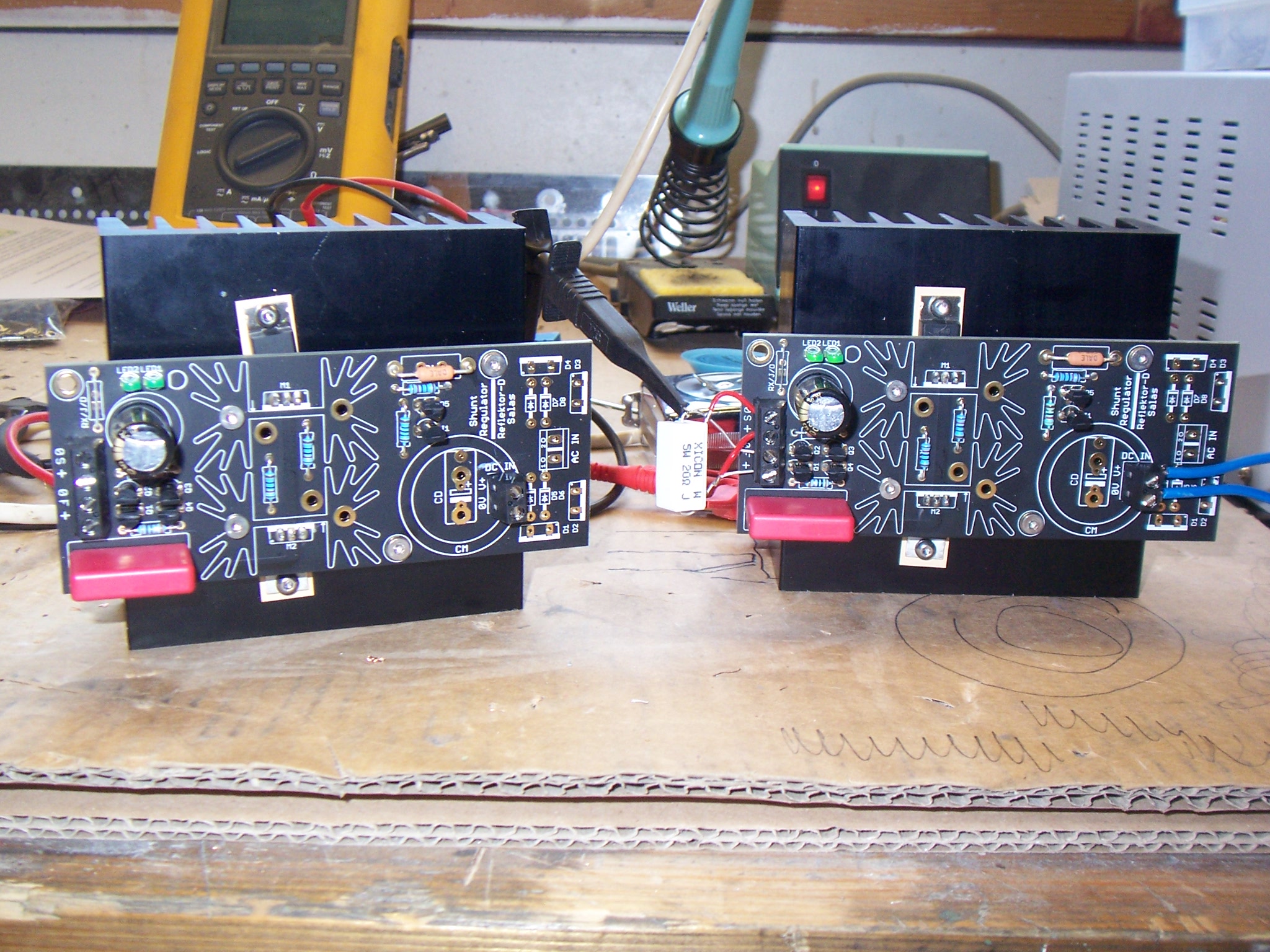

hi,

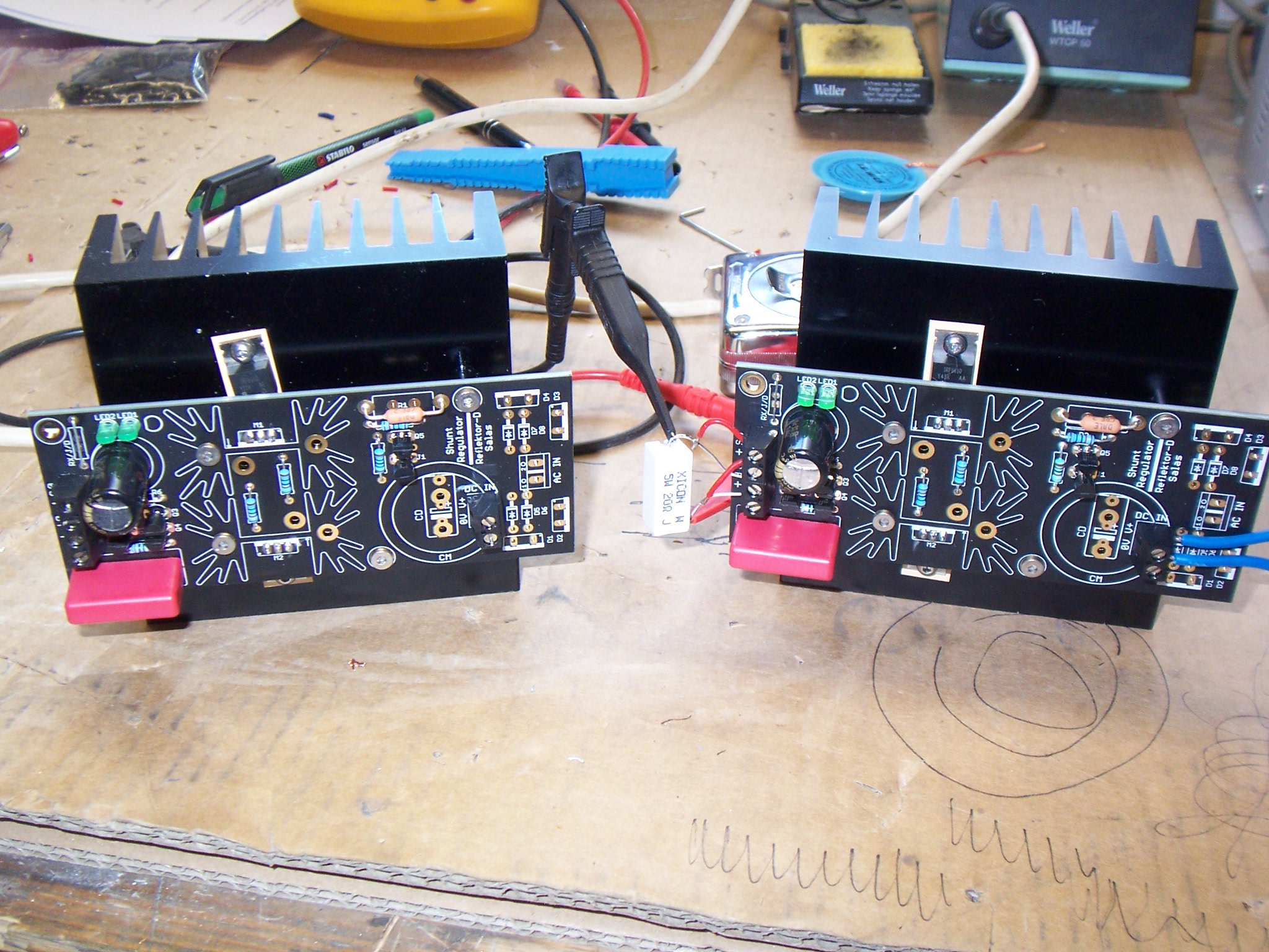

Just finished two reflector builds for a shiga2 build.
Rectifiers and smoothing caps will be offboard in seperate psu box.
Nice and stable voltage, perhaps a bit to high one at 5.07V and one at 5.1V, but i'll ajust to get it spot on.
got bigger hearsinks for better distribution of the heat inside case, barely gets warm to the touch @700mA.
Waiting for my rcore trannies (selectronics) and let the fun begin.
Very easy to build, about 1,5 hour each, heatsink beiing most of the work.
Thank you Salas!!

Salas
well my pin reversing works, you see something wrong with it?, if not i was the first to do it like that. If it is the wrong way, its not my idea.
Do you have a sugestion wat to put there perhaps?
Raw dc will be 2200uF regulator 1000uF, standard shiga ps.
Regards
John
Its a nice way to reverse pins with underside connection so to keep cabling very short. Well done.
CD (decoupling capacitor) can be 100nF MKP. Its for the incoming DC wiring inductance not to trouble the CCS. Use the little holes. 5mm pitch or 15mm pitch from 0V to the other two (which are commonly connected to +Vin).
Vout drift down can be less mV than with board level small sinks. Wait for half an hour warming before judging the Vout you want to adjust anyway. If the application has a Vcc value tolerance, as they normally do, don't bother for 0.05 or 0.1V differences to nominal. Unless its fun to nail it.

The shiga2 black boards supposed to be very critical when it comes to the right V in, they also have to pretty close, ill try to nail it a bit beter.

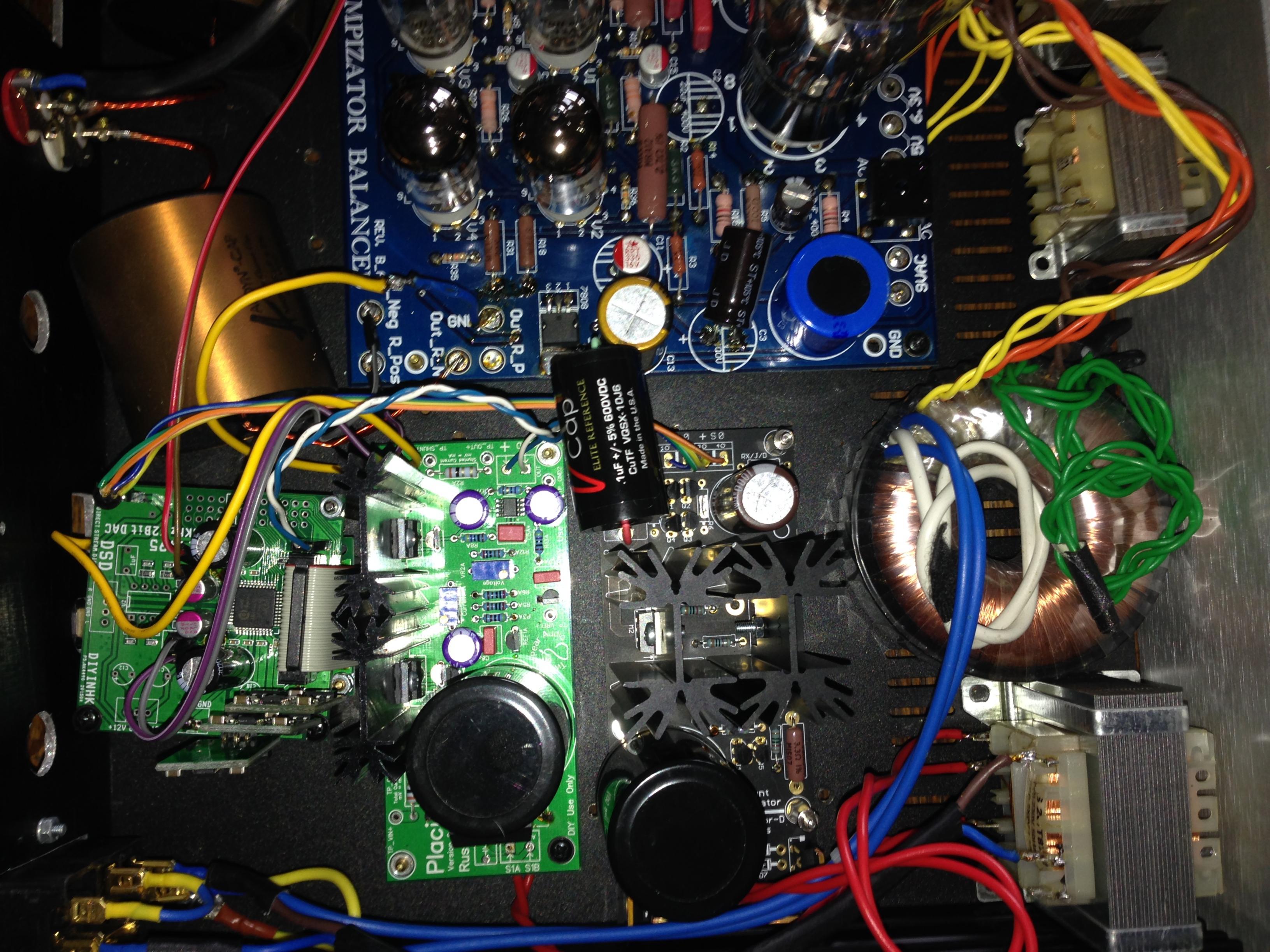

I just put 0,1uF CuTF V-CAP (teflon) for C1. OMFG!
Another proof of how important is power supply to analog dac section of your dac chip and another proof that your audio signal is mainly as good as the power its created from. Another part that brings Salas Reflector D to another level. Thanks Salas!
It replaced already good 0,1uF ClarityCap MR that I had in my build.
It is not even burned in well yet but if I were to describe impact on sound it would be: more liquid, wider bandwidth (especially heights), bass is more firm. It is just better in every aspect: transparency, clarity, musicality. Now it seems like notes sound/last longer, more natural/organic.
Now my question is:
The cap has to leads red and green. The green lead indicates the outermost foil and as documentation states: it should be connected to the lowest impedance path to ground.
Now in my build I connected green lead to F+ and red one to R5 resistor. Is that correct according to documentation? or it should be connected the other way round?
Please let me know your opinion. Thanks.

The Reflektor-D has no output capacitor storage. All there is to it is that little values RC termination Zobel (R5-C1). Ground side is F0 of course. C1 is connected between R5 and F0 in the manual's schematic.
