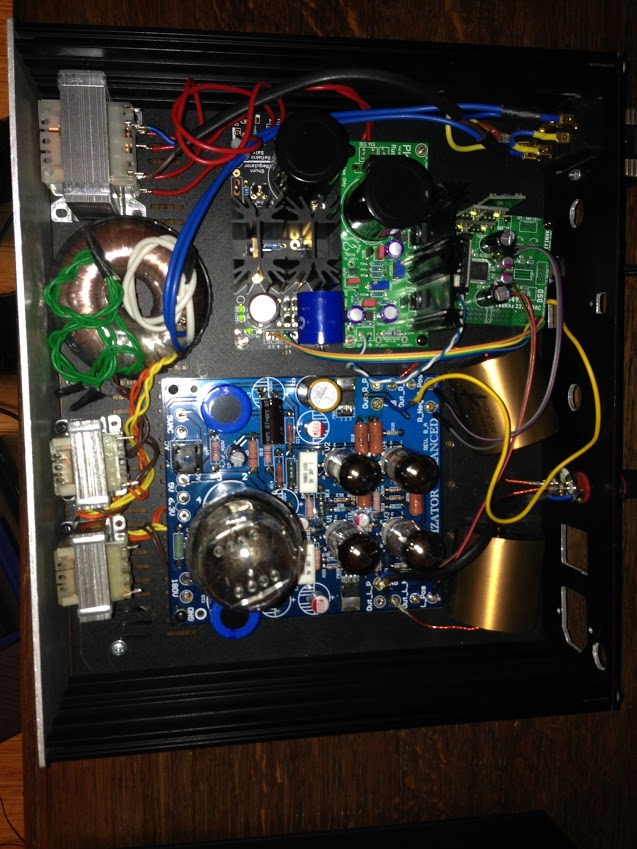

So here is my build (still work in progress):
Isolated xmos usb + ak4495 + salas reflector D (7V) powering analog left/right + placid hd 2.1 shunts + 3xTridents 3.3V (DVDD, AVDD, clocks) + lampizator Balanced SE output stage.
Previously Placid hd 2.1 was powering analog left/right 5.25V and those three local shunts
With Placid HD 2.1 it was very good, however with Salas it is damn very good, sound is more clean and stiff. It is not day/night difference, however some differences are easily noticeable right away after application:
- better transparency and blacker background
- wider bandwidth, especially highs are now more "real" and bass goes lower
- micro details are easier to pick and hear
It is not direct comparison because:
Placid HD 2.1 was 5.25V whereas Salas is 7V and ak4495 works better with higher voltages. It accepts 4.75V to 7.2V.
Placid HD 2.1 was powering analog section and whose three Trident Shunts, so some noise from shunts could be carried into analog section. Whereas Salas is powering just analog section of the dac.
Salas was build with some high quality components: Var resistors, Clarity Cap MR 0.1uF. My Placid HD 2.1 still uses trimmers for voltage and current adjustment (that could be replaced with fixed values resistors)

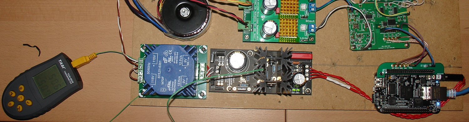

Hi! I built a Reflektor for my breaglebone black that is serving music to my dac in the same chassis ("chassis" being used liberally to describe an mdf board... 😱).
Before using the Reflektor I powered the bbb with a 2A/5vdc smps so I could get and idea of the current draw using the music I usually play. At turn on it draws a bit over 400mA. After it stabilizes and plays the average seems to be about 350mA, with the max recorded for a two hour listening session being 410mA.
I built the Reflektor with a 1R Caddock MP930, thinking that it could draw close to 500mA, but it fell a bit short. Should I leave it as is or try to get a 1.2R instead of the 1R? I ask because the heatsinks during this two hour period stabilized at 50-51 degrees F (max was 50.7dF). It's using a 9v trafo. I live in Florida so summer is long and hot and the thing is not yet inside a case...
My second question is regarding the startup. When I hit the on button, sometimes the bbb does not start! The leds are on in the Reflektor board, but the bbb does not boot (no lights come on, as if it had no power). When I was testing the setup with smps it always started. Pulling the bbb's 5vdc plug in/out makes it start. From the measurements above it doesn't seem to drawing, even for a brief moment at startup, anywheres near the max current, so I'm not sure why this is so.
Thanks in advance.
