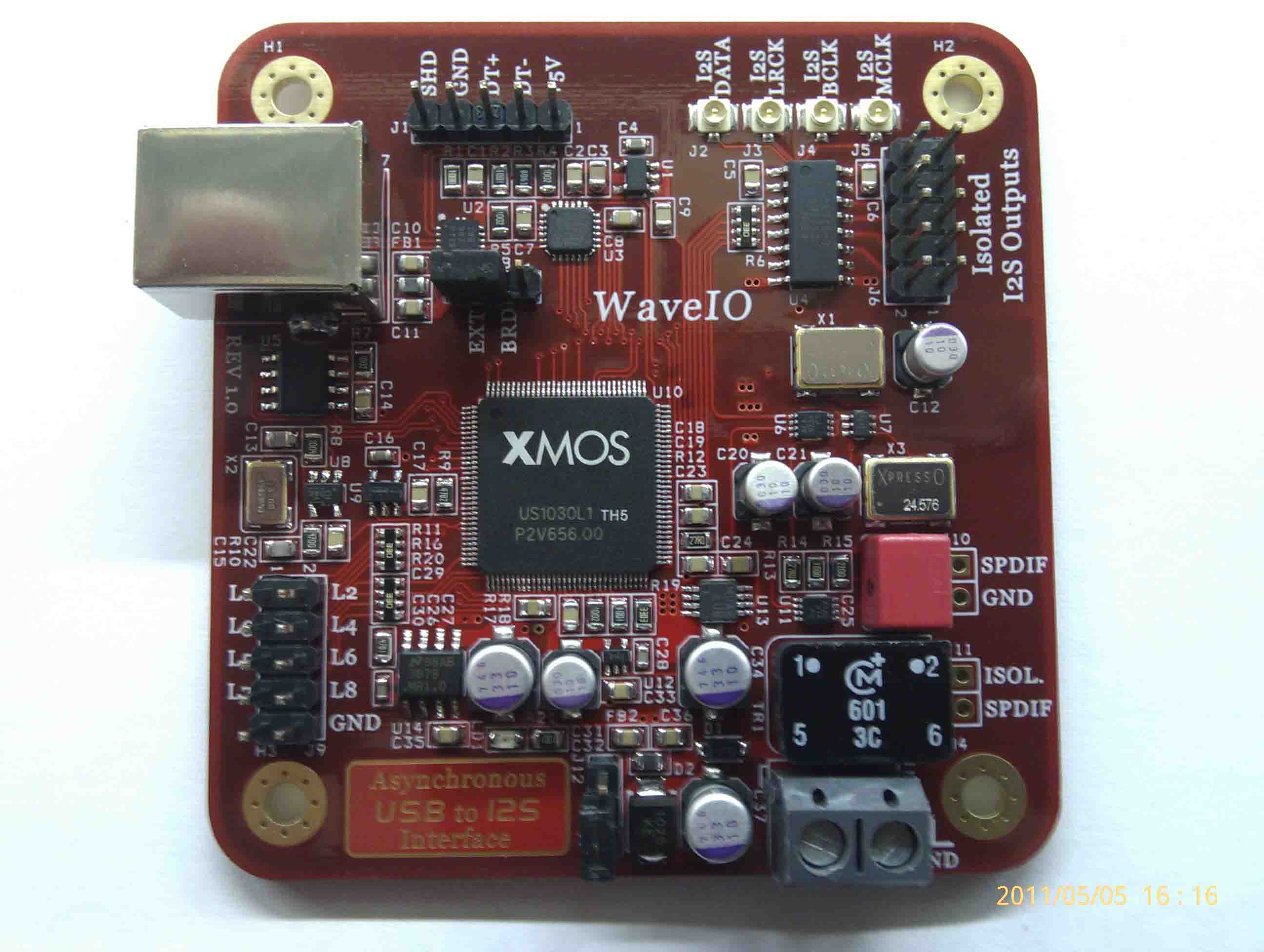

You might be interested in a listening test done by audiodesign.
WaveIO came out pretty well.
http://www.diyaudio.com/forums/digi...2s-m2tech-vs-xmos-vs-open-source-qnktc-4.html
thanks Oliver & wlowes!
I'll check the test later tomorrow along with reading all this thread 🙂
Took a glance at all pages of Amanero discussion but didn't find any mentioning of buffered output signal. The web also says nothing about it, so perhaps I need this UHS-Buffer module.
You are welcome. I forgot to mention that I use WaveIO with a TDA1541A DAC. It is not Oliver's, but it has some similar attributes. The sound is stunning with WaveIO.

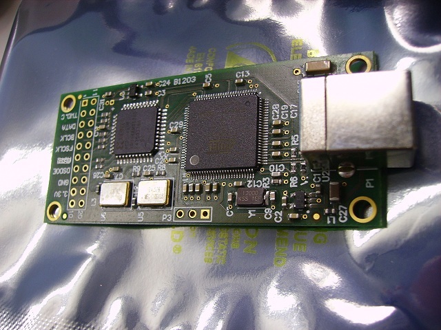

I am currently implementing the Amanero board with The Red Baron DAC build.
I will report back when complete and "burned in". I am using the UHS buffer and it works very well in this application.

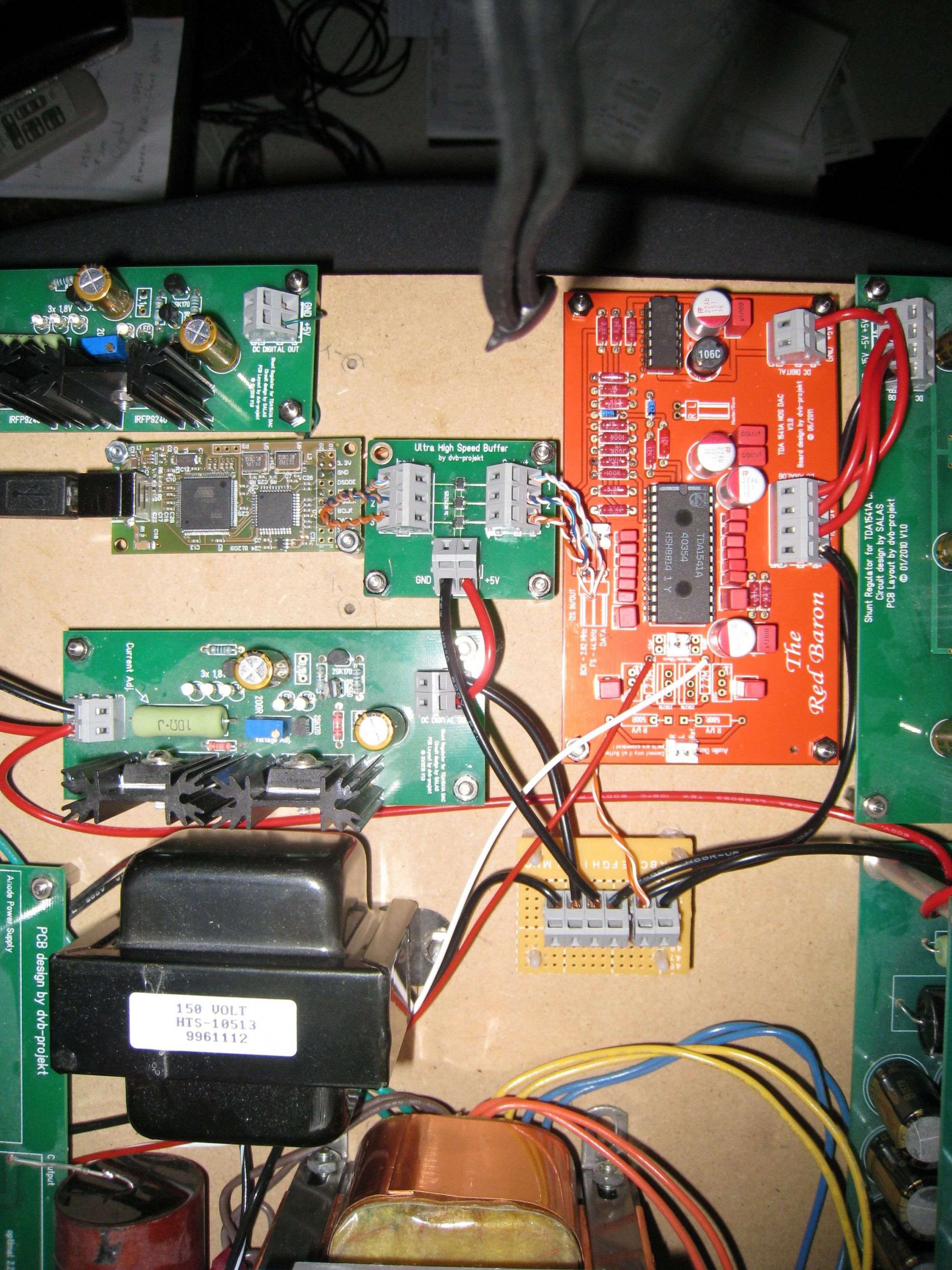

Thanks qusp. I took your advice and made the "adjustments" on the I2S signal/ground you recommended. MAJOR improvement. I had to alter The Red Baron DAC board (drilled a hole to access the I2S inputs and grounds from underneath). The bass is back, midrange richness is there as well.

Check my post (#867). This will give you some very helpful I2S background info (with the link).
I basically drilled through The red Baron dac board after wrapping the I2S (signal) wires with ground wires.
I'll post a pic soon.....
Looks good! Where do the orange/white wires from your star ground point lead to that are going under the dac?
How quiet is it? Any hum or hiss at full volume?
The orange/white wires are the ones that run to the grounds on the small Wima caps.
I've got a "wee bit" of hiss. That will be corrected with a USB isolator....
Still correcting grounding issues...
Question for the followers of this fine hobby (obsession)....
What is the preferred method for star grounding? I thought I had it correct, and I'm still getting this weird intermittent hum...
I'm powering my USB to I2S converter with Oliver's (Salas) 3.3V shunt. I lowered the current limiting resistor to 10R to get more current. The problem lies in the fact that when there's no music playing there's almost no hum or hiss. When music is playing (on some songs/cd's) there is some hiss or static. Here's where it gets weird...when I touch the 3.3V board (or caps or heat sinks or anything else) the hiss and static gets much louder.
All component boards rest on a wood board. Comments?

if the wood is even remotely moist it can carry hum to a part of the circuit which is most susceptible to it.
could also be close proximity to the transformers that is causing it
