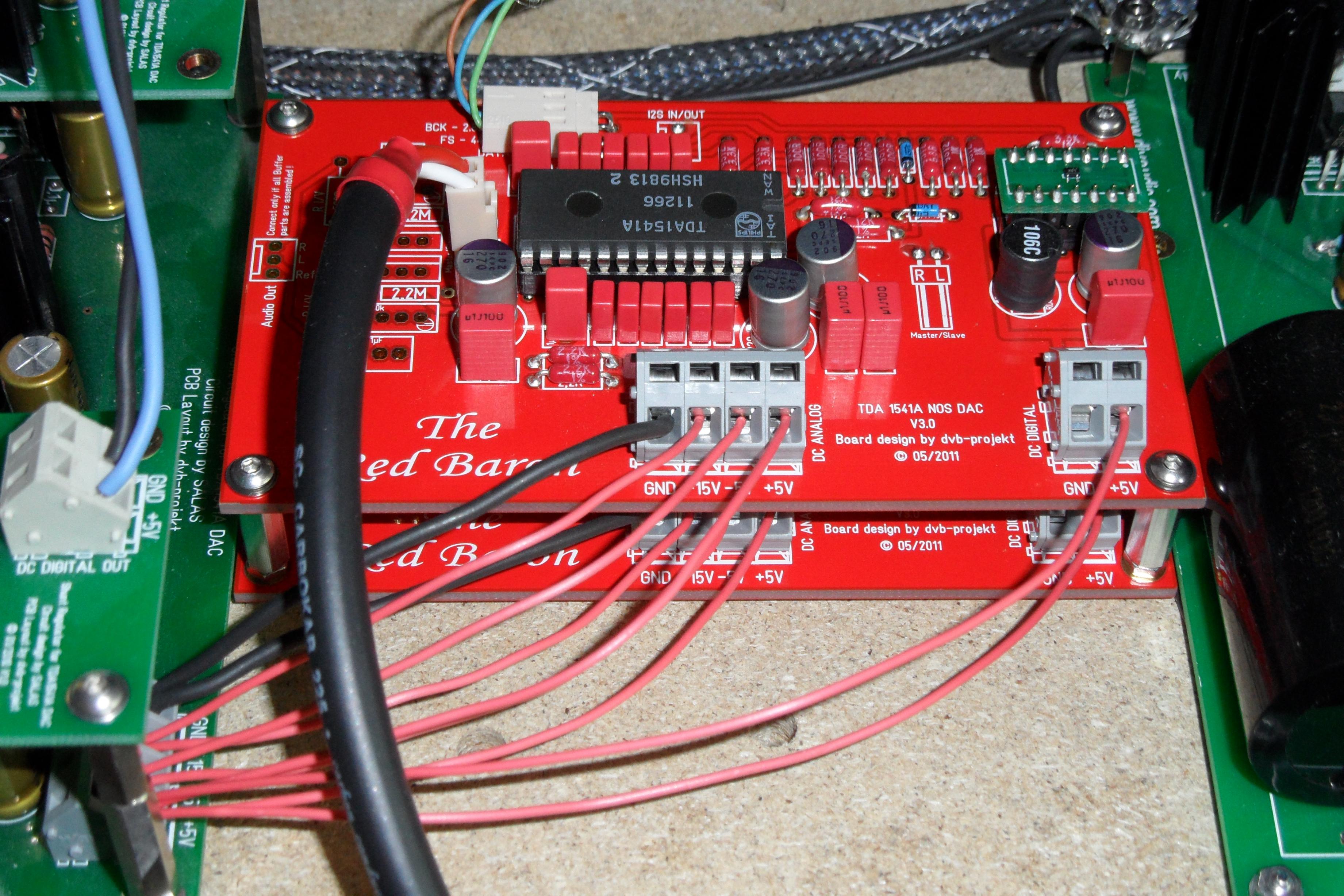

Hi everyone.
I'm finishing up the Red Baron dac board. I'm already running the Tube-I-zator (latest version and the 1st generation dac board).
I'm not installing the MOSFET Buffer I/V stage parts, and I see from the pictures that the signal out is then taken from the (L/R) Master/Slave output next to the TDA1541A dac chip on the Red Baron board. Doesn't this need a ref (or ground) as well , or am I not seeing something?
Could it be that the REF is taken from under the Red Baron board to the Tube-I-zator?
Thanks,
Chris
Hi everyone.
Thanks,
Chris
Hi Chris,
look here to my grounding scheme:
If you connect it like this with a star GND, you could use the GND of the Tube-i-Zator for the RCA-GND connction.
I hope this answer your question.

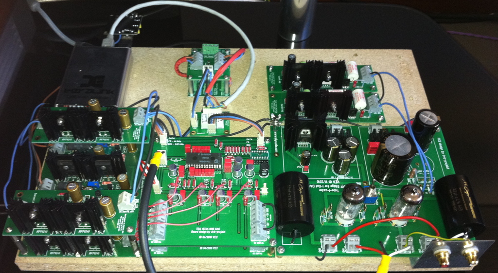

Hi Oliver
Looks like your DAC didnt have any change now
this is the perfect time to start solder
BTW i just have Tubeizator, DAC, shunt & hv (no need supply pcb)
what is the other pcb i need to complete this ?
(i saw a little pcb in the middle of your big picture)
btw BOM this DAC can not see again (look blur) in this thread
maybe you need to attach them
Best regards

Hi Pocoyo,
the small pcb above the DAC V2.3 is the I2S switch (USB/SPDIF).
All BOM´s you will find in my blog HERE.
:wave:

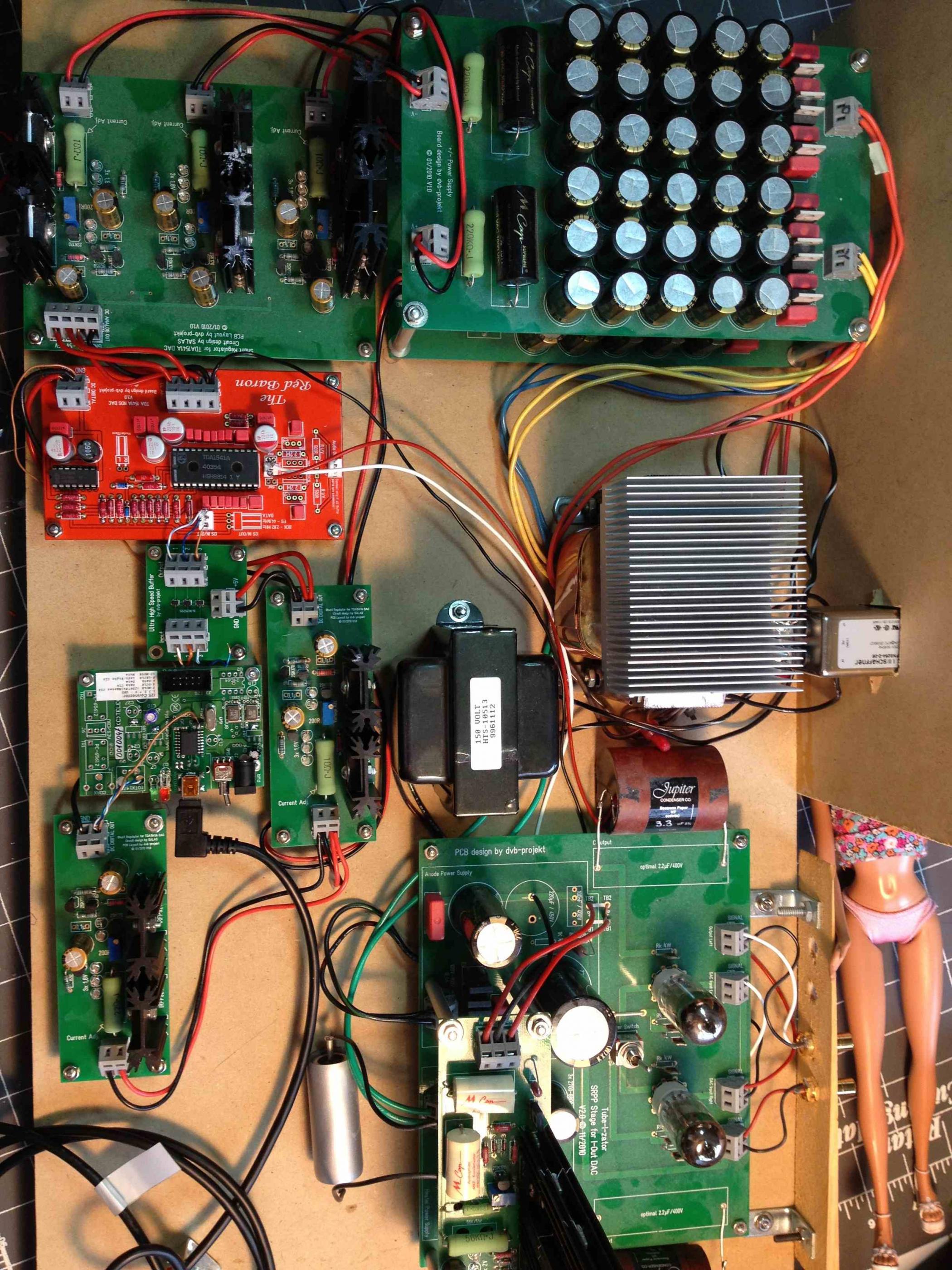

Help needed.....
Hello everyone.
I've owned this DAC for a long time and enjoy it very much...thanks Oliver! I've also recently added The Red Baron board...even better. I utilize the Teralink X2 (no clock mods - I can't microsolder, but I did do the 5V and 3.3V shunt mods)
My original build is posted #571.
The "digital landscape" is changing rapidly and I'm starting to try new/different USB to I2S converters. I recently purchased this one in I2S output:
http://www.diyaudio.com/forums/digi...nous-usb-i2s-spdif-converter-24bit-96khz.html
My problem is that the output is faint music covered with a veil of static and hiss. The creator of the board has been extremely responsive and helpful, but he doesn't understand the dac chip like the folks here. I know there are no problems with the DAC board, as I reconnected the X2 and everything was back to normal. You can't see the I2S connections, as they're under the board, but I've rechecked multiple times and they're correct. I think I'm missing something silly here.....
Input welcome....
I'm attaching a picture of the build (and yes, that's a Barbie...long story)
Hi Crobinns5421,
How was the sound before the Red Baron? Any noise at full volume with no music playing? The reason I ask is, I too upgraded to the Red Baron, and now I
have some sort of ground loop making the unit inoperable. I'm in the process of trying to quite this thing down.😡
Where is your star ground point? I don't see it in the picture.
Ned
Oliver (and everyone),
I looked at your system picture, but I couldn"t tell where you had the following grounded:
1. 5V High Speed Buffer
2. USB Isolator
3. Digital Power on Red Baron
4.USB to I2S Converter
Thanks!
Hi Chris,
1. High Speed Buffer GND to +5V Shunt GND
2. USB Isolator GND to +5V Shunt GND
3. You could use only one (Analog/Digital) GND of the Red Baron, because they are star grounded on the pcb. Connect the GND to the TDA1541A Shunt GND. (see attached photo)
4. USB to I2S Converter GND to +5V Shunt GND
I hope this helps! BTW, i will dispatch your two ordered add. UHS-Buffer tomorrow.
:wave:
