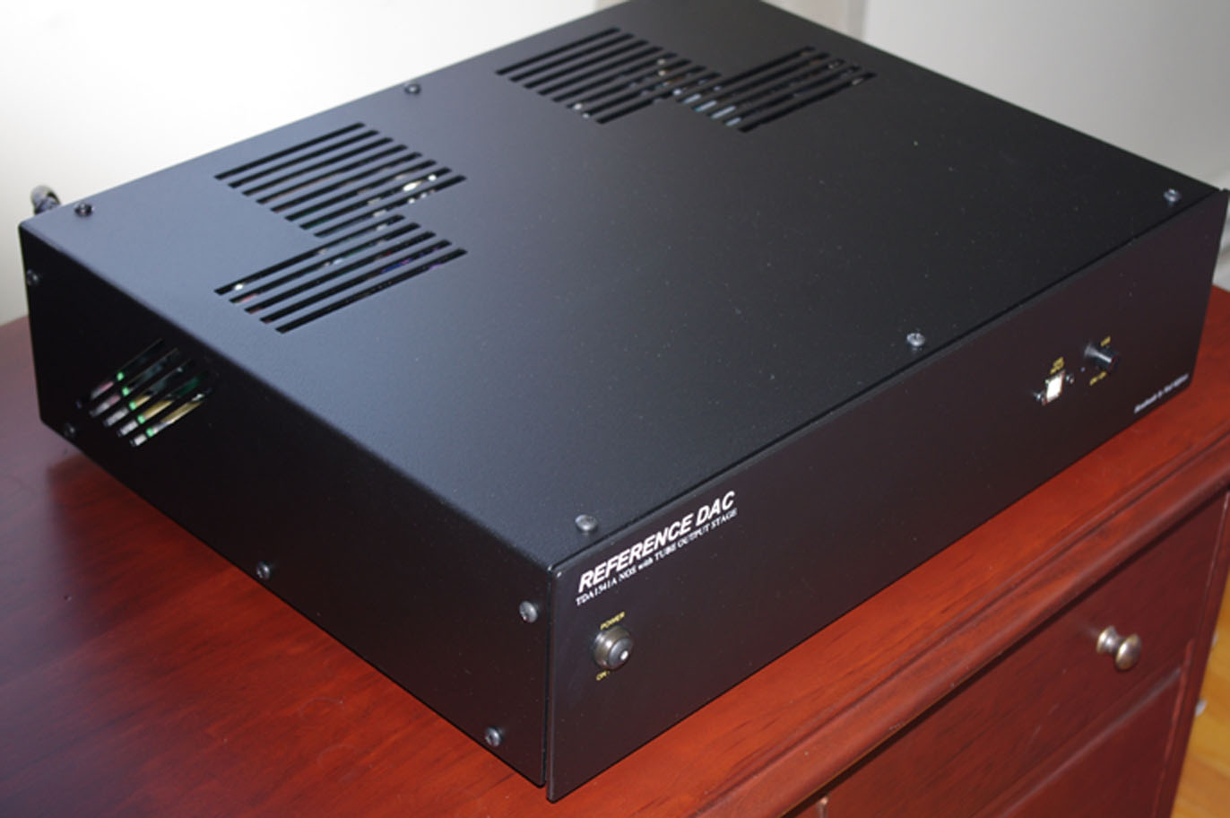

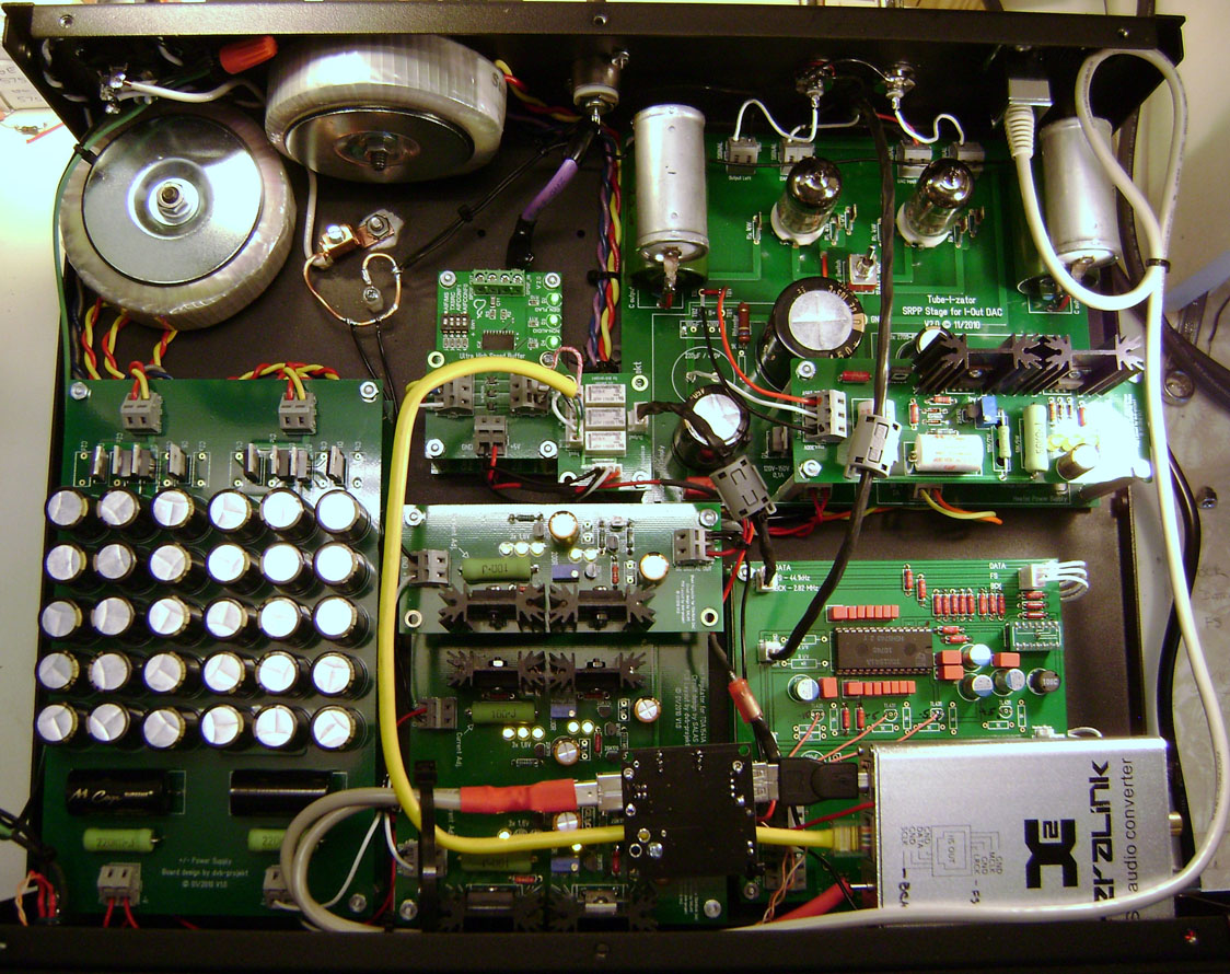

Well after many months of planning and building I've finally finished, and I must say it sounds absolutely stunning. This is the closest I've come to reproducing the sound of quality vinyl.
I couldn't have done it without the help of you Oliver, you're the best!:worship:
There is one problem I'm having. When the unit is sitting idle, and the preamp is turned up to full volume, there is a fairly loud hum/hiss. This is not normal for my system, it is normally dead quite.
If anyone can give me suggestions of how to eliminate this noise I would appreciate it.
I will be posting some finished photo's very soon. I tried earlier, but I encountered an upload problem.
:cheers:
Ned

Did you check for 0DC offset on the output ?
Hi Regal,
Look's like that's probably my problem. I thought I checked it, but I guess I didn't.
With the unit connected to a cd transport, from a cold start, I get 12vdc. As it warms up it gradually settles down to a varying 275-300mv, both channels the same, and it's not steady. The voltage constantly climbs and drops.
I'm using Russian K75-10's bypassed with FT-3's for the output caps, when I put my finger on the outer case the hum gets very loud.
I tried uploading photo's again, but it still won't let me.
Two things,
I figured that the mk7 design isn't really correct as far as allowing DC coupling. Sounds like you are using output caps which is good, but configuring the correctoutput signal ground needs some re-work, I just ordered my PCB so probably not much help but.
Your caps can't be having 275-300mV DC on the output of the cap, my guess is you are using the wrong ground for the output. Check it against a true ground (I would use your preamp rca input signal ground as a self check)
The other thing when you have got truly 0VDC on your output you may still find you need to grind some paint off the russian caps, many of us have found the these caps need to have their cases anchored (solder a wire from the case of the cap to star ground.)

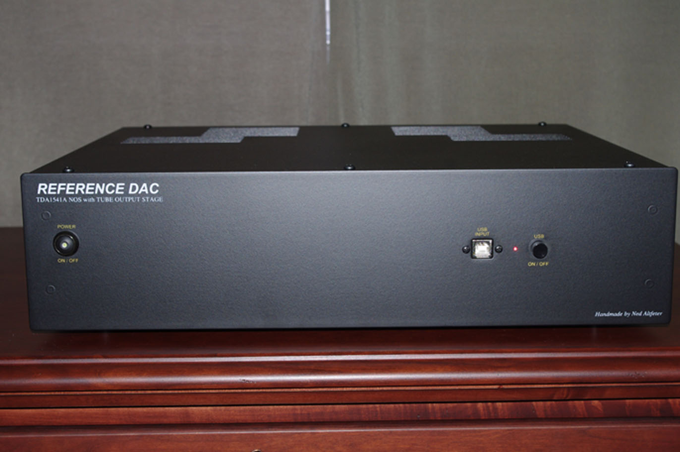

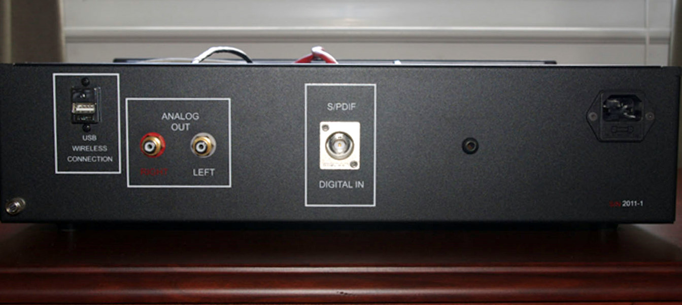

Here She is!
