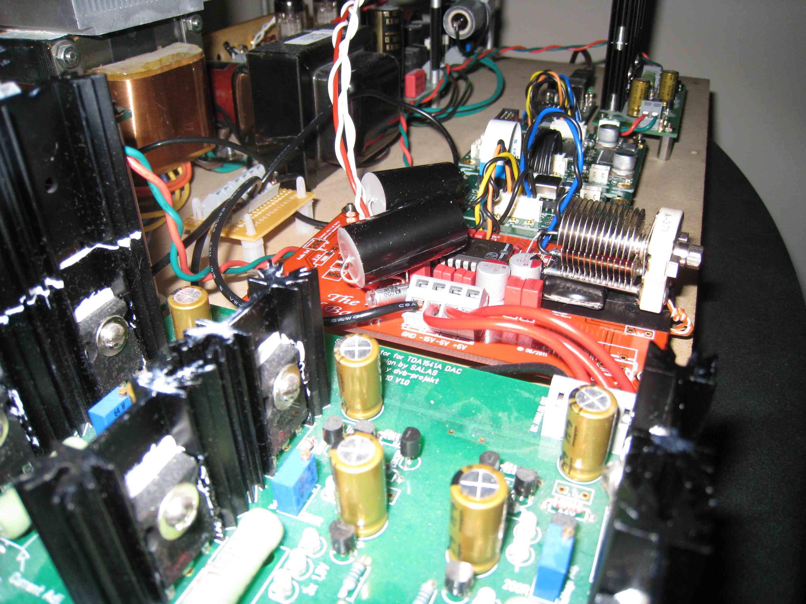

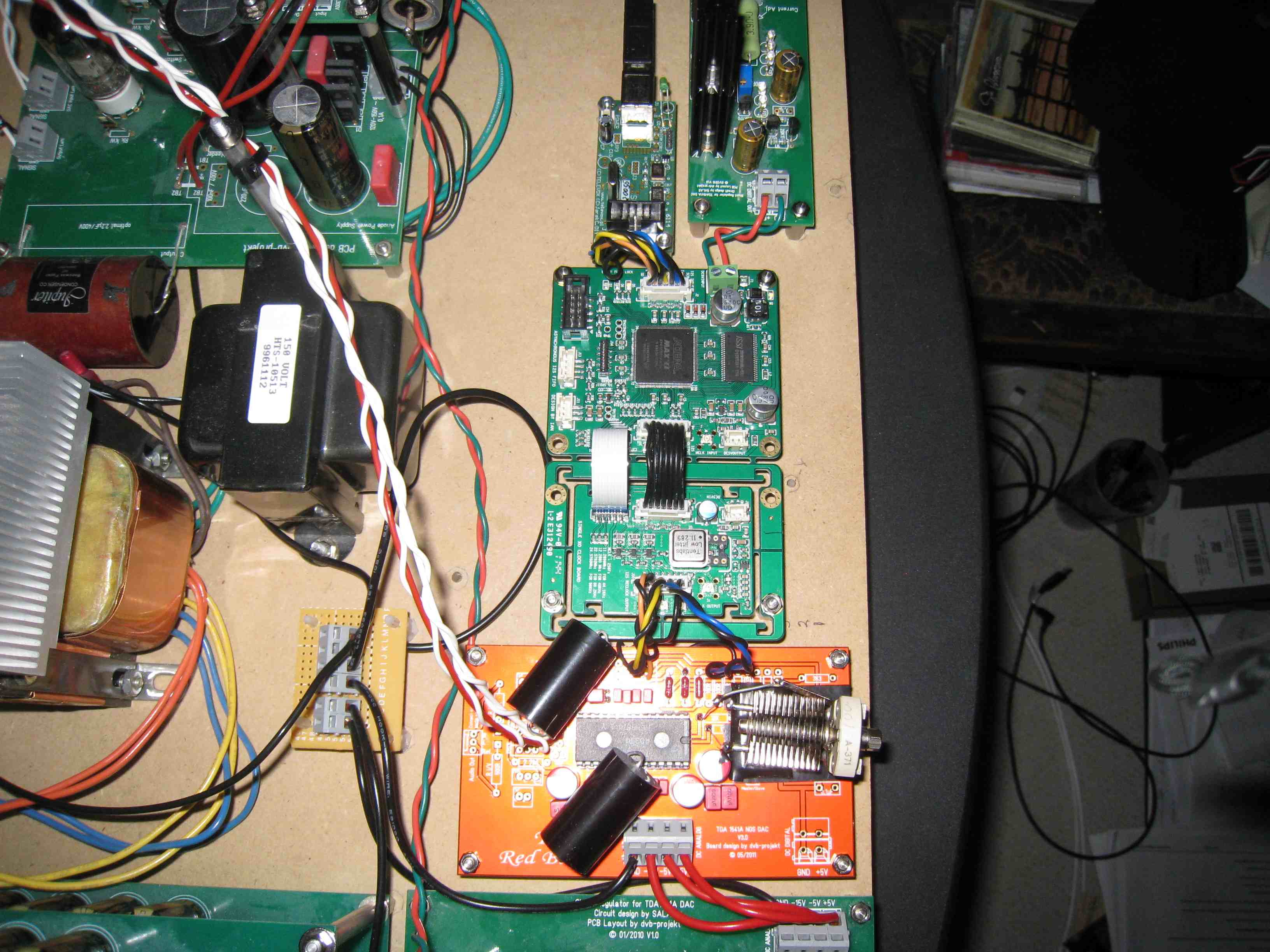

Red Baron with Ian FIFO
I (finally) finished the integration of the Ian FIFO with The Red Baron. Build notes are in my last post. FWIW...
1. Lock frequency is ~88K
2. Salas 5V shunt modded to ~6V (500mA) - Thanks Oliver and Salas.
3. Decoupling caps - 3.9 uF Solen (Thanks James) on MSB pins. 1 uf WIMA on the next two pins (other 1 uF underneath). Following 4 caps are .22 uF WIMA.
4. Air cap is BARELY engaged. Used -40 dB music to fine tune.
5. 6.8K resistors under the board
6. Ian FIFO works flawlessly - Bravo!
7. USB to I2S converter from JarekC. 16 bit data/16 bit frame. Very easy install. It's the second of JarekC's converters I've used.
Early listening has me speechless...its just so smooooth...with no detail loss. The two things that stick out are the bass improvement (weight and attack) and the upper ferquency range (clarinet and harmonica have no "etch")
I'll report back once this gets a few hundred hours on it.
