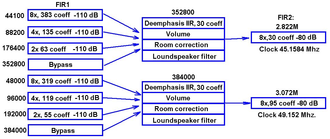

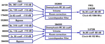

I expected a diagram of the DAC to better understand the operation but Soekris is very busy and has been explaining the DAC in numerous interventions. I have made a selection of this to understand. I made the diagram that I could understand about the initial design. The current limits without changing architecture are:
Up to 1016 tabs at 44.1K/48K input sample rate.
Up to 508 tabs max at 88.2K/96K input sample rate.
Up to 252 tabs max at 176.4K/192K input sample rate.
124 tabs at 352.8K/384K input sample rate, but normally bypassed.
FIR2 is operating at 2.822M/3.072M and can have up to 120 tabs.
To better understand the level of DAC DAM1021 I have to meet other products on the market that have been mentioned in this thread..
MSB has one pass filter at 16x (705.6 Khz.) with 3200 taps. Or 32x (1.4112 Mhz.) With 6000 taps. The filter have noise shaping. The accumulators have 80-bit. Not round the result before adding next sample, intermediate data is stored at 80 bit resolution. Finaly convert to 24 or 26 bits including ultrasonic dither and noise shaping to have in sonic frecuences more than 24 o 26 bit resolution.
Ayre has one pass filter at 26x (1,1466 Mhz.) with 64-bit accumulators.
Dam 1021 have 2 or 3 cascade filters 2 FIR and 1 IIR. (64x 2,822400 Mhz.) with 67 bit MAC accumulator. Unlike the rest of DAC allows to manufacture their own filters, perform low pass, bandpass, highpass for speakers, Room Correction. Very interesting for diy builders and experiments in the forum community.
