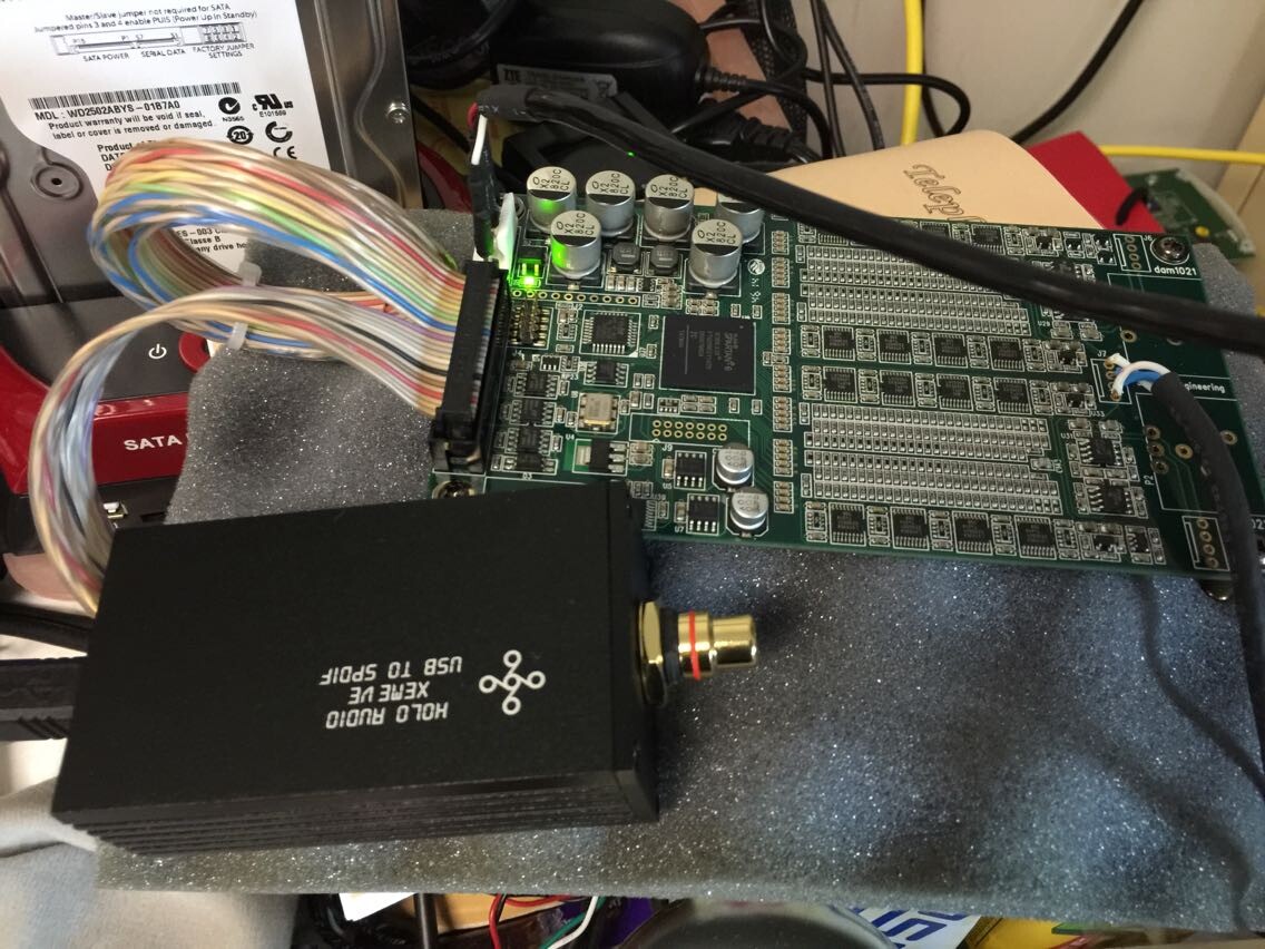

The popup noise at power on/off will be easy to solve with a small power on delay mute circuit at the ouput. I'll make one easily....
The popup noise is a problem mainly at power off.. I'm not sure that a relay would be fast enough to guarantee protection in that case.

So it is better to be safe than sorry. Simply switching on in a "wrong" sequence should not damage equipment. A muting relay shorting outputs to GND with a small value resistor in series will do. If it has a just big enough filter cap it will switch faster off than the DAC's power supply. No click, no damaged speakers, no risk. A simple circuit can be added on a separate PCB but it could be onboard in revision 2. In any case I would add a muting circuit as it costs considerably less than new speakers.

The dedicated AES/EBU input seems to have vanished somewhere between initial announcement and implementation. Unless one of the mystery headers has additional inputs Søren is keeping up his sleeve.
You could use the differential input for SPDIF but due to the higher signalling level you would really need to do level conversion to bring the potential AES/EBU 2-7V p-p voltage down to 0.5V p-p.

I have an AudioNote AES/EBU transformer myself, and hope to get it implemented. I am pretty sure how to position the transformer, with 2 pairs going to the input side (XLR Connectors) with the other pair going to the board, assumedly connecting to the SPDIF (+) and (-). The question is what level of loading resistor is used. I am thinking the 1.2v bias loading will remain the same. Perhaps the 300ohm loading resistor is the same even, but I doubt it.
On the audionote page referenced in the OP of the other thread there is a diagram of how to set it up (for the AN DAC board that is). As mentioned above, there are SPDIF definitions, but I don't know the specifics of how the Soakris board requires SPDIF setup.
