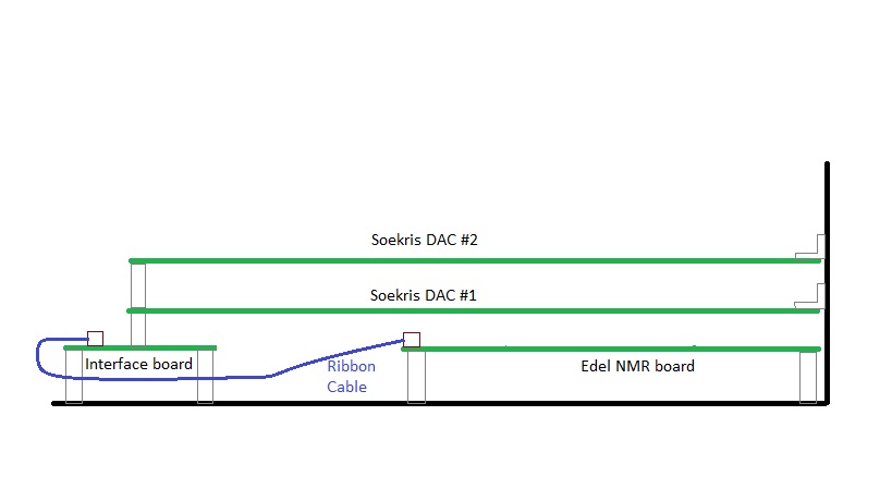

I plan to purchase a Soekris DAC (or two) shortly and have started to work out my implementation. The DAC will be used within a network renderer, using as the I2S source either an Edel NMR or a Beaglebone Black running the miero Botic Linux distribution, so no interest in Toslink or SPDIF.
In addition, I want to make use of J2 for power input (as per HiFiduino) to bypass the bridge rectifier with screw down terminal blocks for connections.
I'm also interested in the possibilities of using two DACs with crossover filters.

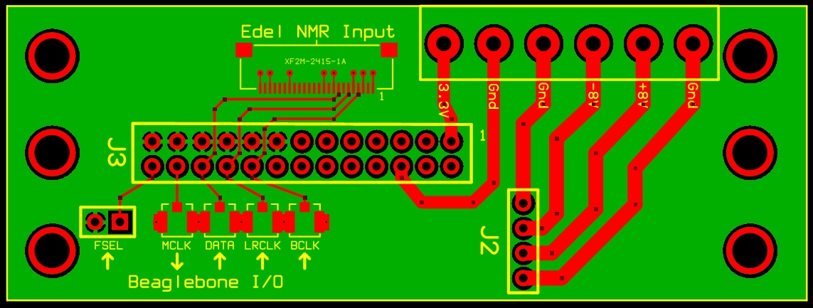

I've designed my own little interface board to get I2S and power to the DAC(s). It is designed to stack onto the DAC board headers. The attached diagrams show the board and how I am thinking of using it. Thanks to Enrico for his help.
Unfortunately I haven't seen any information on the coordinates of J2 and J3 on the Soekris board so I have placed them by fitting a copy of the mechanical drawing on the hifiduino page to an outline of the DAC board. Hopefully I'll be able to refine placement if necessary.
I'll probably get a small batch of boards made so if anyone is interested....
Ray

Ray, it looks nice - but didn't Sören say to not power the boards through the J2 connector?
I didn't see Soren say not to use J2 but having just quickly checked the hifiduino site I see the information has disappeared so it looks like you might be correct. I wonder why you can't use J2?
Should be easy enough to route the power to a J1 header if necessary. Would be good to have a full mechanical drawing so I can position the header correctly.
Ray

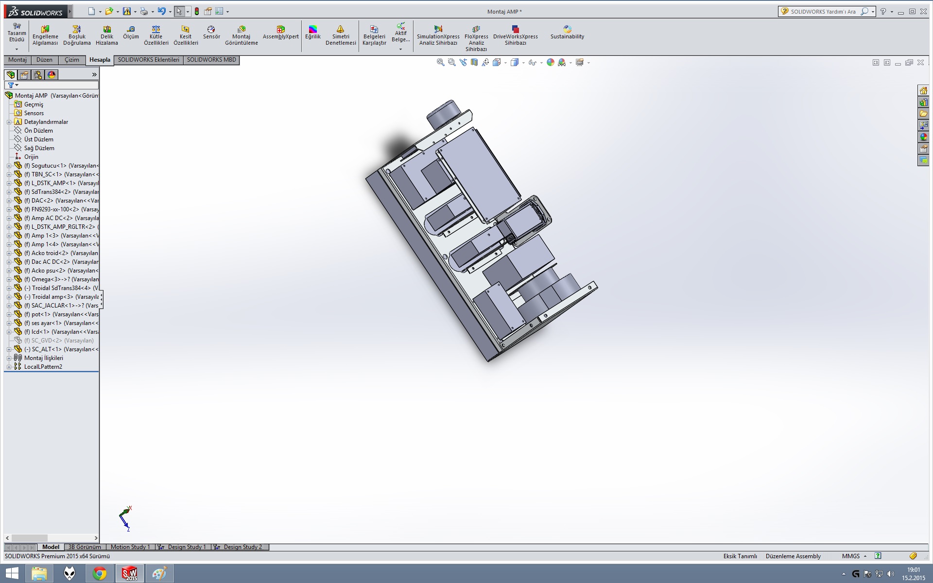

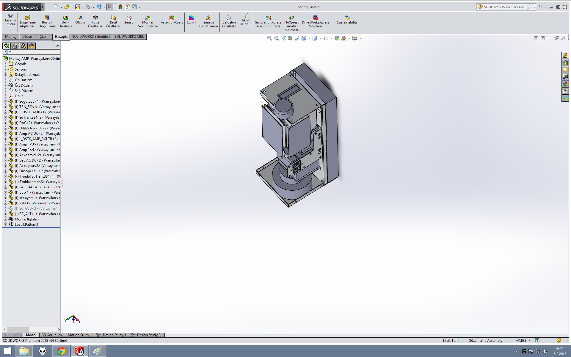

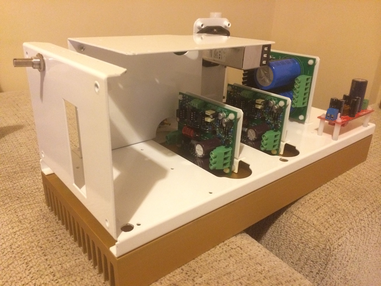

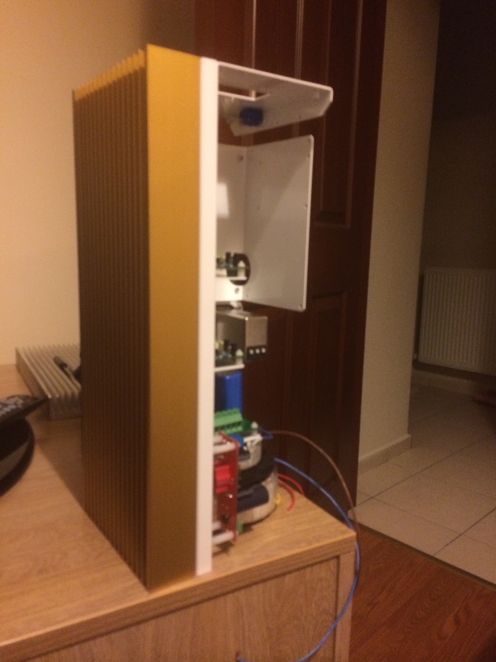

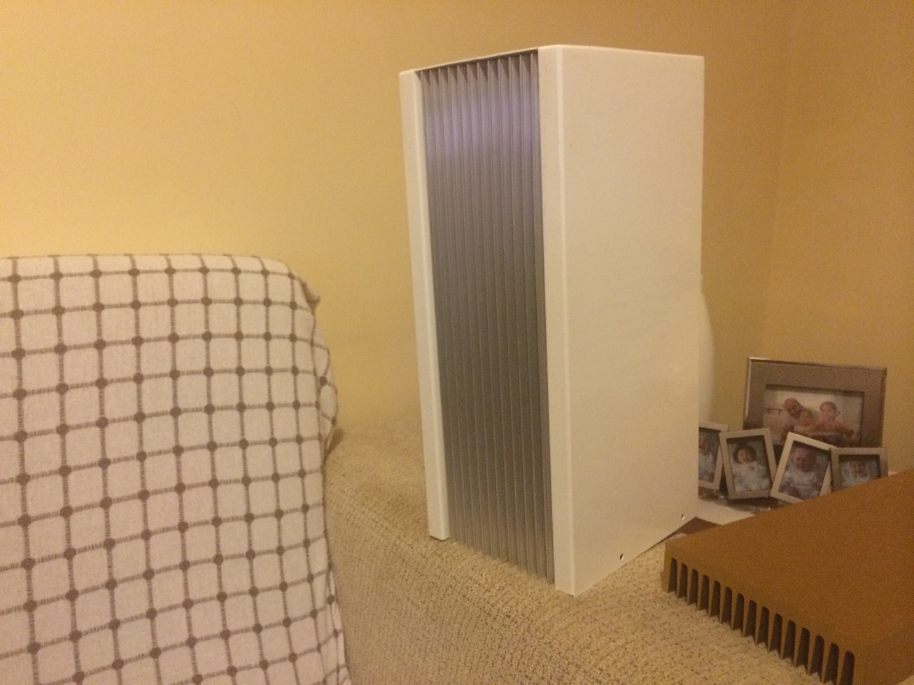

Almost nobody send build pictures, they are so important less experienced builders like me.
Here is my setup;
SDTrans384 (Not arrived yet)
Acko regulated power supply for sdtrans384 (i will seperatelly power the board with 1.2v 3.3v and 2.5v(Not arrived yet) i also planing to use 3.3v to power up i2s on Soren R-2R.
diyinhk 5v regulator for sdtrans384
Soren R-2R
Neurochrome Modulus-86 stereo amplifier and supply board.
Do not know which cables types to use yet.
Almost every hifi design is horizontal so i decided to build a vertical one.
I am working in a case manufacturer so my mechanical capabilities almost limitless 🙂
Whole body made from 1.5mm aluminum.
i like gold colour so i made gold like eloksal coating on aluminum heatsink it will be a good buddy with white body. Some of the componenets are so close eachother but it is just a prototype, i can totally change the design according to your welcome comments.

I Repeat:
I can only recommend to supply any power on J1, the diode bridge used on the input is a low noise schottky type.
J2 is NOT for supplying power, it's for testing or for sourcing small amount of power for external input circuits. Applying power will probably blow the board.
If you insist to improve the onboard power supply, try replacing the 6 electrolytic capacitors with aluminum polymer types, 1000u 16V exist in same 10mm smd footprint and t.ex. digikey stock them at $2.20 each. Should be easy to replace.
You can also add a small polymer electrolyt on the 3.3V output, but please note that the clock oscillator power already have a filter, so I doubt it will make any difference.
But on the other hand, just go ahead, I'll be happy to sell you a couple of new boards 🙂
