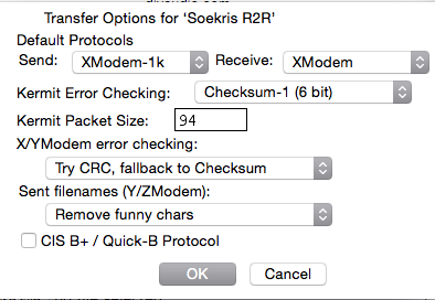

I've attached the settings I use. I'd only use local echo to get started - it makes a mess when you get into uManager.
If you set Xmodem-1K as the default in Transfer Options you can use command-S to start a file transfer, rather than having to navigate to sub menus.

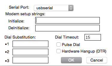

OK, I've deleted my ZTerm prefs so I'm back to a default state.
The "ATE1 V1^M" is the default modem config.
Go to Settings > Modem Preferences delete everything in the Initialize field, and delete the Dial Substitution strings for good measure. The dial time out can be left, but everything else should be empty as per attached screen shot.

Thank you very much for the detailed and helpful answer. So I deleted everything in the modem preferences and the ATE V1 is gone, but still, no response from the dam1021.
Triple checked the connections (txd to rxd and vice versa), I use a short cable and a logilink usb serial converter with the PL2301TA chip.The driver loads with no problems.

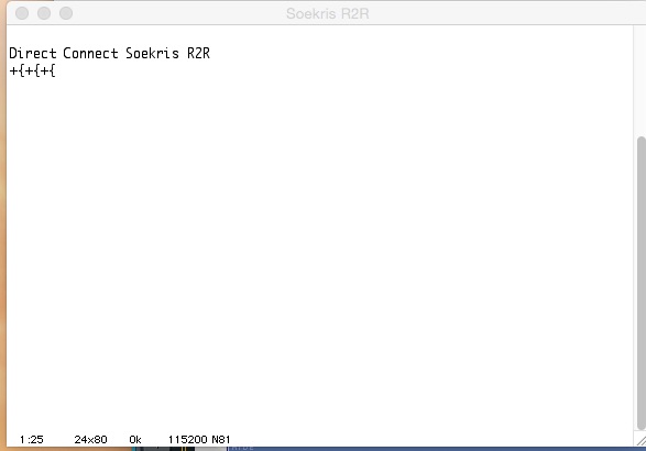

I also tried to access the dam with the terminal screen program with no success.
the attachment shows where I get with typing +++... no sign of the dam1021 :-(
I tend to think it is some kind of hardware problem...

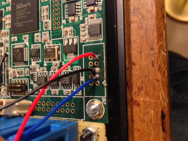

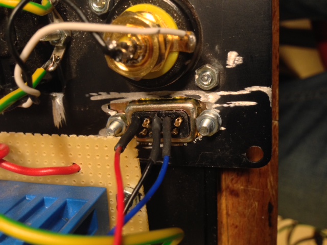

Hi Soeren
Here are three pictures of my connections. txd and rxd are crossed in the cable already, I did not assume that first (I am a total noob with serial connections, never before used one) So I crossed them at the Dam connection but then I did not get a response at all, so I measured the cable and voila, pin 2 and 3 are crossed already and I rectified my cabling accordingly.
I fear I could have damaged something on the board while I have misconnected the cables.
Now I have a response, but it takes the board at least a minute after power cycle to connect to the terminal program and then I still see no uManager, just that curly bracket after the +.
I am obviously stuck, maybe I should try a different usb serial adapter.

Looks like you aren't using crossover wiring. Swap black and blue cables at one of the ends so that it's connected TX/RX and RX/TX.

Yes, but that is already happening in my serial cable, it is wired pin2 - pin 3.

The dam1021 serial port is wired like a PC's serial port and should be connected to a male dsub9 connector. You would normally need a female to female crossover cable to connect to a PC, or USB adapter emulating a PC serial port. The wiring on your pictures look correct.
Normally, if your USB adapter have a female dsub9 you can plug it directly into a male dsub9, if it have a male dsub9 you need a female to female crossover cable.
It's also important that any terminal program is just in simple terminal mode, no modem mode where it t.ex. might be waiting for dialup.... Again, if using a PC I recommend HyperTerminal.
RS-232 signals are short circuit protected, so I wouldn't expect anything to be damaged.
