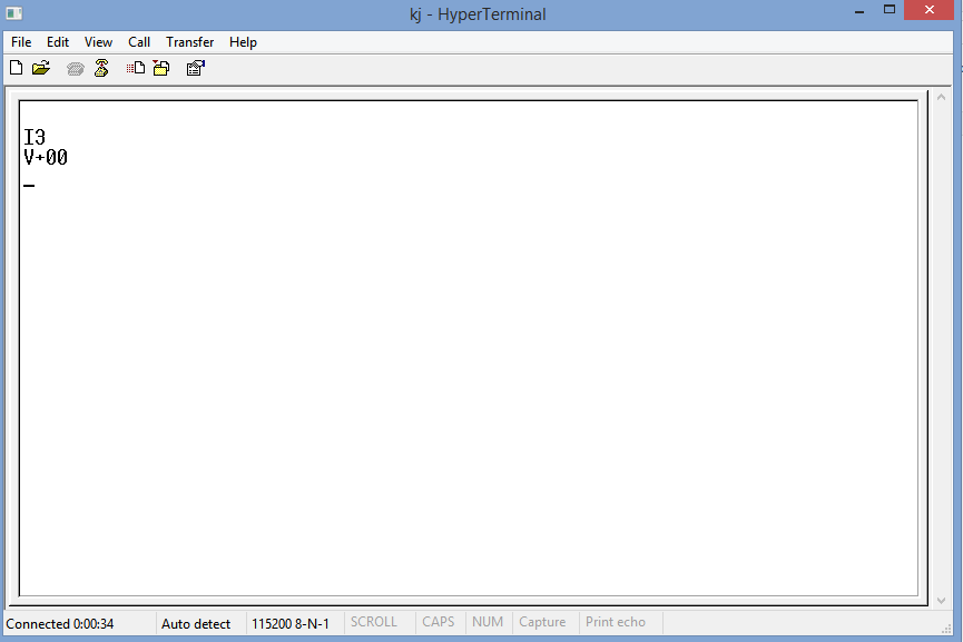

Maybe getting a bit closer connecting to the umanager.
New usb-serial interface. Short cable.
Stops here. Unable to type anything. But there is a connection.
Powercycle and the same happens.

No access to the uManger
When I open Z term I see: ATE1 V1) so it seems to see the Dam1021, but when I type +++ nothing happens, what else can I try?
Thanks for help.
Tobias
Hi I am on a Mac also and followed your advice, but I just do not see the uManager.For ZTerm:
Go to Dial > Directory
Click "New"
Create a config with name "Soekris R2R", Data Rate "115200", Data Bits "8", Parity "None", Stop Bits "1" Flow control options all deselected. Select Local Echo if you want to see what you've typed.
Click "OK"
Got to File > Transfer Convert and select "Binary Data" - the default "Smart MacBinary" corrupts transfers.
To connect select "Soekris R2R" from the Dial menu. You should see "Direct Connect Soekris R2R" in the terminal window.
Also make sure you connect TX on the adapter to RX on the board, and RX on the adapter to TX on the board. You need to have the cable wired as a cross-over configuration for to work.
