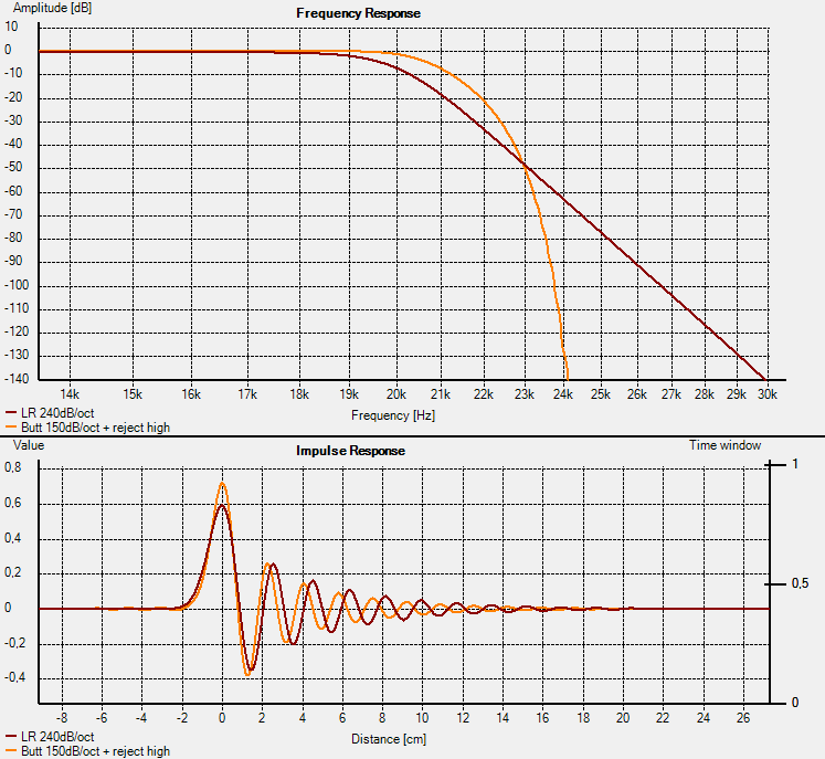

Paul, nice result!
(no need to use "maximal" optimization here: it seems to do nothing useful in your situation: it simply tries many step before giving up...)
Here is an alternative version, as an example, with an additional steep linear-phase filter up high. The signal is already attenuated by the minimum-phase filter when it reaches that point, so the pre ringing is minimal.
(copy/paste it in a ".rephase" file (there will be a "load from clipboard" function in the next version 😉))
The response curve is similar to Soren's filter, but mostly minimum-phase.
It should be quite close to the "filter1" setting from the stereophile article I posted above, so hopefully it will sound good 🙂
Attached is the response curve and impulse of that filter in orange, and yours in red.
The impulse response is close to your filter, but with less post ringing and some traces of pre ringing.
