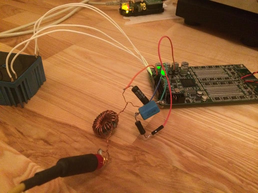

Than please post a correct schematic!!!!
I have already posted recommended schematics, if people want to do other things then they're on their own....
I asked many times how should be the connection between a commercial USB to Spdif converter (like Brezee audio) what has already an output traffo with its spidf.
This schematic is based on the info pieces you gave me. So, please don't say " if people want to do other things then they're on their own...."!

Your answer was:What is the "strategy" if the commercial has already an output traffo with its spidf ? We keep just the 330 ohms shunt and the 1.2 V PS layout ?
So, my drawing is based on this. What is not correct in the drawing?You can then connect it GND to GND, Signal to where the trafo + connects, but with a series capacitors, any value around 0.1 uF.
The important when using the LVDS receiver is that it need to be biased around 1.25V as the common mode input range is 0-2.5V.

Look at the link Stixx posted - then from that schematics remove the input traffo, and add a series 0,1uF capacitor on the IN+ line. That is at least how i understand it, because you would then have the signal 1,2V lifted from ground, and input to the dac.

The manual will only have the same drawings I already posted.
And to repeat: There is no harm in having two transformers.

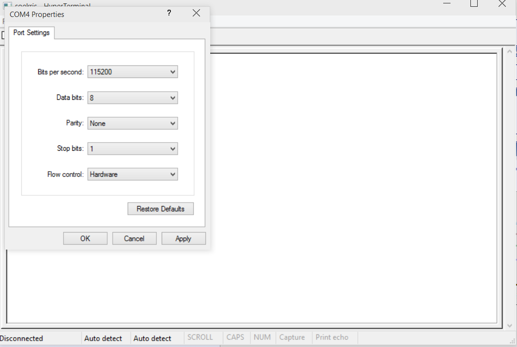

Yes did power cycle. Program settings seems ok.
Also tried Hyperterminal - also with recommended settings, still no luck.
Will look into other serial adapters when I have the chance.

This is the usb-rs232 adapter I try to use.
SYBAUSA - SD-USB-S >> USB to Serial Adapter
Tried with different pc's. Driver installed ok and com ports ok.
No luck connecting to the dam1021.
Used the "description" from this blog.
The right pins. Measured connections ok.
No luck connecting.

Remember no flow control, hardware or software. Your settings have hardware flow control enabled....
Yes sorry about the misleading picture. Tried with and without flow control. No luck I am afraid.

Tried to shorten the cable. Everything checks ok.Remember no flow control, hardware or software. Your settings have hardware flow control enabled....
Also using description from this blog
Dimdim's Blog | DIY Audio, Arduino, Computers, Music
The cursor just keeps blinking. No response from the umanager.

Well - made up a spdif input (with AN spdif toroid transformer) 🙂 according to schematics posted earlier.
Test with unbuffered outputs - into a DCB1 unity gain preamp.
It is alive. Too early to say anything about sound quality but I can sure tell you:
Its got potential 😀
