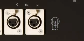

I have new amp with balanced inputs.
The settings of balanced input looks like on picture:
I have see on Soekris 1021 schematics and checking balanced output. I found the connection looks like output pins + an - will be in same place like on this picture.
But I want to ask, as I'm not familiar with balanced cables - is it standard? May the cable will invert connection pins?
May I need specific cable for this case?
Or, I can connect balanced outputs as is to 1021 board and use standard balanced cable to connect the DAC to my amp?

+ goes to pin 2, - goes to pin 3. Connect DAM1021 PCB to chassis ground only via the PSU ground connector. You don't want multiple ground connections and you don't want to connect audio ground (at the DAM1021 PCB output connectors) to connect to the external ground of your preamp (which should correctly be connected to that unit's chassis ground).
