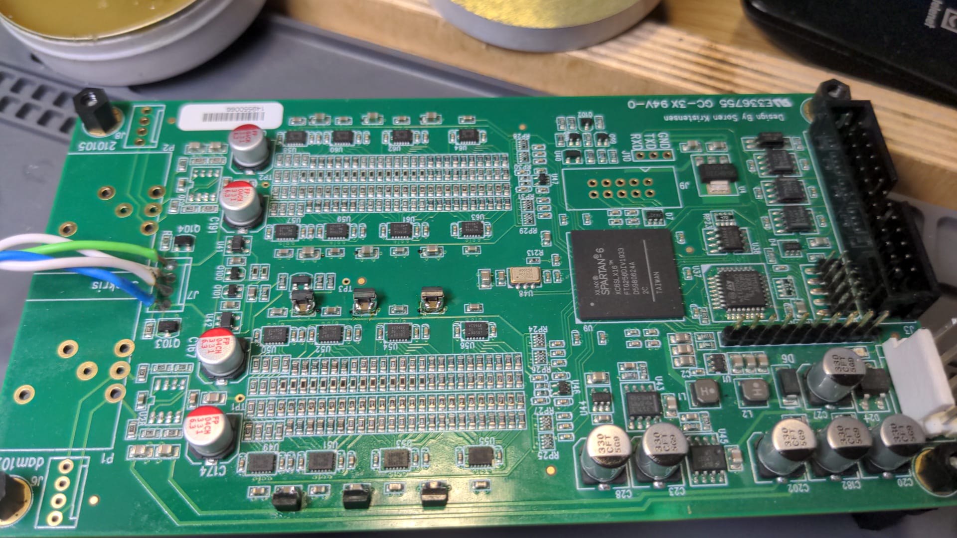

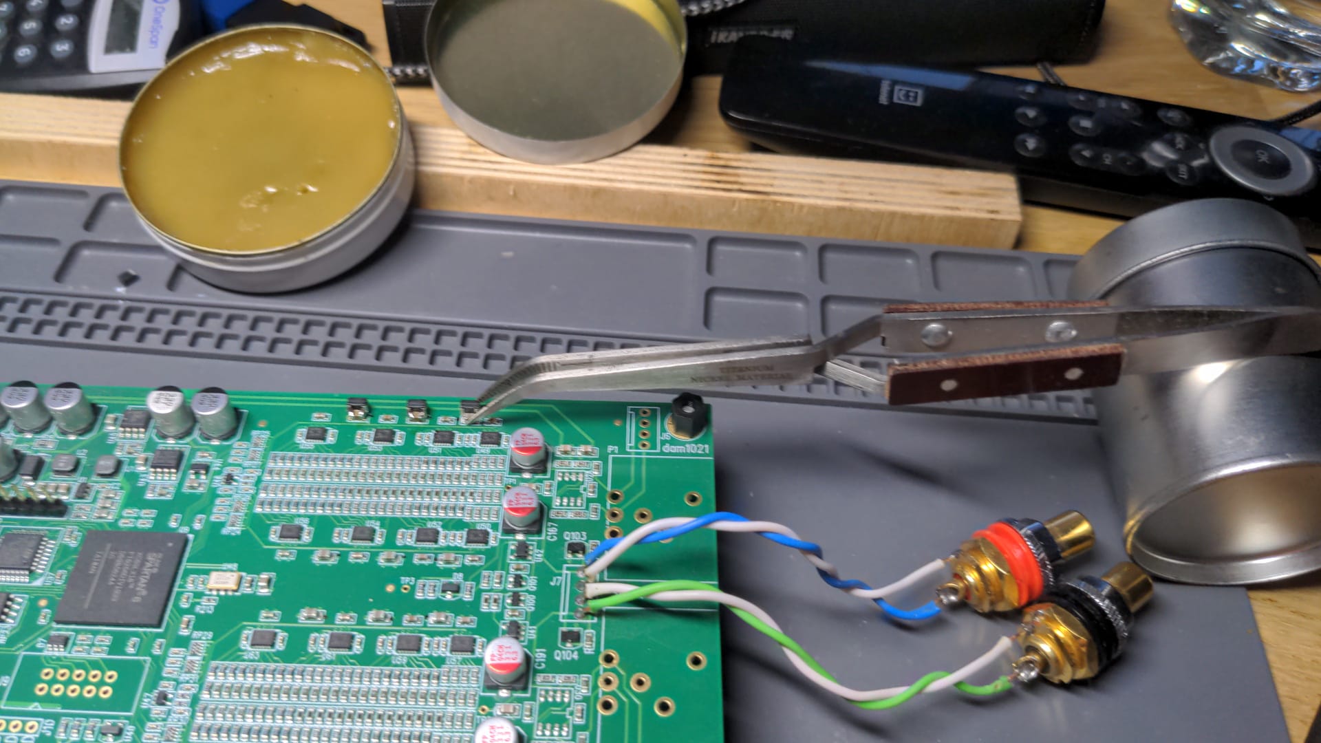

Last year I bought a dam1021 rev7, I already had the rev1 fully modded.
The new rev7 in stock already sounded better than the old rev1 modded.
Looking at the rev7 board, there's not much to be modified, Soeren already updated the vrefs and the clock PS.

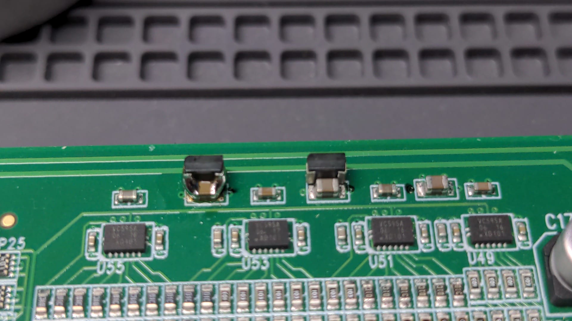

The only thing that I see was adding better caps to the shift registers decoupling,
searching in mouser/digikey I found the new Kemet KO-CAP T520 tantalum-polymer caps.
The 100uF 6.3v in a 1411 package with only 15mOhm is a good candidate,
they can be soldered next to the biggest existing ceramic caps, there are 12 of those.
Attention: those Kemet T520 are polarized, it is needed to check the polarity for each cap (no logic on the PCB)
