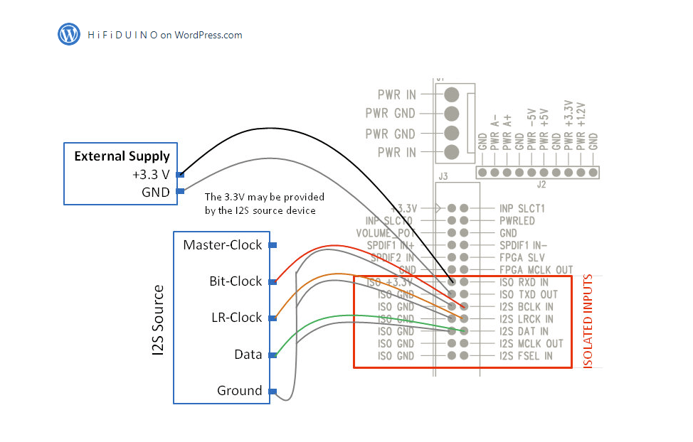

I have used this image as reference to connect to the DAC. https://hifiduino.files.wordpress.com/2015/01/spdif1-2-2.jpg

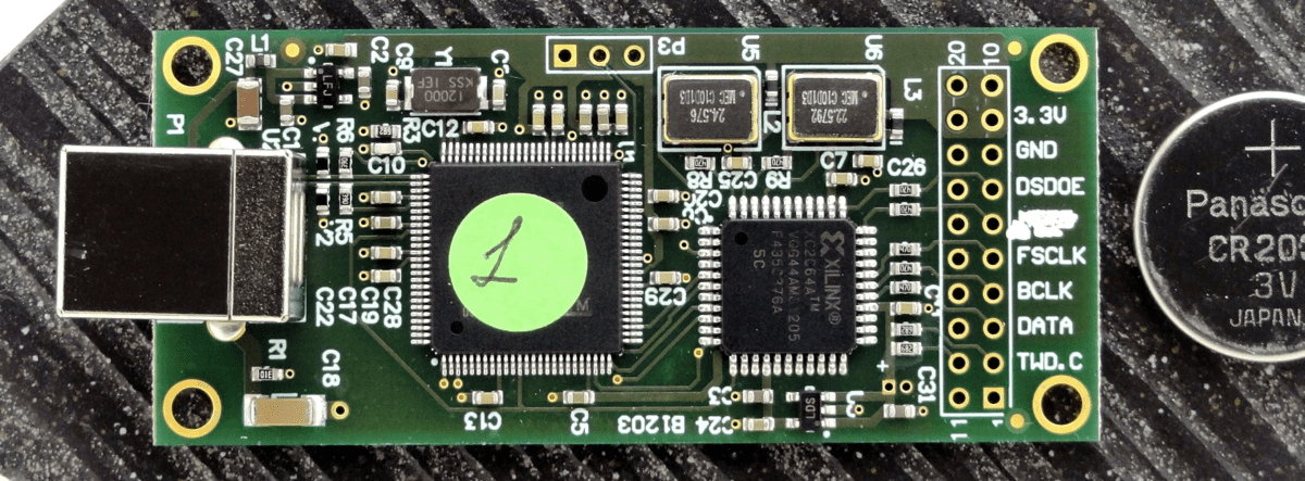

I`m using Amanero and do I need to use an external 3.3V for it? I guess its powered by USB itself?
1) Not powering the "dirty" side of the DAM I2S isolators, or
I have used +/-12V at PowIn PowGnd PowGnd PowIn for positive and negative supply. Is there anything else that needs to be powered up externally?
https://hifiduino.files.wordpress.com/2015/01/r2rconnect.png
2) Forgetting to connect GND to the "dirty" side.
the PowGnd is already connected internally on pcb on dirty side isnt it? Is there anything that Im missing in here?
Can you please post an image of which GND you are talking about. It will be really helpful. Thank you.
I have not used the 3.3V external power supply. Is it mandatory?
Do we need to give the same 3.3V supply even to the Amanero board? I guess Amanero gets its power from USB? Or do we need to additionally power up the Amanero board?
