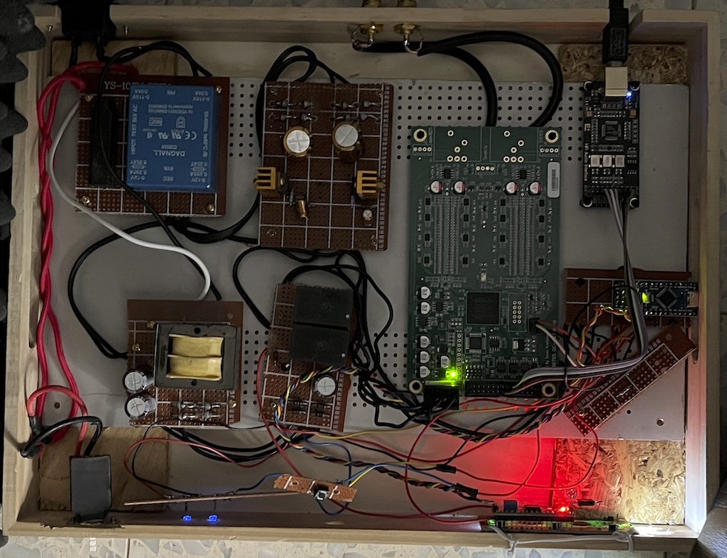

Hi all,
As we know startup of Arduino Nano takes a little bit more time to run instead DAM1021.
This timing resulted by lost first DAM RS232 output with full configuration.
To fix used digital out of Arduino for relay power input. 2 relays connected to power in of DAM1021 and small kay schematics based on transistor used to control on/off state of power in.
When Arduino started up and finished in setup LCD and Serial init - pin set to 1 and relays going to power on DAM1021.
All outputs working correctly.

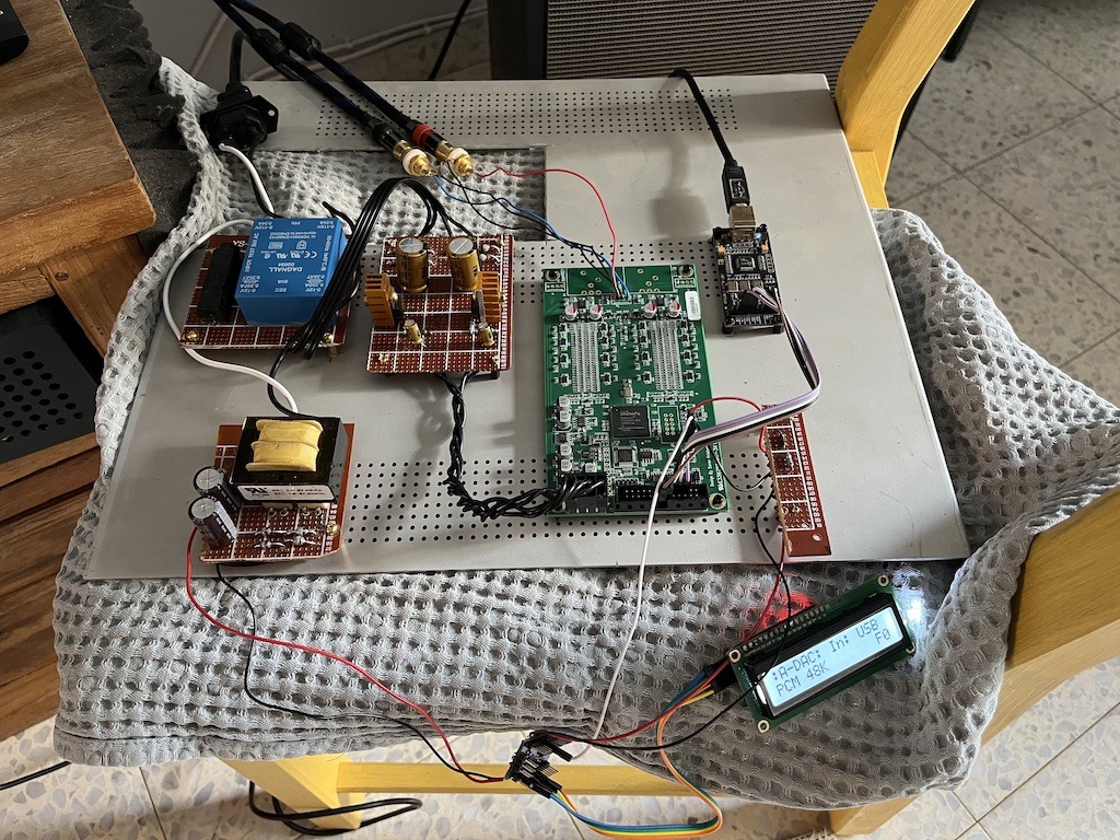

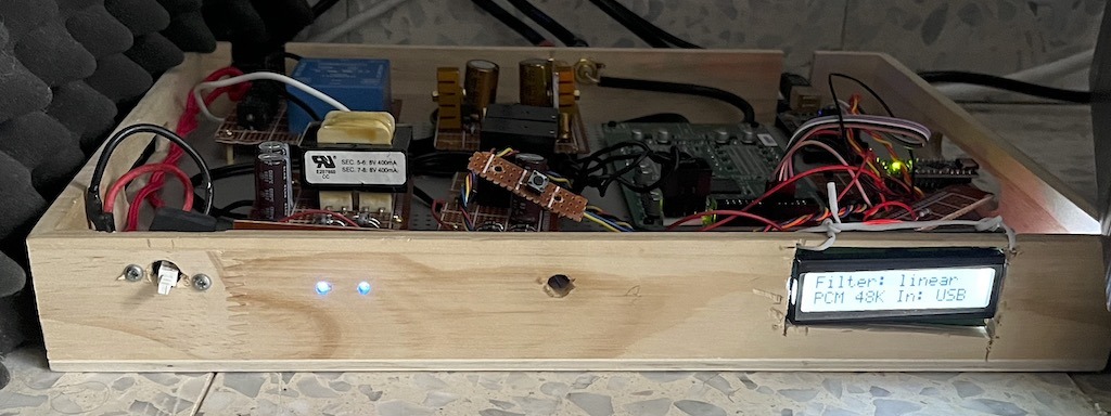

Hi all,
Last status of DAC DAM1021 project for today.
Finished HW side - beta-release (maquette) in box for review layout.
HW has 2 power transformers. First used to power DAM 1021.
Power supply has 2 stabilization rails based on LM317 with head-sync with output ±9V.
Second divided to power Arduino NANO by 12V output plus second output used for relay control.
Arduino required more time to power on and miss start up serial output from DAM 1021, relay on 24V control power used to delay power on time for DAM 1021. Arduino start first till the LCD and Serial interface has come to be stable and thaen using digital output pin set 5V out on transistor based key. Key on enables relay 24V control power and 9V come to power on DAM 1021.
One button used to switch filters in loop on DAM and 2 leds (power and functional) show what currently happen inside.
LCD provide full information about input used, filter set and current stream( PCM and bitrate).
FW on Arduino has several issues like o exit from uManager currently.
Next steps will be to fix Arduino SW and prepare original box planed.
