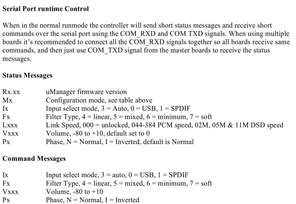

Dear Gromushka,
When change input, volume or filter, maybe it can send "I3\r\n", "V+00\r\n", "F5\r\n" without enter uManager.
But,... my dam1021's firmware is R1.06
Sure - when I enter set filter command first time I see F5 or some other number after F which filter was set as output.
But just first time.
FW parsing this output to complete check if filter set successfully. So I'm reading the output and cleaning the buffer.
But any second command fail.
From PC I can do it several time - so issue on Arduino side of course. May be this is HW, may FW, but I need just example of working simple command send several time from Arduino.

That what I'm sending with input and output (working on PC and not from arduino)
->> +++ ;; for enter to uManager
<<- dam1021 uManager Rev 1.24 20210530 FPGA Rev 1.24 Press ? for help. ; bolded part can't read by Arduino but see on PC
->> set filter soft ;; as example set soft filter (F7 from my revision)
<<- F7 # ; output come and read from DAM in Arduino succeed command first time.
->> exit ; doing exit from uManager
<<- Invalid Command ; reply from DAM. All other commands also has fail till full Arduino power cycle.
So I don't see any issue from my side.
Each print / println command are cleared by flush commad before.
Each data ouput read by loop using now readBytes command.
I have understand case when different command fail on unstable HW connection or some voltage settings. But not constantly first success and other fails. It just like some critical issue with my Serial Arduino interface understanding (or bug).
Setting only survice power cycle if made in uManager.
Sure, understood, but the issue with uManager only first command still here.
Now I have found my bug so now commands without uManager are working.
Thanks a lot for bill6300gp for idea to use it.
I have use EEPROM to save filter was set last time, so power cycle also now restore last filter used.
Currently I finished first simple FW for Arduino and HW parts.
Last step - made good look of DAM DAC.
Thanks for all for reading and supporting.
Are you connecting the Arduino to the DAM via J3’s TX and RX pins? They allow direct command control (read and write). The J10 port is for uManager - which is primarily intended for firmware upgrades. From your posts you appear to be trying to go into uManager via the Arduino to issue commands. If that is what you’re doing then it’s easier to use the J3 TX/RX pins and avoid uManager altogether.
Remember - J3 is TTL.

Why use .... uManager (terminal program), if short messages/commands also working via serial port in case of any DAM DAC panel?
No - I'm using J10 (rev 7 board has modified 3 pins connector easy to use)
From HW point of view this is no difference between HW input to logical. Both interfaces come to similar FW points and supporting same possible connection.
J3 different from isolation POV and could be used for sending command during music played to change filter with less impact to power on DAM.
Yes sure. Thanks.
This is 2 reasons was.
First were very stupid I have missed this possibility. In short spec from DAM site I haven't found them but only here in forum.
Second - saving possibility to set filter stored for power cycle too for all parameters included input and volume.
But now I have build small saved in EEPROM structure for use to save parameters and restore them by power on. So it's not required now.

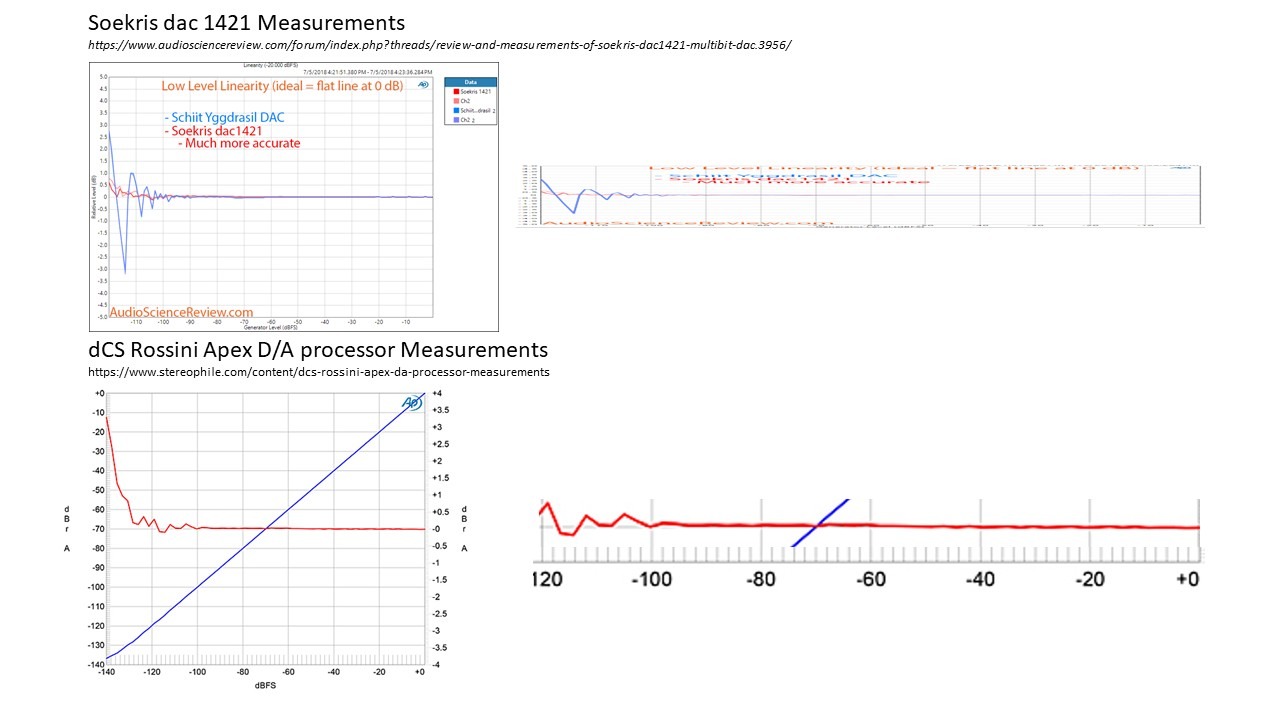

I could'nt resist comparing the linearity measurements available.
Although the context is different, it is interesting to notice there are no performance differerence noticeable.
The attacked picture shows the two measurements where the scaling is adjusted on the right.
