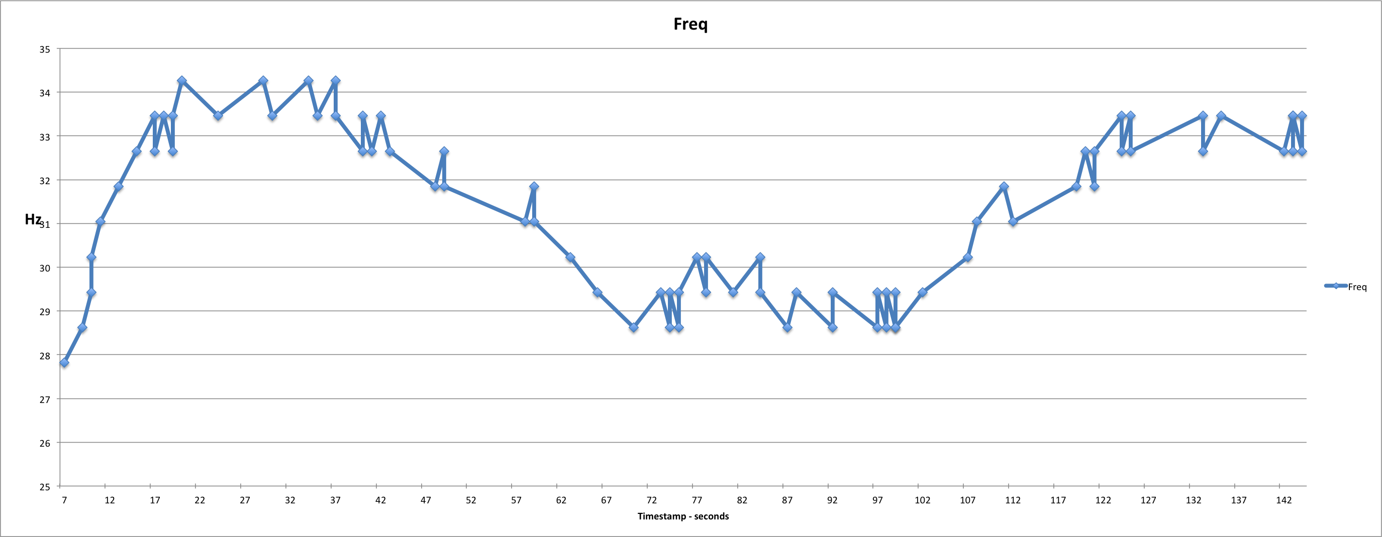

From post #828:
"7) Reclocking FIFO with automatic clock tracking works like a charm, syncronize to < 1ppm at anything withing 1% range, and then tracks using a software PLL with 0.02 Hz Lowpass Filter and with 0.02ppm step changes."

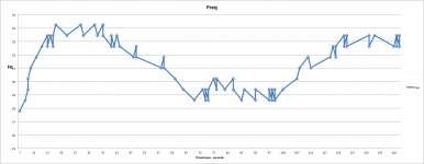

0.02ppm of 49Mhz is about 1Hz - fine that's another confirmation.
O.K. to get an idea on the effect for the audio side one could look at an audio-band square wave played by the DAM (unfiltered).
It's frequency would also change also by 0.02 ppm (so 20uHz for a 1kHz square wave).
You get thus exactly the same curve only with appropriate scaled y-axis (divided by 49000).
No idea if that is audible, but as it easily could be avoided by introducing some damping why not get rid of it.
New try after zfe comments.

So, the reason i like this dac is cause it's got more wow&flutter than a cheap turntable? 😛
Or is the plot a bit exaggerated?
It's effect on a audible tone is related like the frequency the clock oscillates on and the change in frequency - in ppm or 100 times better territory.
I had a 1000x fault in my absolute values - but relation is the same in the corrected one.
Got absolute pitch? 🙂

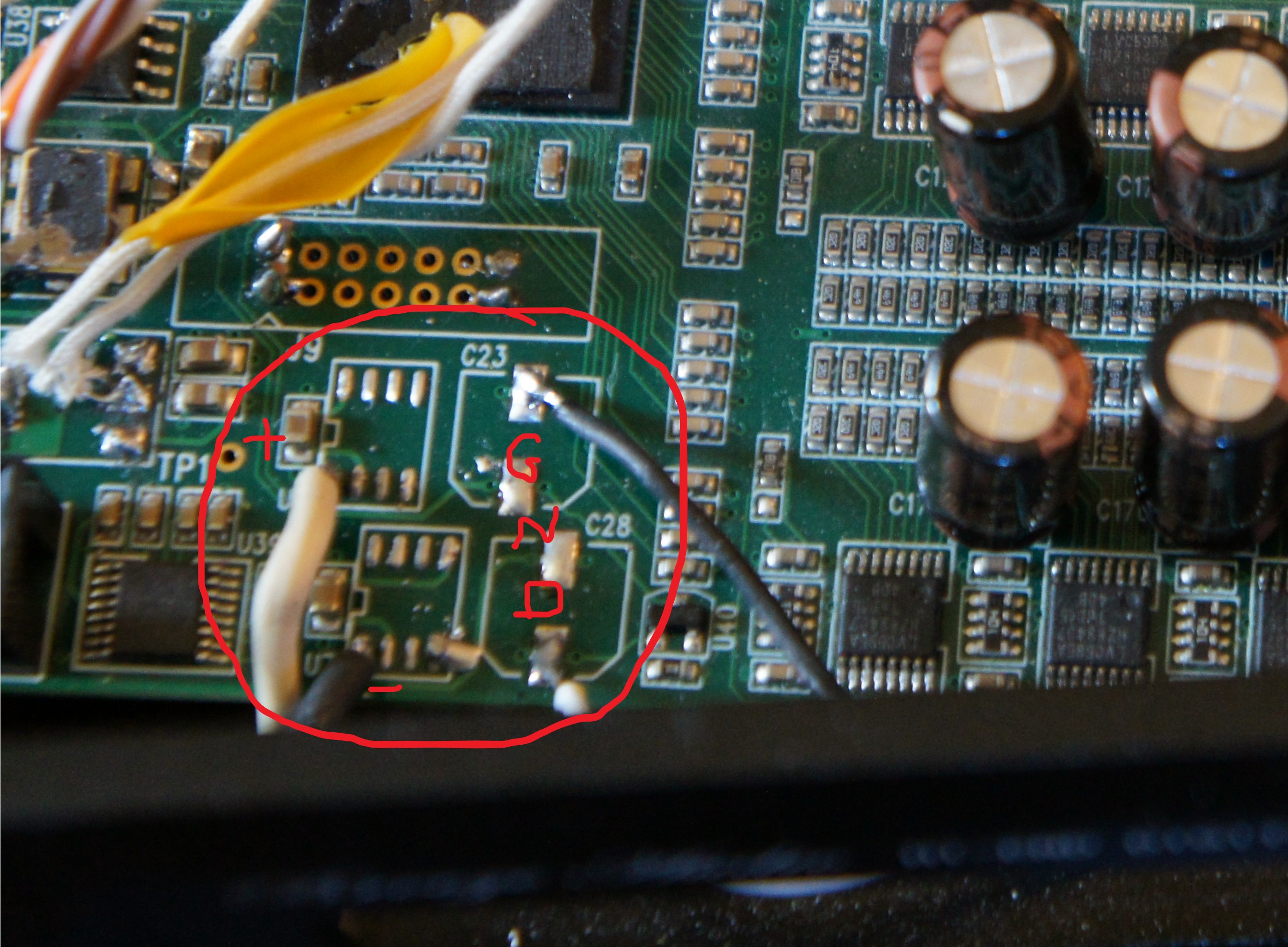

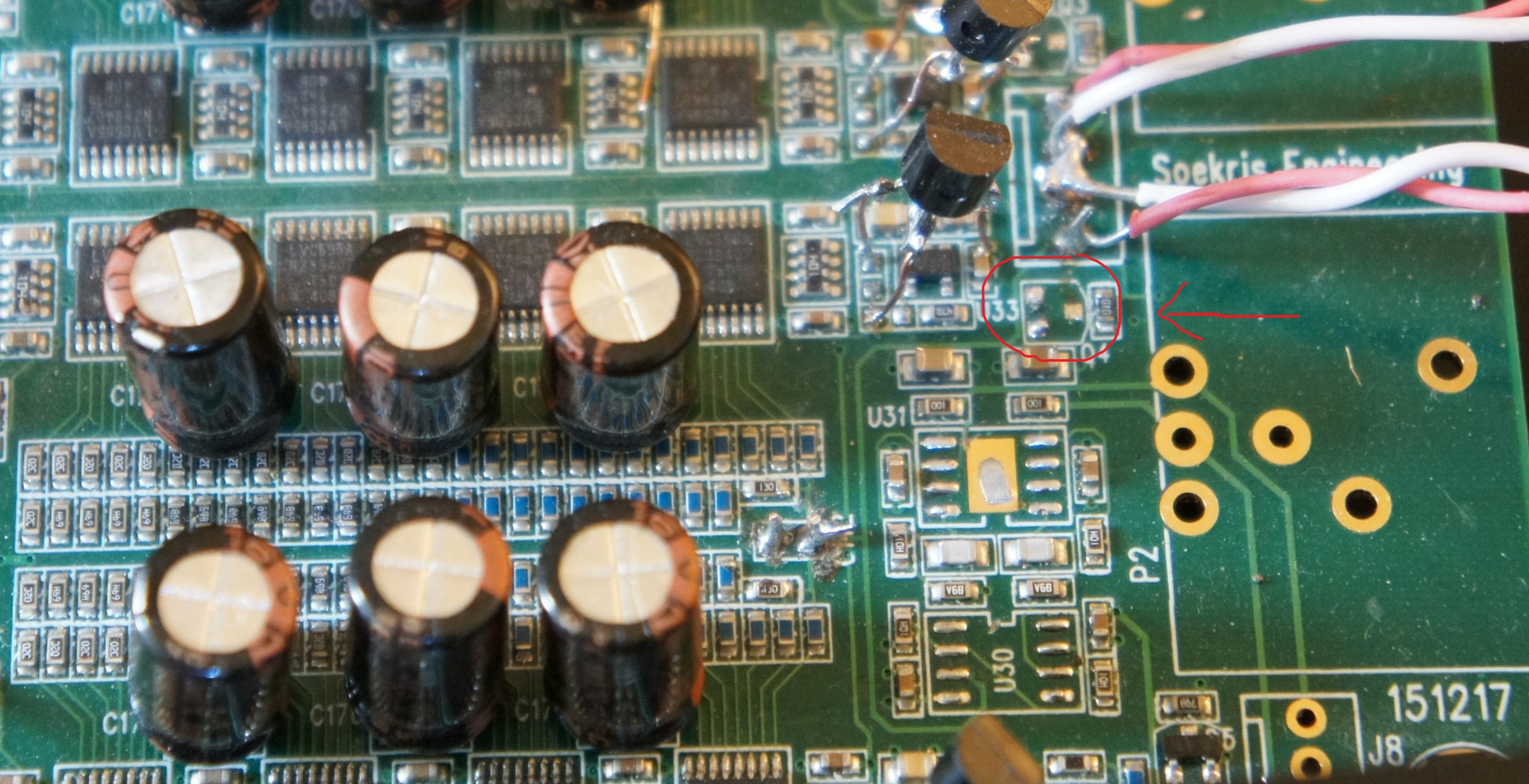

Can you post a few pictures? One with bypassing regs, one with muting fets ....
I'm about to do the VREF and transistor mod and add Salas reg to power the board. I could remove the muting fets too. I have rev2 board.
Regards
Hi Flikoman, I apologize for the delay in responding. Here are some pics of the reg bypass and muting fet removal. I used chip quik remove the regs. Makes it easy.

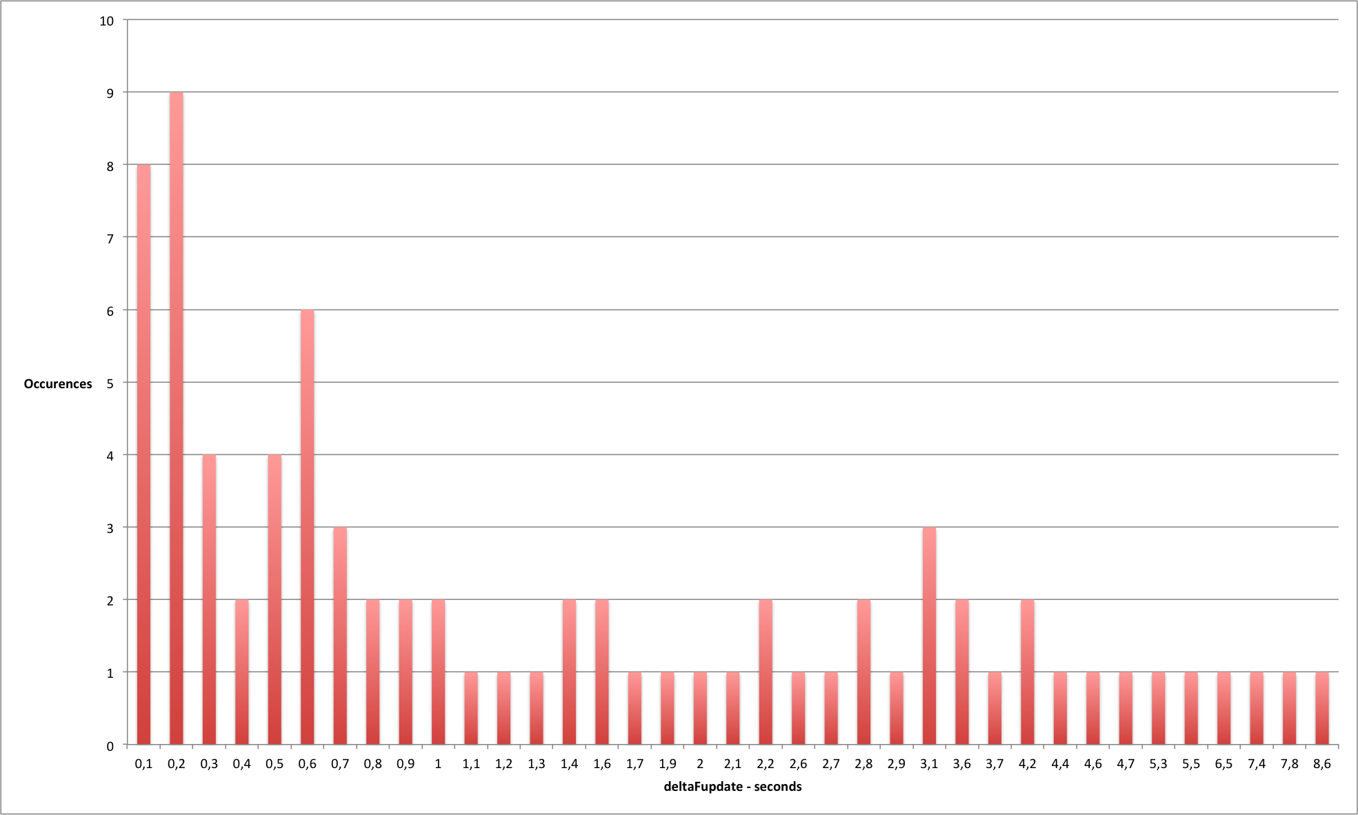

Yes, I was also wrong about the change intensity in my first assesemnt of the data - sorry about that. Chart below shows the distribution of duration between frequency changes for the 2 minute recording. Almost all these changes was 806 hz. A few was 805 wich I found strange...
Now, if one had access to the variation of the input timing....🙂
PS. Don't really fancy all that poking :whip: of the clock - give the clock a chance to do it's best I'd say 😉 ... if one aims for a "Reference DAC Module...".

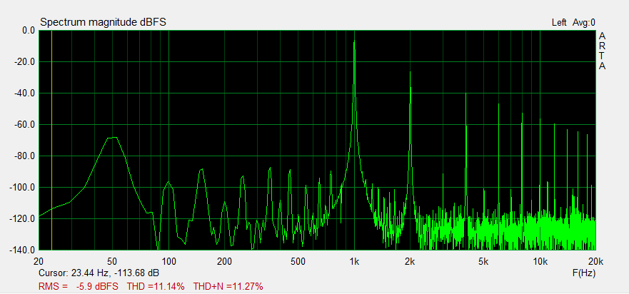

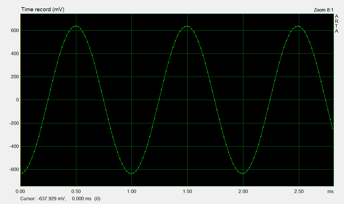

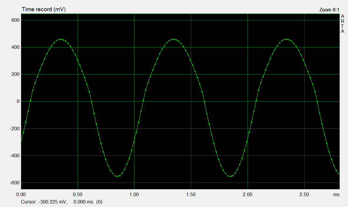

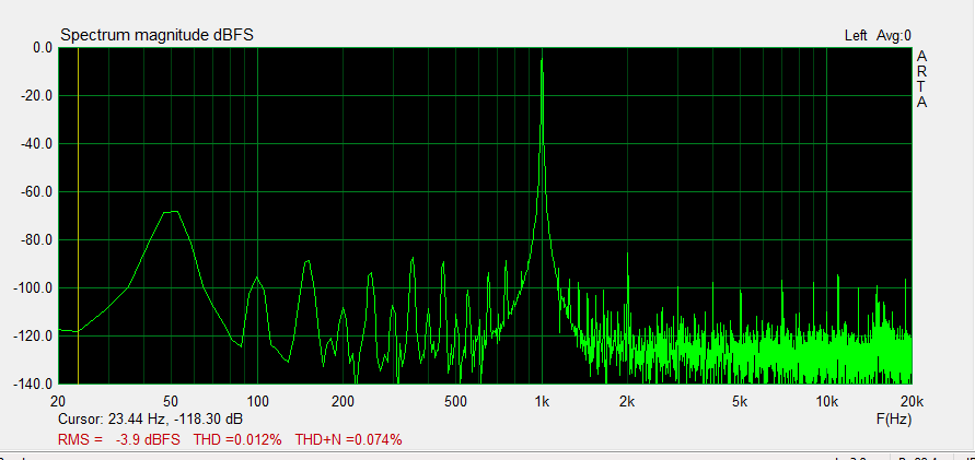

Distortion on the right channel
I have a V1 DAM with vrefmod and have been very satisfied for a few years now. However, recently I noticed some distortion on the other channel while listening. Did some quick and dirty measurements once I got a reasonable USB-audio interface and noticed that the right channel indeed has some weird happening there.
The overall amplitude of the signal is smaller and it seems that the positive side of the voltage swing has some sort of error on it. Looking at these, any ideas about the possible cause and advice whether I should start troubleshooting further or should I just get a new board?

Clearly a problem with the vrefs, check them....
