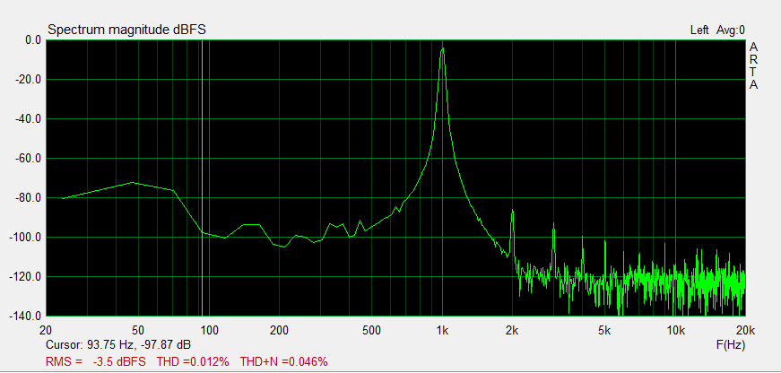

Thanks, found a cold solder joit in the 0.1 ohm resistor on the output side. The resistace over the resitor was over 500 ohm. Quick resolder and it seems like the problem was fixed!

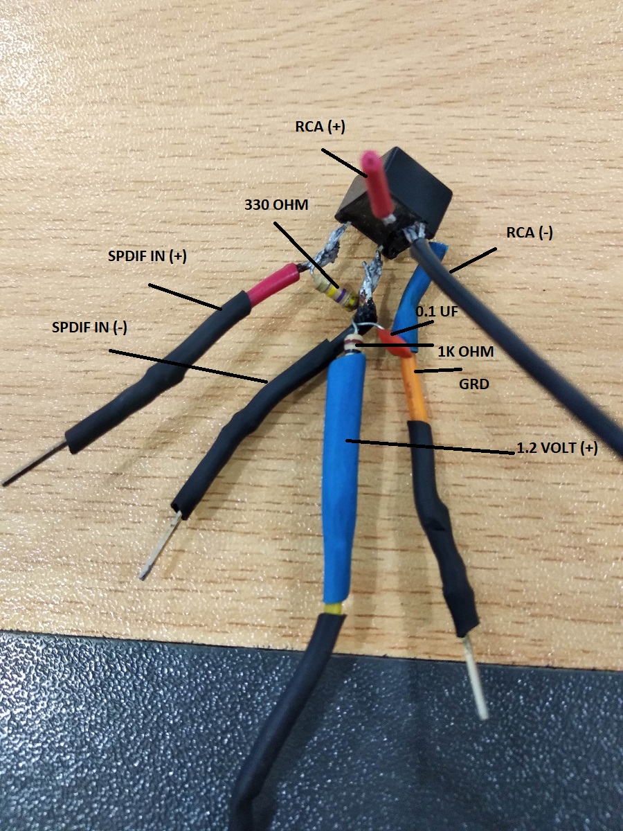

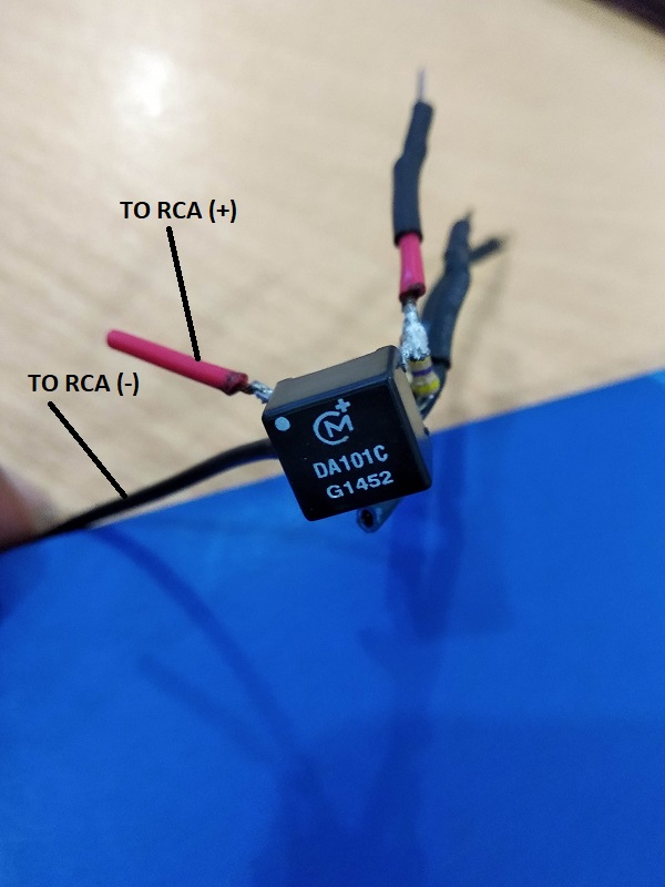

Disassembled all vref cap. Measured the voltage at reference point - J2 and J3, all looks good. I am now using 11 volt 1 amp PSU. I connected RPI using I2S connection. Volume level is ok but it is creating some distortion. I used normal jumper cable for testing only, may be that is the reason of distortion . I need to reduce the cable length. Do I have to use shielded cable for i2s connections? Sound from the Coaxial connection source is still weak, I think there must be some kind of mistake that I have made . I am using DA101C pulse transformer. is there any orientation of this transformer? The dot mark is connected with the RCA + side. Need your kind suggestions please.
Can you show some pics of the wiring? Where is the + attached on the other side of the transformer?
