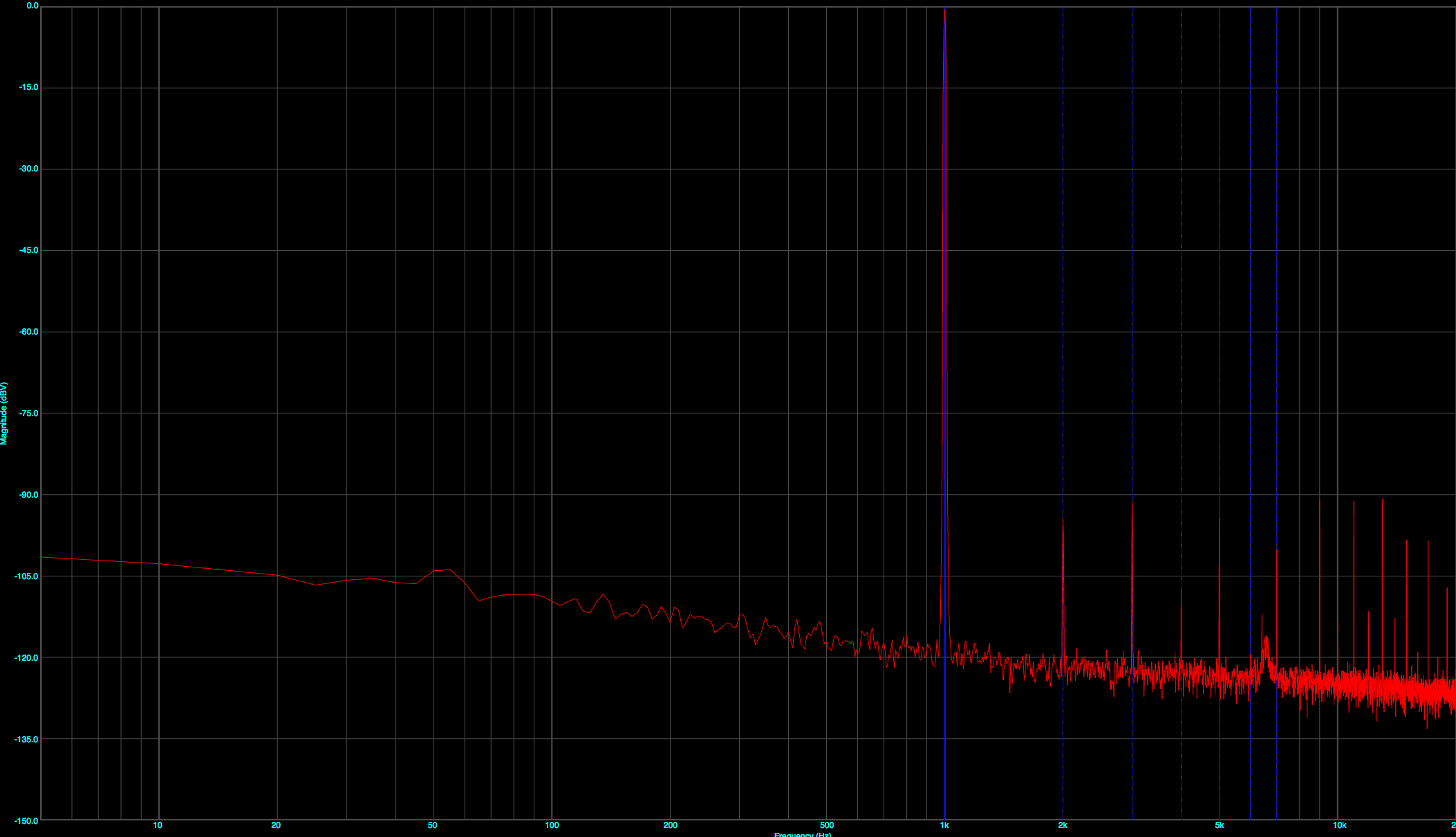

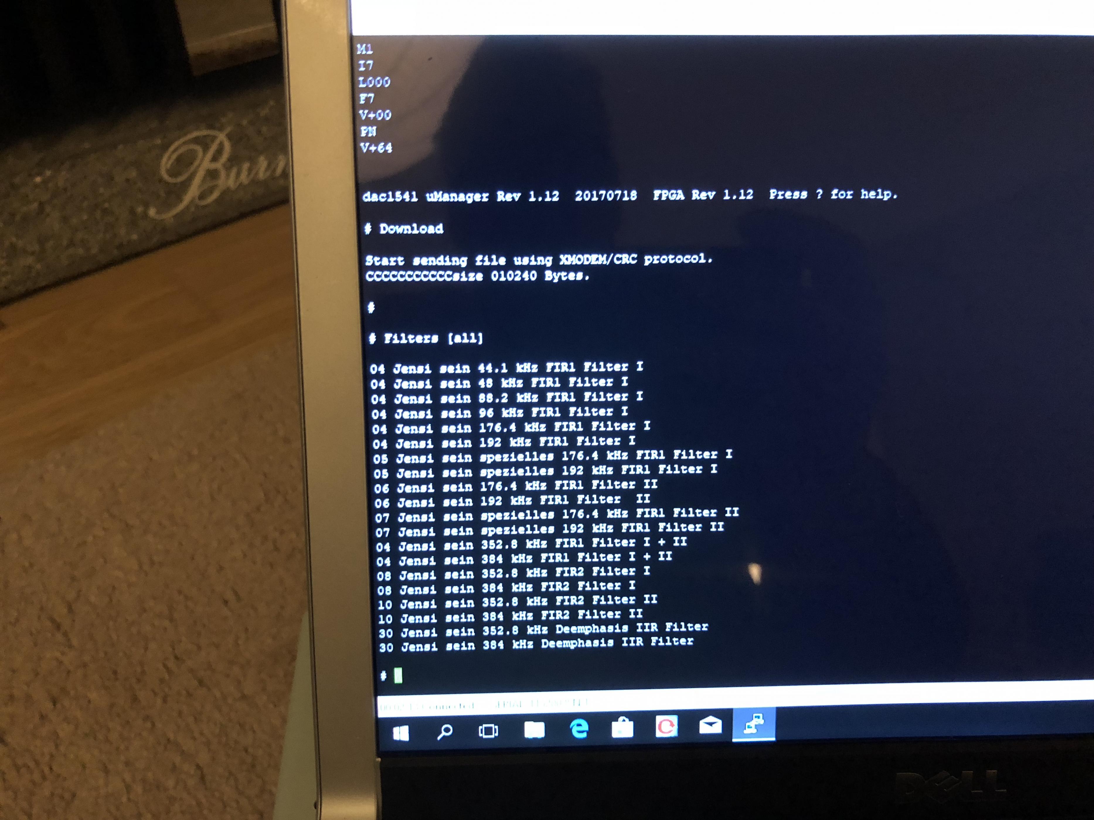

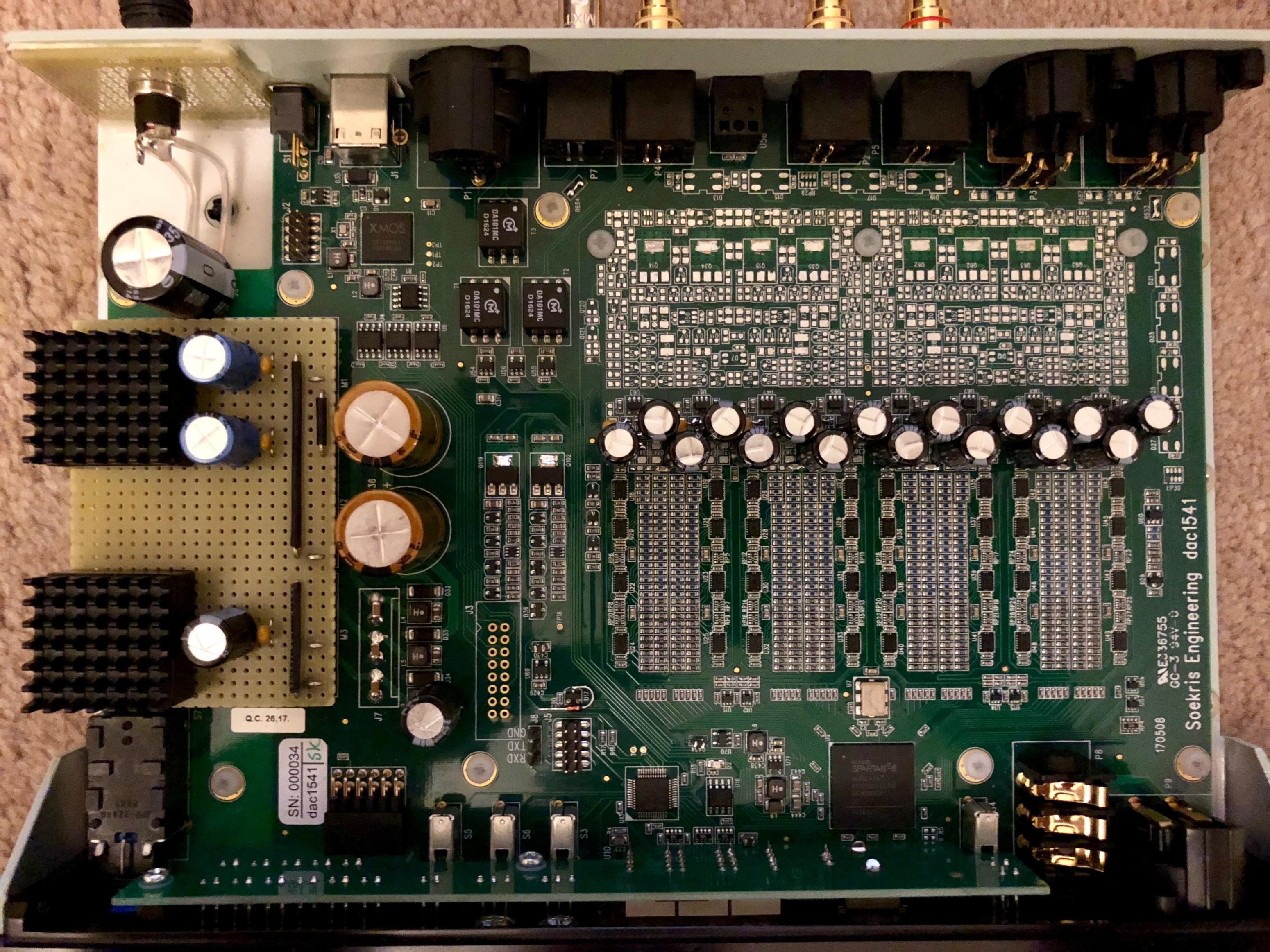

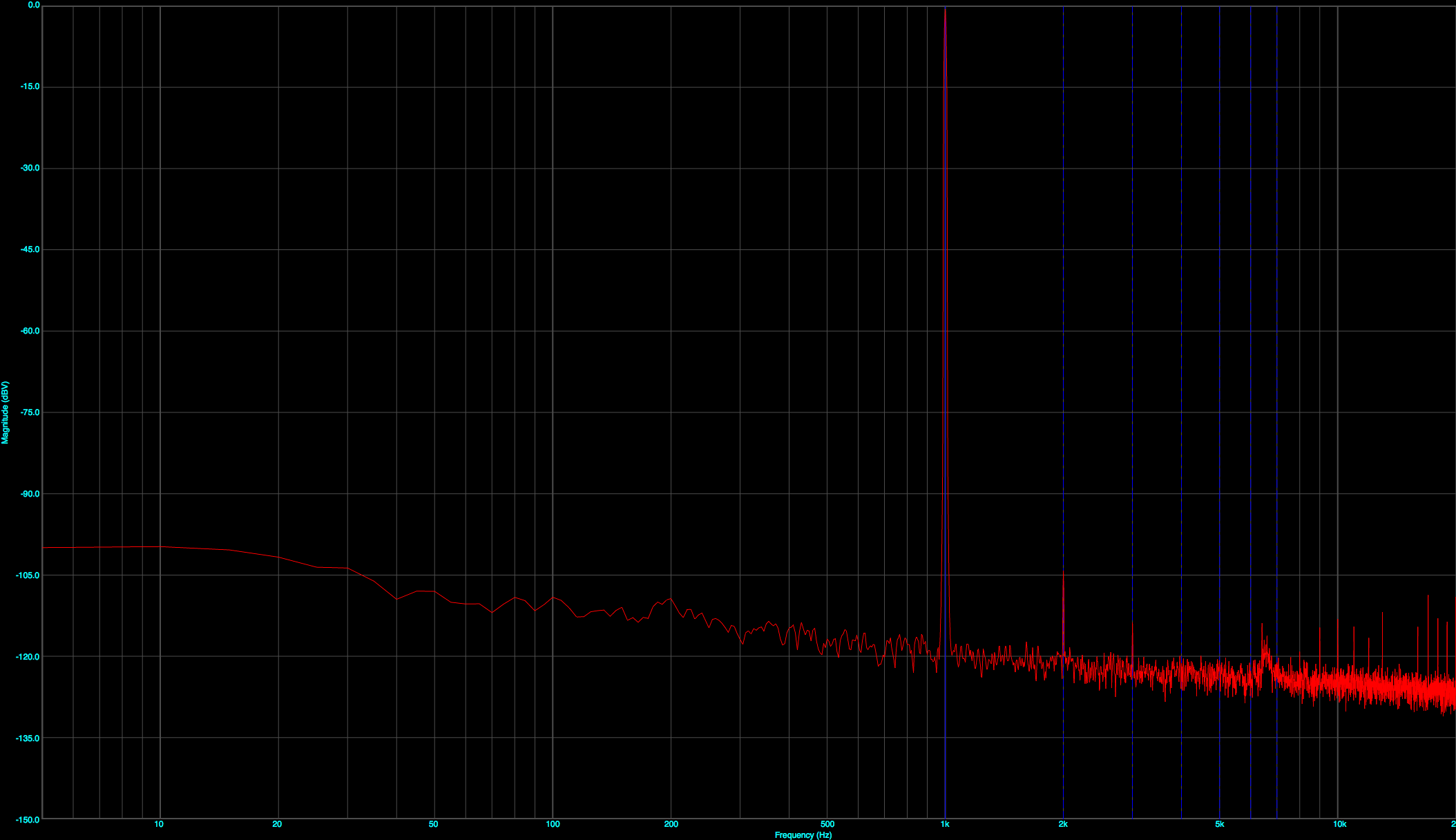

I've changed a bit on my 1541 and achieved good. Attached are some pictures:
1. 1541 currently.
2. New filters.
3. Spectrum before the last changes.
4. Spectrum up to date.
Next, I'll think again about the USB input, always grateful for suggestions,
Greetings JJ

JJ, is it your own brewed filters? Whats the strategy? Will you share them?
Hello TNT,
I have tried my own filters but have not achieved anything good. Then I tried with different combinations of available filters, was also not optimal.
My current strategy is to outsource the first upsampling stage to the MAC. This works very well. In the second upsampling stage, I'm currently using the standard minimum phase filter, but that's certainly a question of faith, and others are doing well too. Worth mentioning is the profit from the removal of the 2 Hz IIR high-pass filter.
Attached the current filter file.
Greetings JJ

That is some serious cannibalization, you should have kept the amplifier and just routed the direct resistor ladder output to the output connectors....
But what step caused the distortion to drop ?? I don't believe that the hardware itself is capable of such low distortion....
And in your opinion, what did you gain by removing the highpass filter ?

From your pictures it is not clear of which "filters" you speak that are cause of the change. Filters of the power supply (first picture) or software filters (second picture).

cannibalization is a funny term, 🙂, your output stage is a great headphone output, but I do not listen with headphones and my consistent Symmetrical preamp likes consistently symmetrical signals with 500-2000 ohms source impedance, for me the only difference level comes in the final stage , I see no sense in a symetrical signal to dismyrate and then to sync again.
You should not devalue your hardware, the measurement is real. ;-) However, the progress is not only in the hardware but also in software search. I've tried a bit of what I've been thinking about for decades, and suddenly there was that result. I still need a bit to describe it correctly and briefly, and I am not sure yet if I will publish it here.
The missing high pass is something everyone should try for themselves. With me he has tonally improved the entire listening area. But I'm not surprised, low-frequency IIR high-pass filters have never been the best choice. What do we really need it for?
The 1541 is a great device, even in production condition. All my changes have been made only to adapt to my listening habits and my tonal ideals, in my chain and in my ears it now works "better", that does not have to apply to others.

Is this what improved the distorsion figures? Do you have before / after measuring for only this change? Or is it omiting the upsampling stage in the DAM that made the improvemnt? Or do you need both?

no, if the 2Hz filter nor the upsampling filter has changed the distortion, it is the hardware in the DAC to the other software outside the DAC. Surely you could insert the software change in the DAC, but that can only Sören.
So you can now only run 384 khz files - right?
... yes, I can only process 352 / 384kHz signals in the DAC, the first upsampling stage is outside the DAC ...
A filter (before FIR2) can hardly do better than playing the real thing - a 384 kHz test signal (real no upsampling).
Have you tried to vary the signal level (of the input samples) slightly? Perhaps you luckily landed on a sweet spot relative to the resistor errors.
