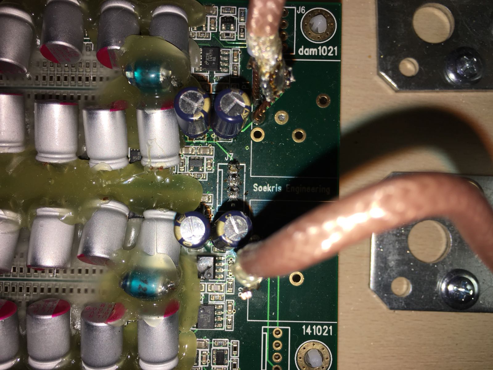

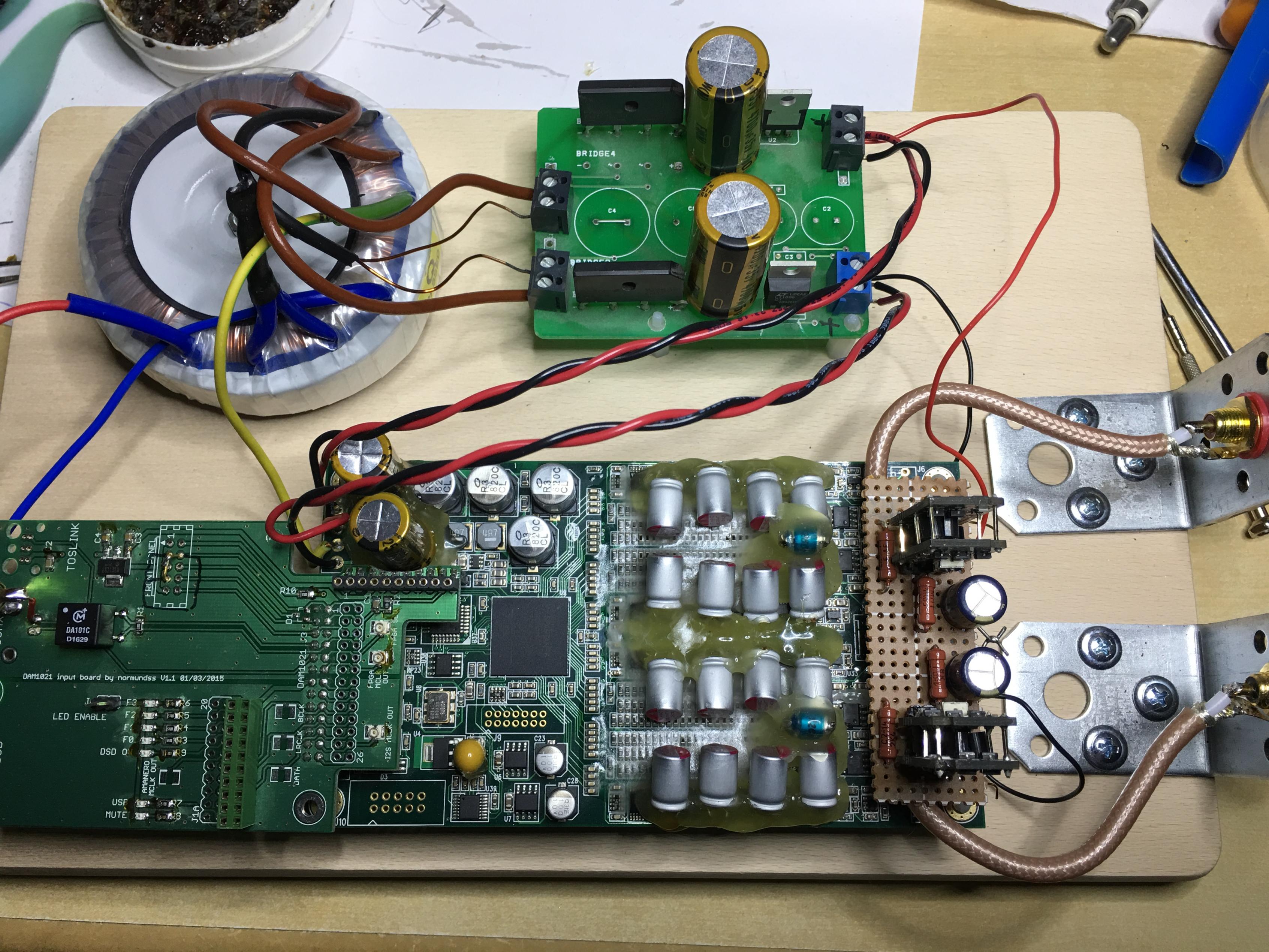

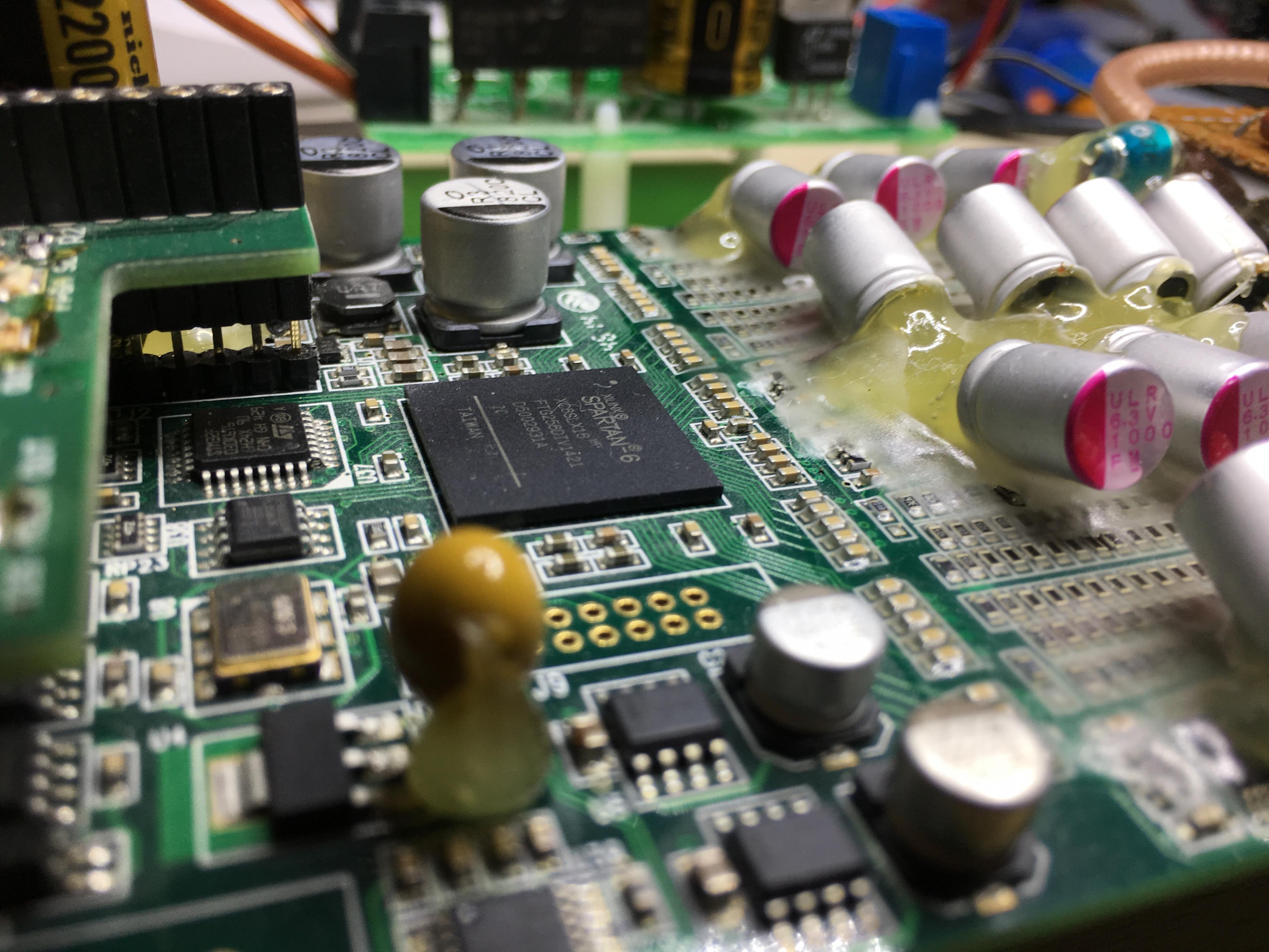

My current implementation.
Two LT1086 regs set to output 2 x 11V.
1,2nF LPF CG0 capacitors replaced with polystyren.
Output with discrete jfet opamps with ~10dB gain.
I have added a small layer of wax over r-2r resistors. This will protect against oxidation.
Tibi

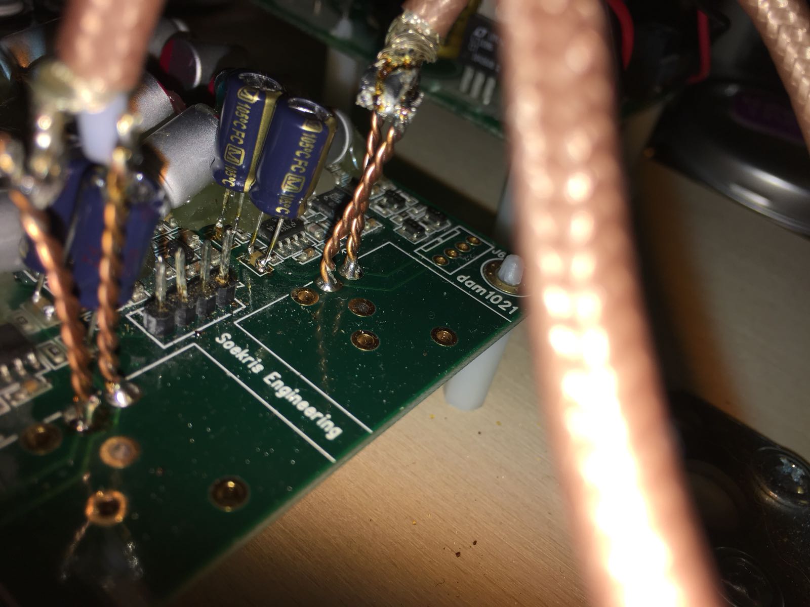

If you use default output stage and wanna good and full bass, here is a mod that will make a huge difference.
Decouple output stage with 100uF/16V. I used Panasonic FC. Rubbicon ZA can be also a good candidate.
Tibi

OK - but I really wonder of oxidation is a problem... But reducing vibration + reducing temperature gradients is probably good. Did you also cover the oscillator?
In time, oxidation may by a problem on any circuit.
Wax is an exceptional dielectric and thermal isolator.
For the time been only r-2r is covered in wax.
Tibi

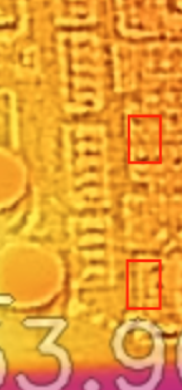

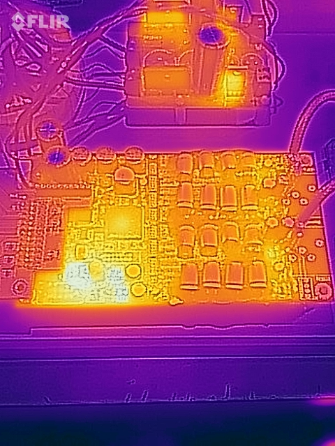

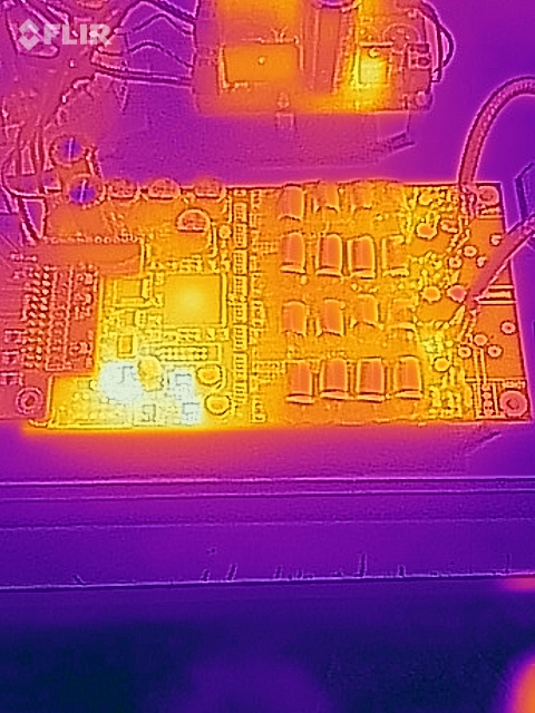

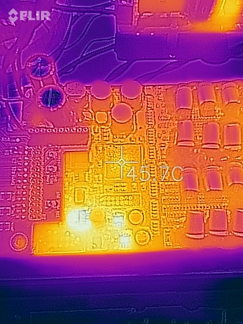

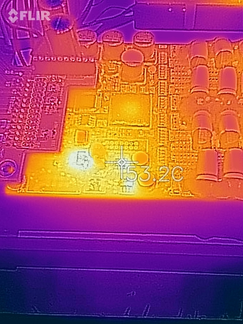

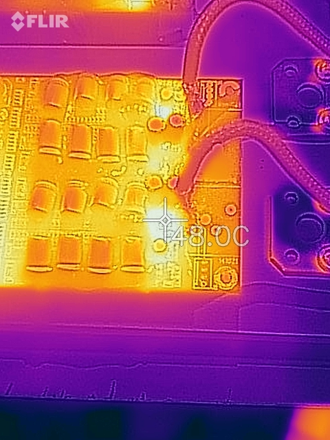

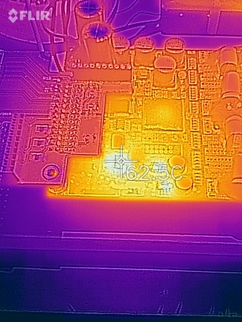

About temperature gradients. Few FLIR pictures indicate no issues on R-2R network.
Tibi

Thermal camera resolution is only 80 x 60 pixel.
Each other is software interpolation up to the "normal" camera's picture.
I use a flirone camera. Resolution is 160 × 120 pixel and temperature 0.1°C.
If you know resistors ppm tolerance and temperature variation across R-2R network, you may calculate resistor variation.
Vishay - Change Of Resistance Due To TCR Calculator
Tibi
