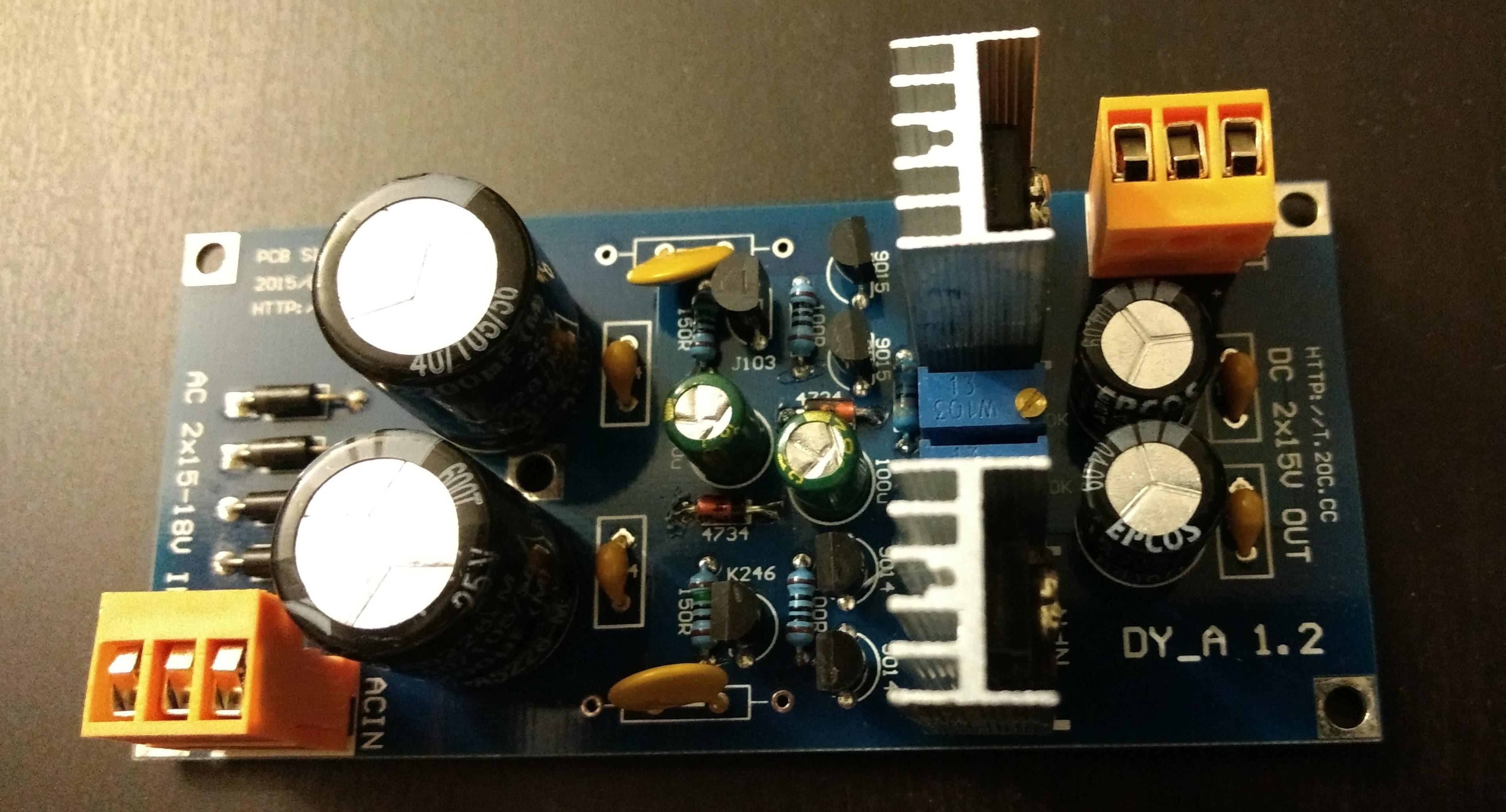

Why 15V? It will generate a lot of heat or even blow the circuit.
Datasheet: preferable 9-12V DC
Try 9V, less heat, less stress.
I've ran mine at +-15V for months on the stock LDO with no ill effects, the LDO got quite warm but nothing near its limit. I've since went 12V simply because it runs the Sparko 3.3V regulators a good 15C cooler, they run stupidly hot otherwise.

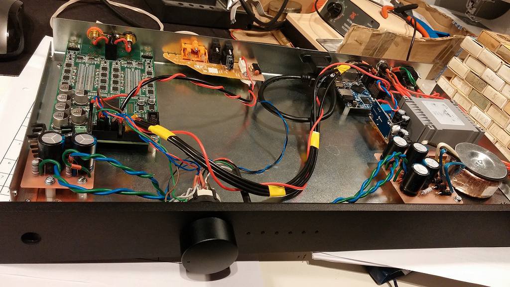

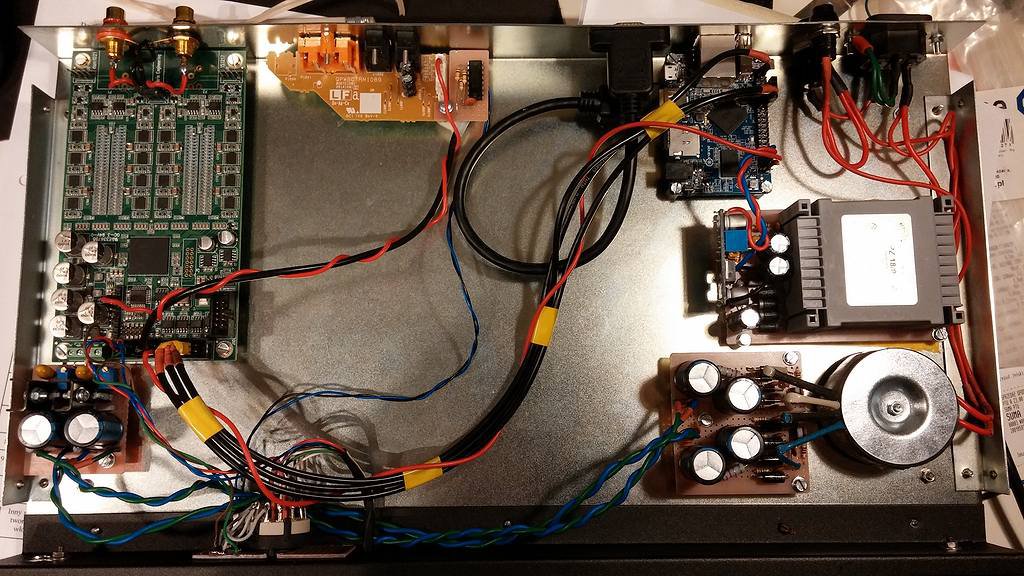

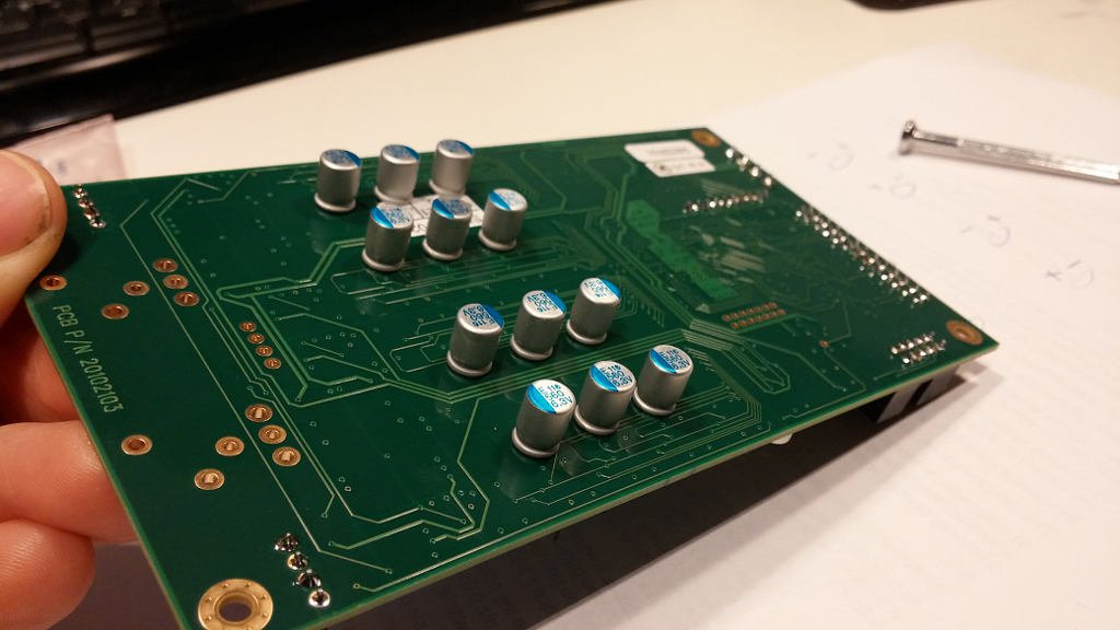

So mine build.. i think one of the "plan minimum" - as i sow from few other builds on this site..
Only additional capacitors added (rev3 board)
Since last post none of loosing sync issue - so build is stable..
i2s from orange pi works up to 384khz..
i install on orange pi openelac+kodi.. because i have already kodi and it is easy to use one apk. as remote controller

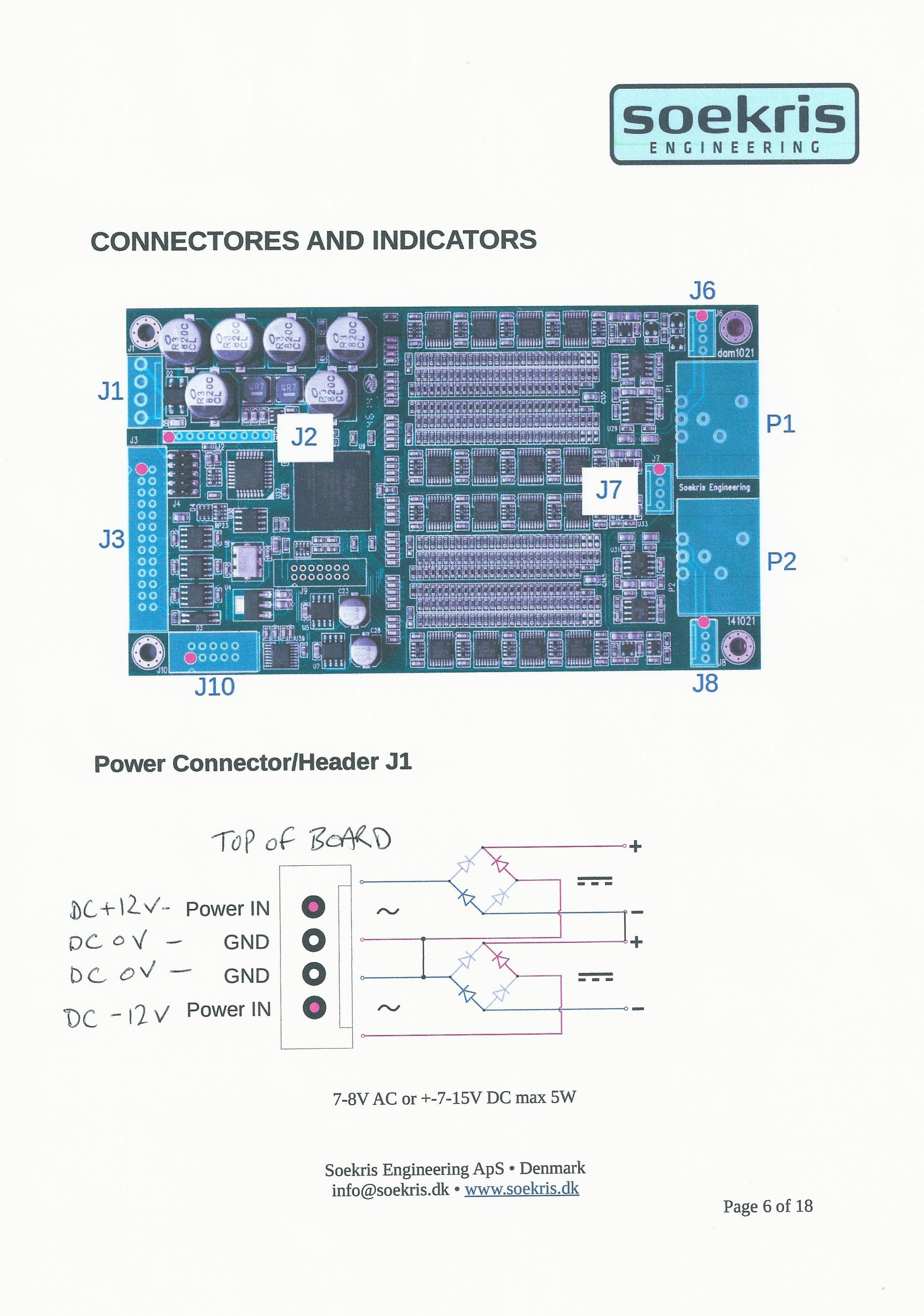

Hi Forum,
Being a little confused as to the power supply connections, I have annotated the appropriate diagram from the user manual and wondered if people could comment as to whether I am correct?
I would welcome any comments regarding whether an AC input or the regulated DC input from the board (attached / D1762) I am thinking of using would be 'best' please?
Many thanks!
