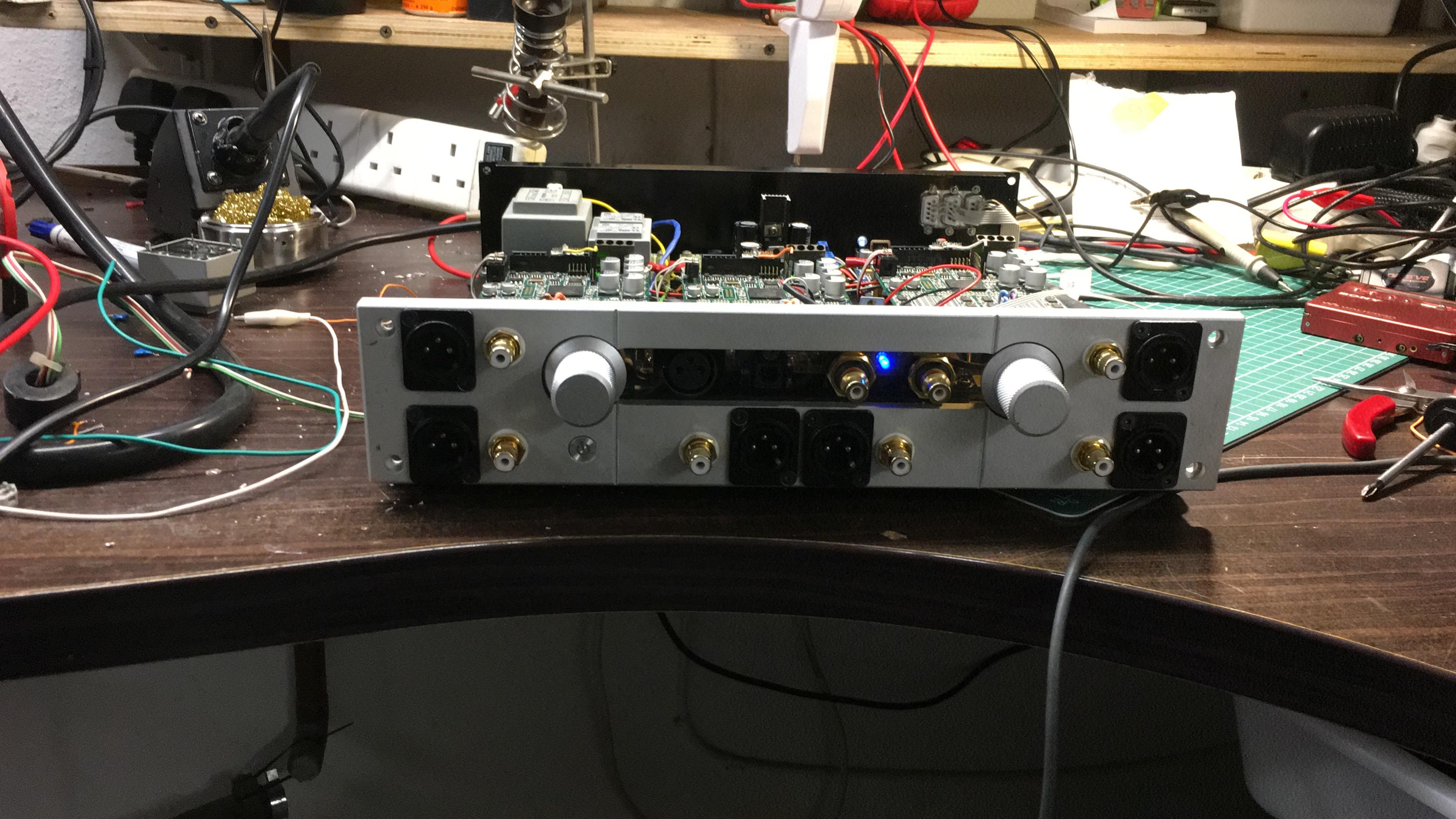

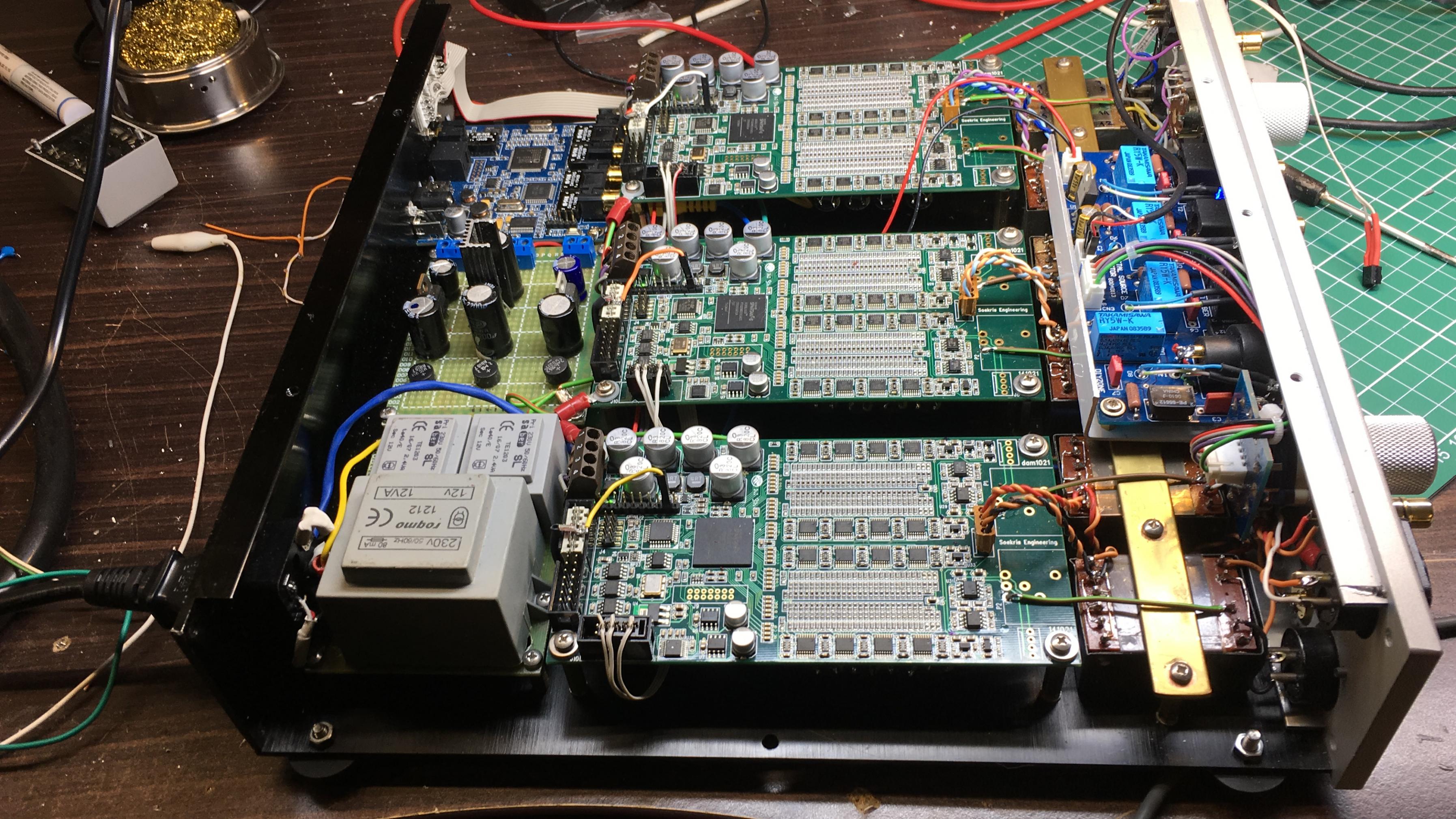

My soekris is finish....
One nanoDigi for crossovering, one input selector and the three DAC for output.
I use six LL1539 for balanced output.
Upgraded the 16 electrolytic on the bottom face with 1500µF per piece in the three boards.
Best Regards for the creator of this DAC.
Best Regards for all the gentlemen

Pretty awesome, its amazing what people are coming up with the dam1021.
I'd love to try an active crossover setup myself someday though I'd have to cough up the extra for another set of nc400's not to mention more dam1021's.
Looks good esteban!
Have you compared the transformers vs the buffered output?
Also, what input selector are you using?
Hi friend, for the input I connect the selector that has four input, all via transformer, one EBU, two coax and one toslink. The selector has on exit, that I connect to the coax of the nanoDigi. The nanoDigi has four out but one is without use.
For amplifier i use a J2 crossovered at 100Hz (42dB) the other amplifier is a Yamaha A700 AB I use for bass.
They are driving a OB with two 18 inches new woofer with high QT, in WMW and for mids I use a Feastrex 9 inches Electrodynamic.
I am making more projects in amplifiers and the OB has removable panels for change different configurations. But is useful the nanoDigi with OB for check several choices.
The good new is put the whole IN-OUT connections in the front faceplate for diy. For the next all my projects will have the same configuration, in the rear face only the supply connection. High nerdly type at all
Thanks for your words gentlemen

Esteban, that looks great, thanks for posting.
Just curious what power supply you're using for your dam1021 boards? I'm assuming it's one PSU connecting all three dam1021s in parallel? Or maybe there's three discrete power supplies crammed in there?
Nice work!But I don't think the raw can drive LL1539,Maybe use some op-amp to drive 1539 is more suitable.I've tested frequency response curve, driven by the op-amp circuit,the low frequency is better, more smooth.
