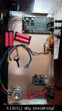

I heave also a „randomly loses sync” issue. But in mine situation in 99% it is a power side issue..
since yesterday Soekris plays from battery and it is rock solid..
You heave add a solid power supply regulator.. mine simple toroid was not enough.. for quick I will add some CLC filter..
I try to figured out if it is grounding or AC/DC side..

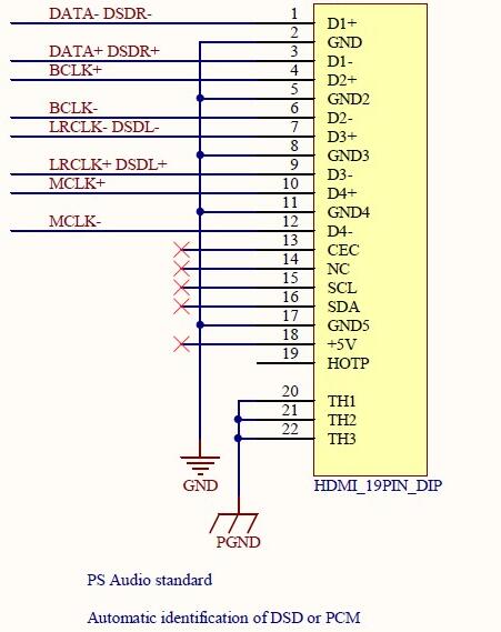

Audiozen, sounds really interesting. Do you have any information about pricing yet? HDMI would be good reason to wait for it if the price is reasonable.
Will there be hdmi passthrough for picture signal?
iis over hdmi is the 3.3v LVDS,not support any video or picture.Attached please find the detaill.
