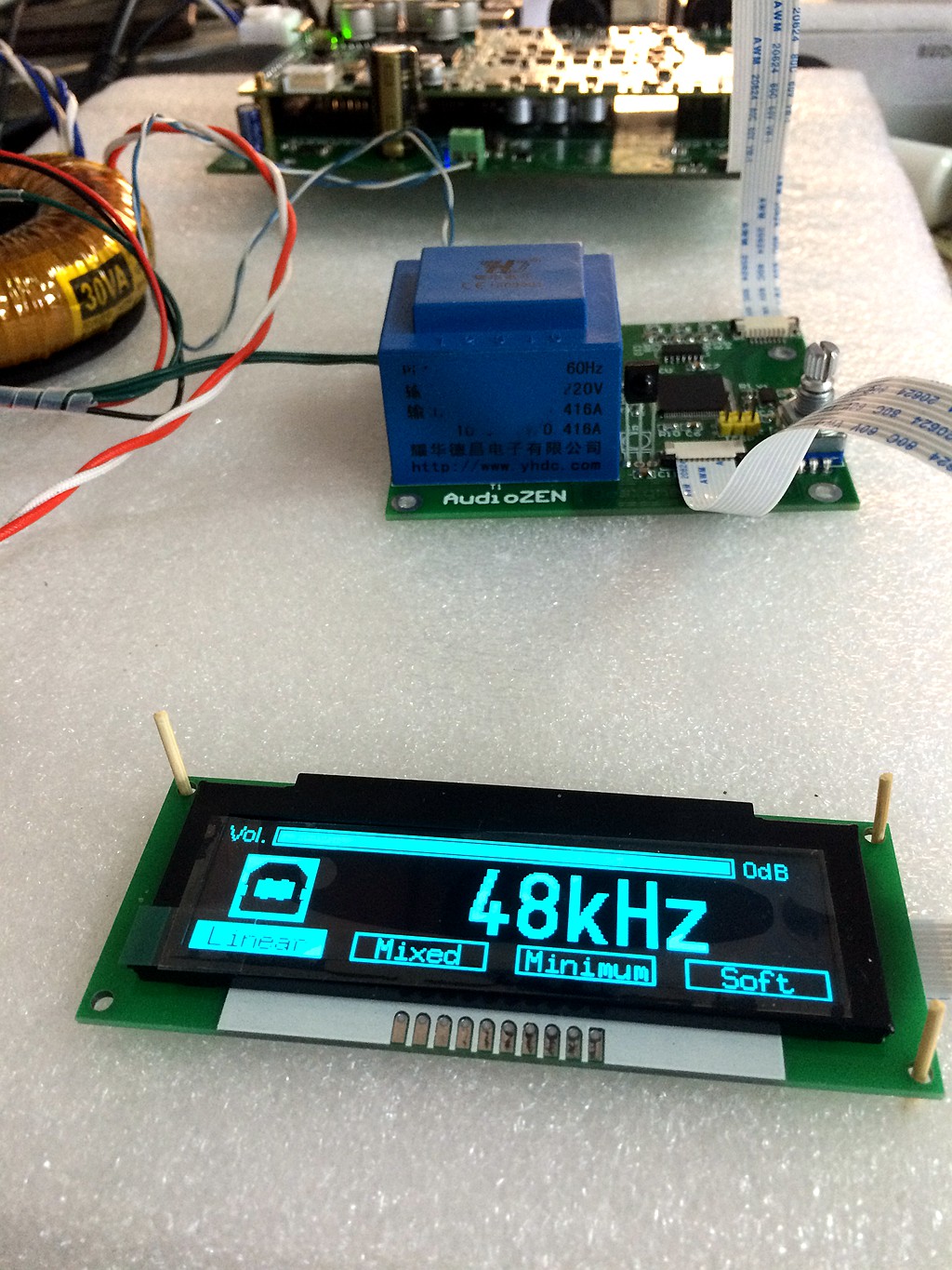

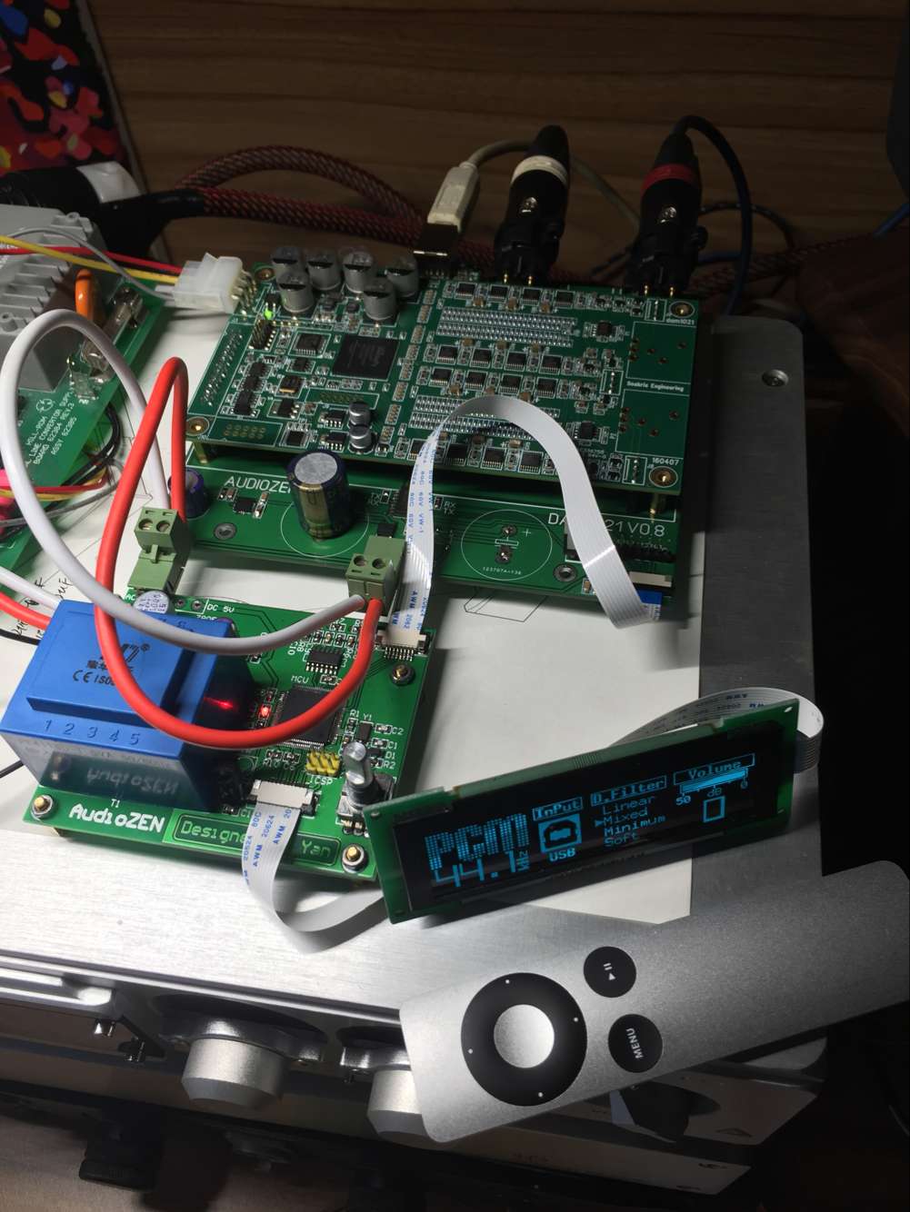

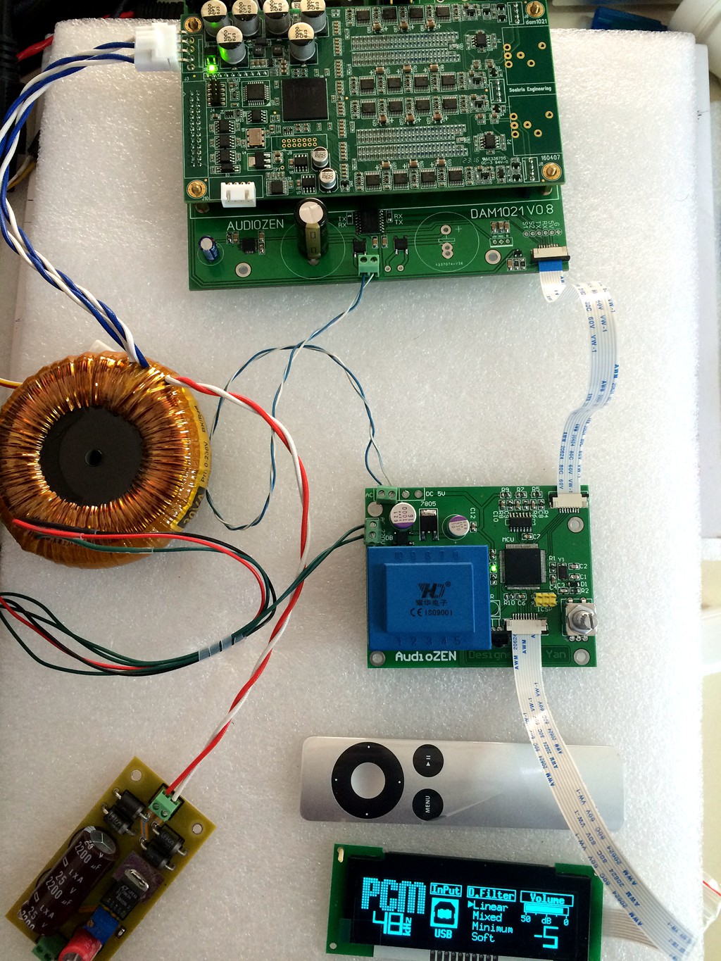

my intall kits for dam1021
My intall kits for dam1021😀 The work has been done!AES,Coaxial,usb, iis(hdmi),remote,oled display.
