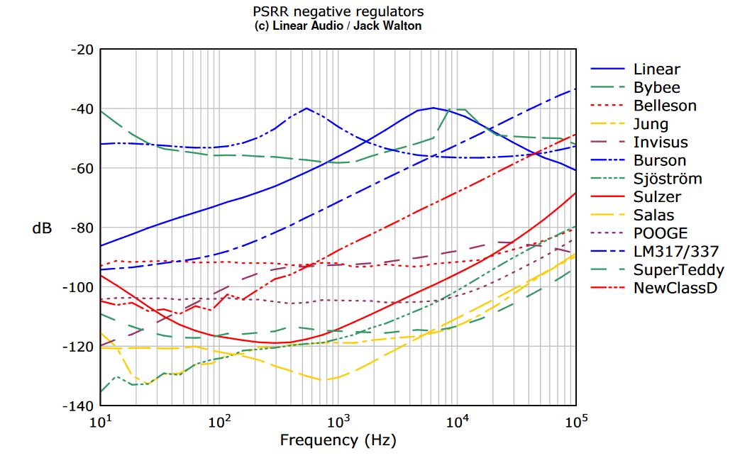

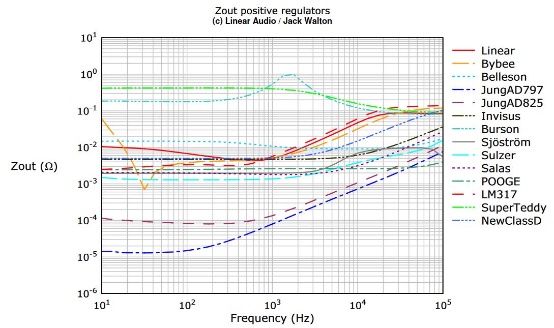

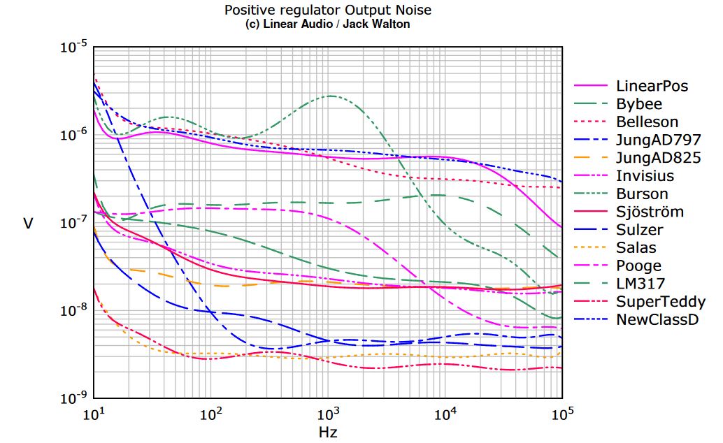

Power Supply
- Anyone have any measurements of the built in Power Supply? How does it compare to other external supplies? Most information I can find is either v1 or v2. The v3/v4 model is improved but how much?
- Perhaps another set of power input (J1) to bypass the power supply (if that’s possible). A built in supply is a very good idea. Still added flexibility is a plus.
- If two supplies are okay why did people ask for no supply in the 1121?
- I have attached screenshots which explains why I care. Measurements from Linear Audio (https://linearaudio.net/downloads) of all the top performing regulators.
