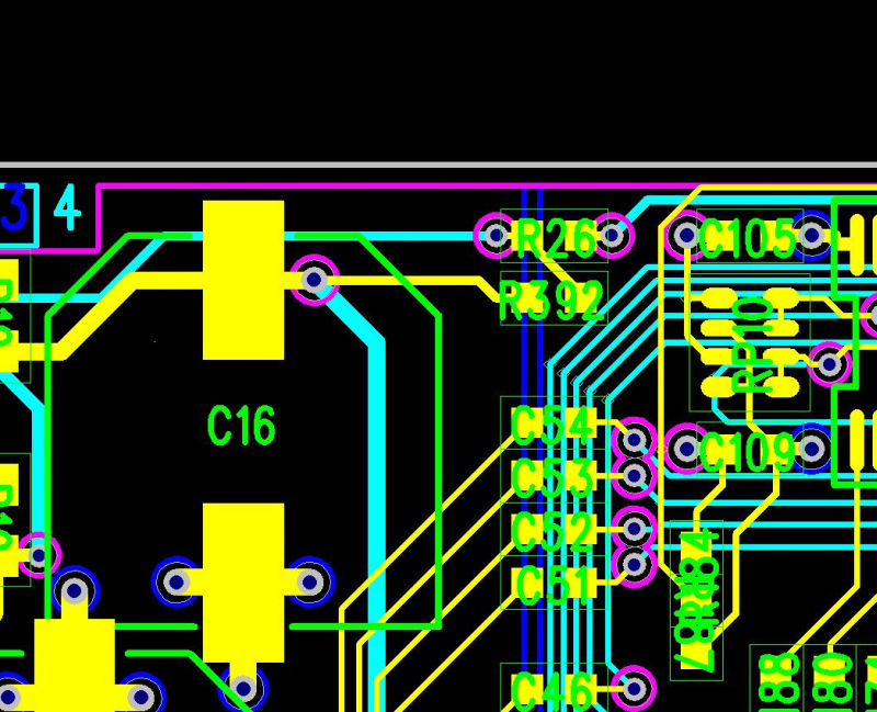

Please see below what I have done on dam1021 Rev 3 board.
1. removed bridge+rectifier and shorted
2. removed all buffer and balance opamp
3. removed all power rail caps (C20,C17,...)
4. removed mute transistor (Q4, Q3) just beside raw output
5. removed U5, U7 and shorted in/out
6. removed 3.3v LDO and supplying 3.3v from low noise PS
7. removed 1.2v smps and supplying 1.2v from low noise PS
8. Supplying +-5.000v on C16, C31 directly
9. Jumping +-5.000v on J2 +-A
The problem is I cannot get any sound. I checked +-4vref at (C104~C122) but only appears +-0.0106v.. what can I do? please help..

You might need to remove R392, it's part of the new mute circuit which you're trying to disable and powered from PWR_A+, which you seems to have done something to....
I don't know what voltage you have on PWR_A+ now, but either you need to ensure there are minimum 7V, or you need to remove R392 as, as far as I remember, the firmware would then assume you have an old board and not use the early warning power off....
