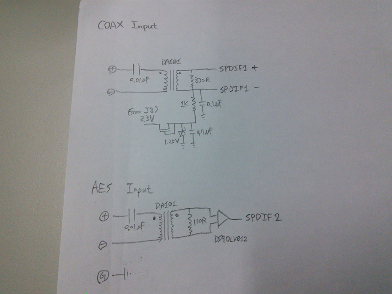

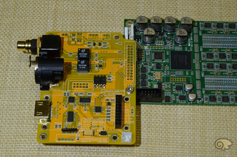

Dear everyone,
I have designed input board for dam1021 and tested it in this month.
And I have a problem when I test it:
When I select COAX input and AES has still signal input too, the COAX signal will be interference.
The following is interference:
1. The high frequencies part of music will be disappear sometimes.
2. The background may have additional noise when the music playing but without noise when the music stop.
On the contrary, when I select AES input and COAX still signal input too, the AES signal is stable.
Then I disconnect the S/PDIF2 line from J3 of dam1021 the COAX signal will become stable.
Has anyone encountered this problem too?
Thanks a lot!
The input setup as following:
COAX: S/PDIF 1 (+/-)
AES: S/PDIF2
USB and I2S(via HDMI): isolated I2S.
The dam1021 module is Rev.3 with R1.05 firmware, and the power supply is regulated +/-10V DC.

Dear Dimdim,A schematic would help, particularly the part that shows your COAX & AES inputs.
The schematic of COAX input is based on dam1021's user manual, and only the 1.2V supply is modified: I select LM4041-1.2(shunt voltage reference).
The schematic of AES input select DS90LV012 to translate to TTL signal for SPDIF2.
The 3.3V supply is from J3 of dam1021 board.

I don't know about the noise problem, but your AES input is no good, you can't use a LVDS receiver there without a voltage divider as the input voltage can be higher the its max spec. I'll recommend a RS422 receiver, see dam1121 example schematics.

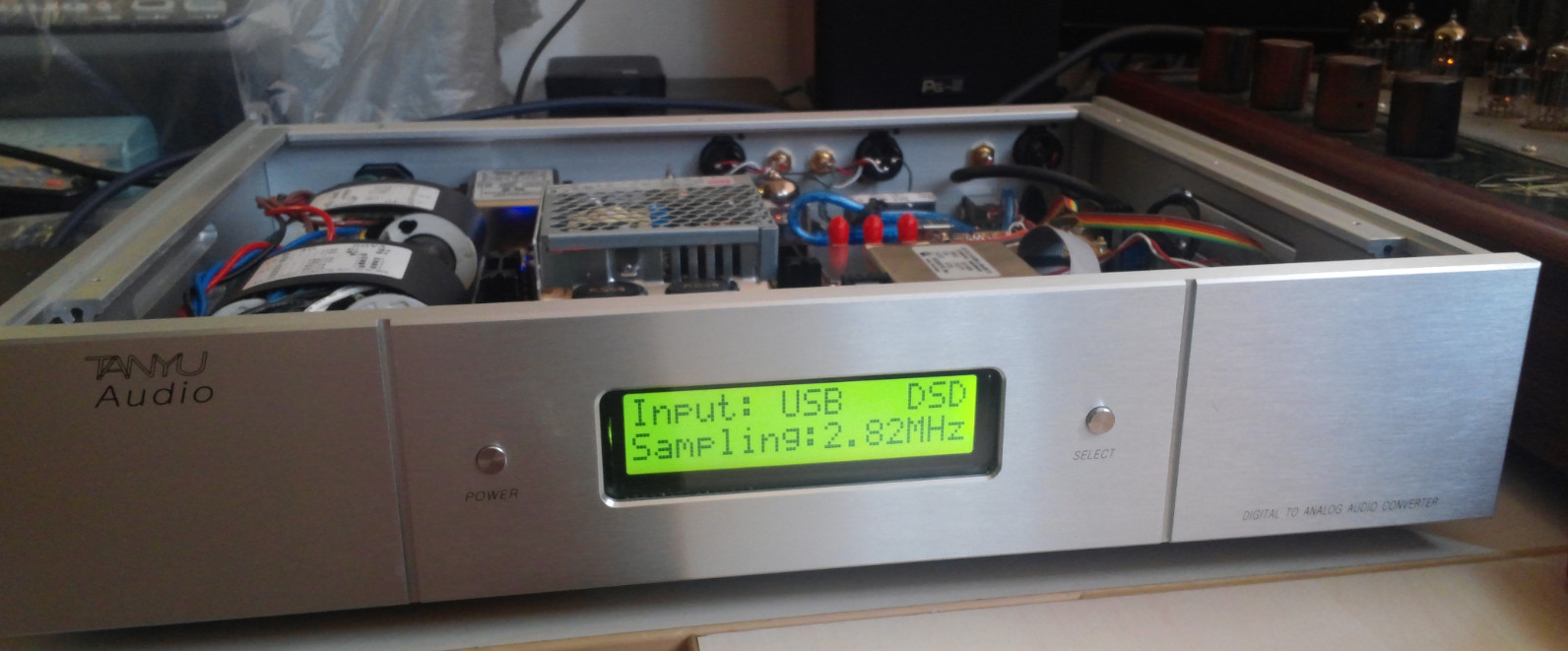

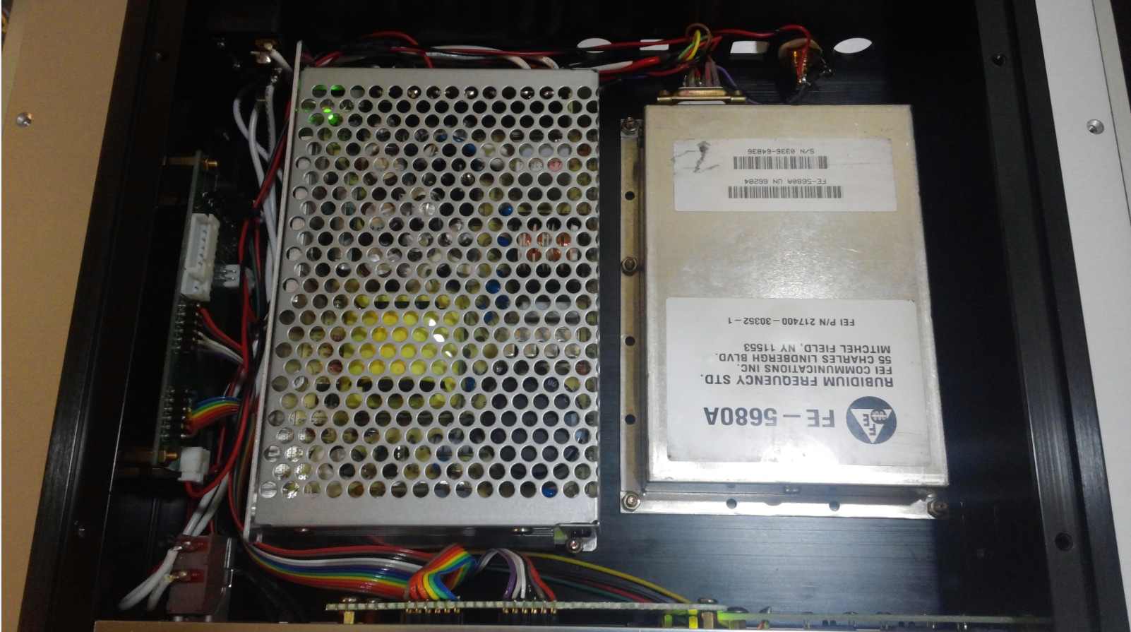

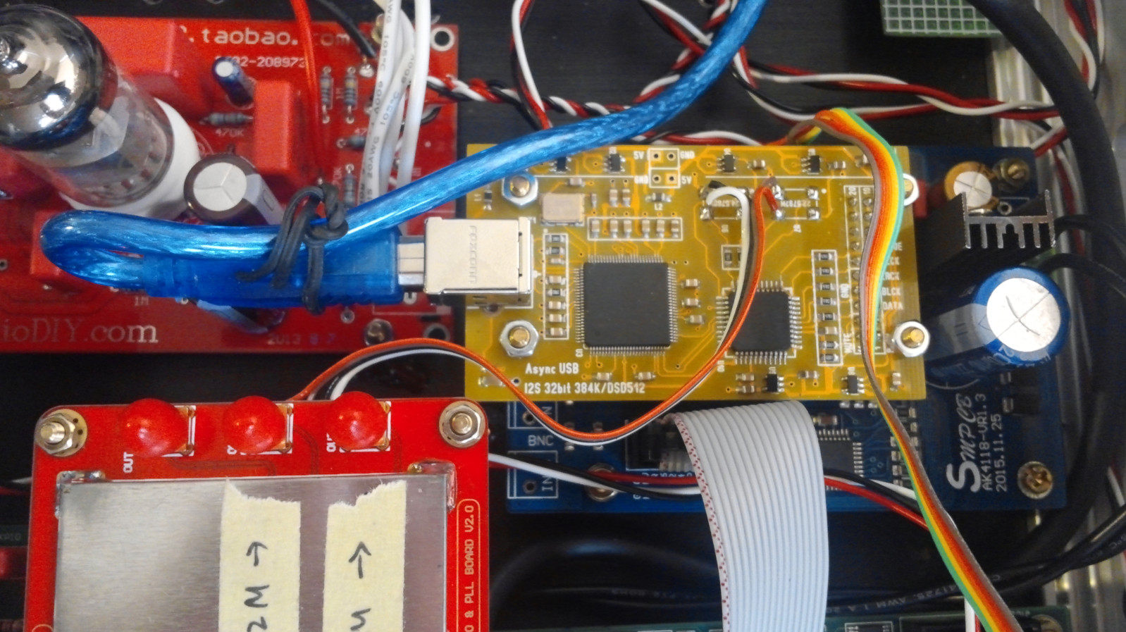

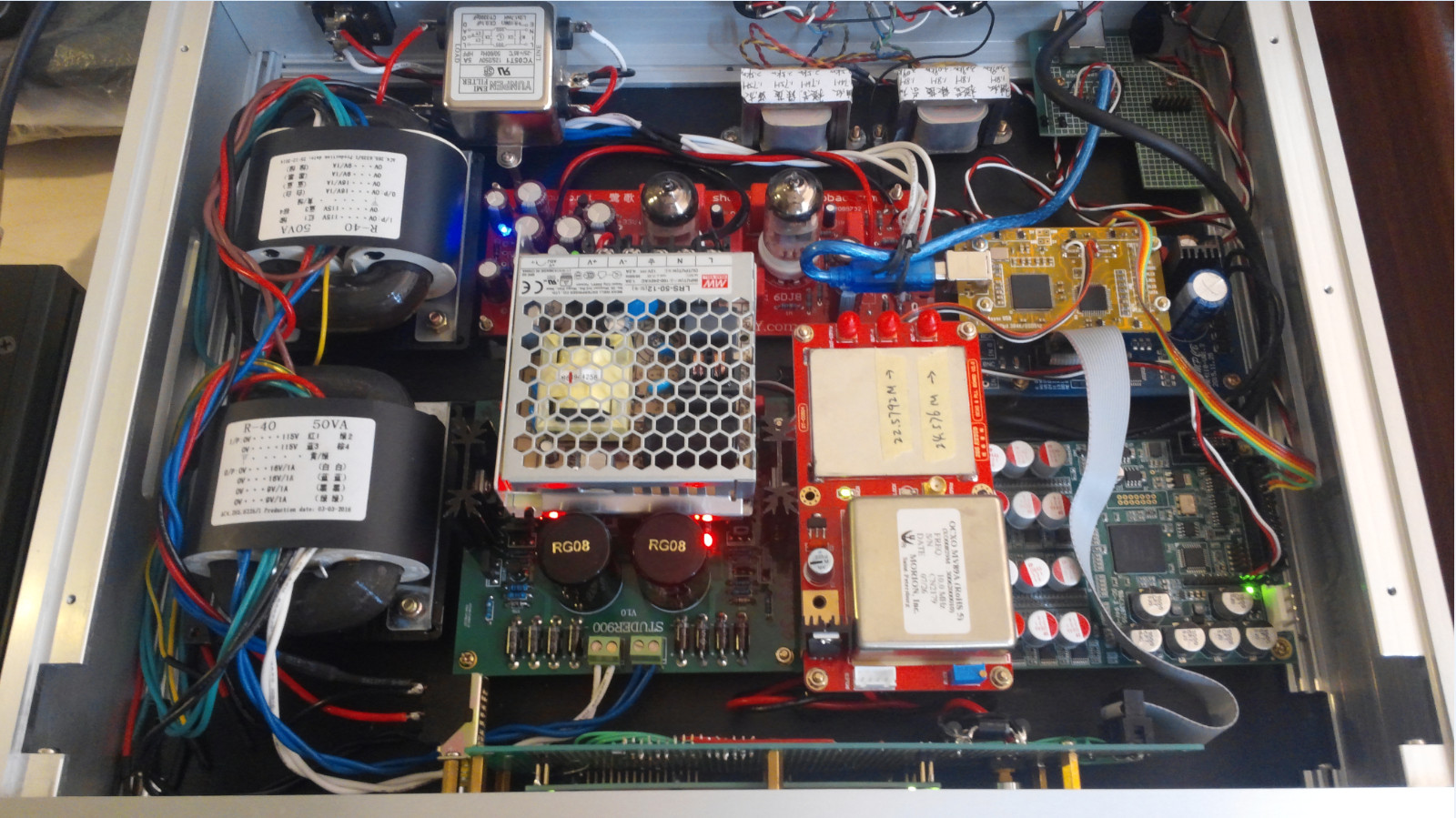

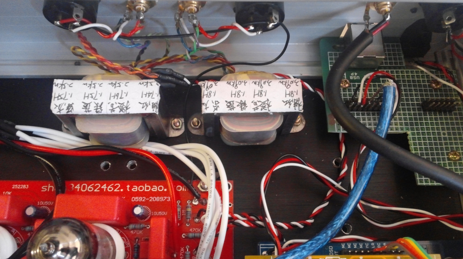

This is my build:
1. DAM1021 Case: https://item.taobao.com/item.htm?id=17218854916
2. Rubidium Case: https://item.taobao.com/item.htm?spm=a230r.1.14.152.C2WHbj&id=22548235665&ns=1&abbucket=10#detail
3. Regulated power supply board +/-12v for DAM1021 :https://item.taobao.com/item.htm?spm=a1z09.2.0.0.qDwlow&id=529453278199&_u=e1okcer33042
4. Transformer 50VA for DAM1021 and Tube buffer : https://item.taobao.com/item.htm?spm=a1z09.2.0.0.qDwlow&id=14005531061&_u=e1okcer3ee20
5. Crystal board 22.5792M and 24.576M for Amanero :https://item.taobao.com/item.htm?spm=a1z09.2.0.0.qDwlow&id=528569785461&_u=e1okcer3a5f1
6. JENSEN JT 123-s Audio Transformer:https://item.taobao.com/item.htm?spm=a1z09.2.0.0.qDwlow&id=524283985941&_u=e1okcer3b055
7. DAM1021 Display board :https://item.taobao.com/item.htm?spm=a1z09.2.0.0.qDwlow&id=520832497451&_u=e1okcer379cd
8. Tube buffer board(X-10D) :
https://item.taobao.com/item.htm?spm=a1z09.2.0.0.qDwlow&id=18874847033&_u=e1okcer35251
9. Rubidium FE-5680A 10MHZ : https://item.taobao.com/item.htm?spm=a1z09.2.0.0.qDwlow&id=521327229622&_u=e1okcer37209
10. Rubidium display board : https://item.taobao.com/item.htm?spm=a1z09.2.0.0.qDwlow&id=42929796788&_u=e1okcer3aeb6
11. HQPlayer : Signalyst
12. MUSO : http://klarita.net/muso.html
13. AUDIOPHILE OPTIMIZER : Highend-AudioPC | AudiophileOptimizer

I like the input board you have made! Are you planning to have that available for sale by chance? It appears you have HDMI i2s? I have been looking for that for a while. Hmm. If you get the bugs out of this board please keep me in mind, I would love to try one of these boards if it's possible 🙂
Keep up the great work Bill.
Dear soekris,I don't know about the noise problem, but your AES input is no good, you can't use a LVDS receiver there without a voltage divider as the input voltage can be higher the its max spec. I'll recommend a RS422 receiver, see dam1121 example schematics.
Thank you for your suggestion. I will take it into account in next version.
I will measure the AES signal voltage later to confirm whether higher input voltage induced interference on COAX or not.
Thanks a lot.
Dear bimmer100,I like the input board you have made! Are you planning to have that available for sale by chance? It appears you have HDMI i2s? I have been looking for that for a while. Hmm. If you get the bugs out of this board please keep me in mind, I would love to try one of these boards if it's possible 🙂
The transmission of I2S signals via HDMI is based on the “I2S over HDMI (PS Audio)”.
The USB and I2S use isolated I2S interface of dam1021 DAC, and high-bandwidth bus switch IC to select USB or I2S.
I will try to debug as far as possible.
Thank you for your attention.
.....The USB and I2S use isolated I2S interface of dam1021 DAC, and high-bandwidth bus switch IC to select USB or I2S. .......
Which IC did you use to select USB/I2S?
Dear derekr,
I use the TI's SN74CB3Q3257 as bus switch, and use logic gate circuits to control SN74CB3Q3257 status.
