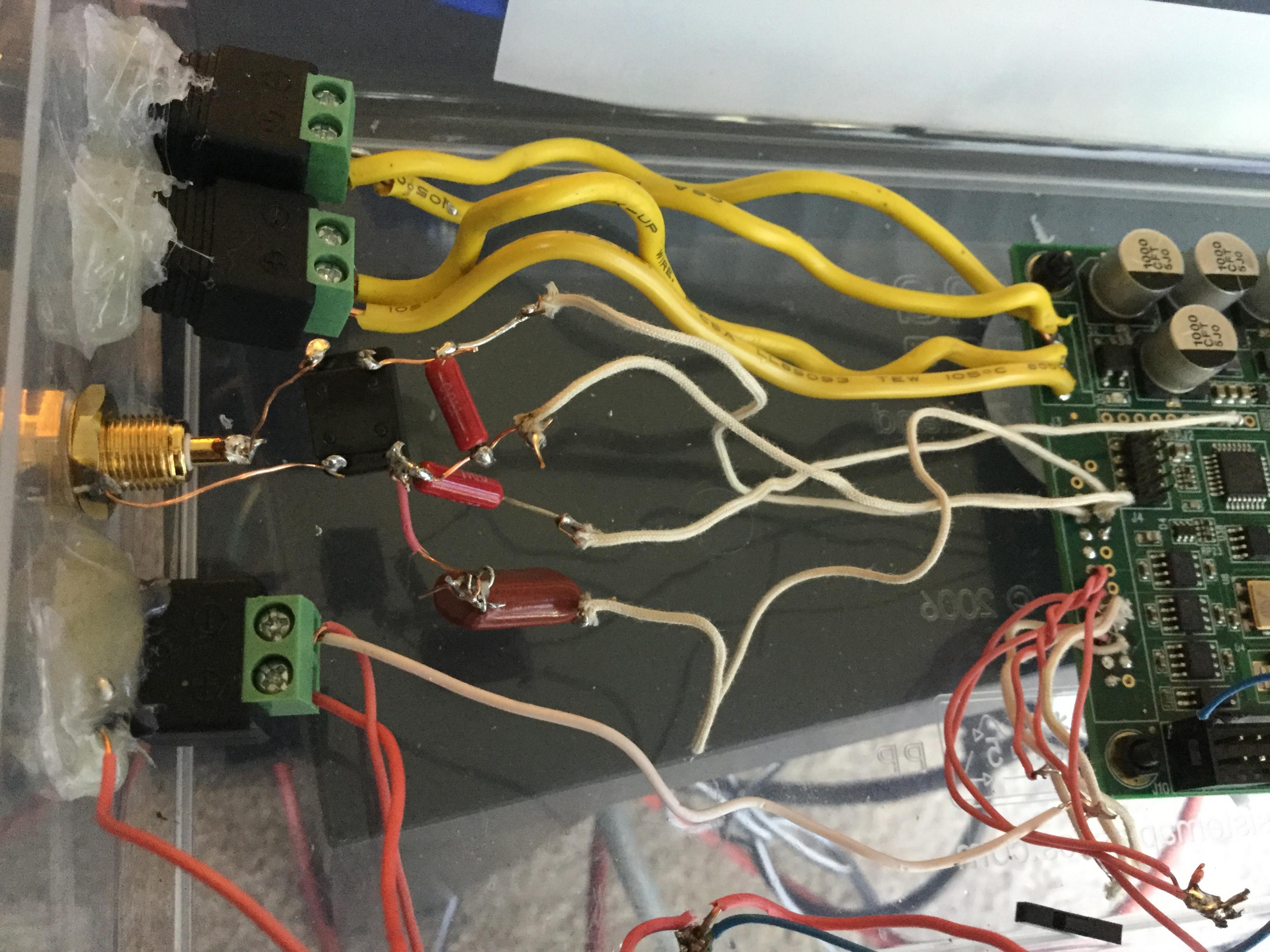

I'm not sure which signal transformer you're using, but it looks to me like you have it hooked up wrong.
Ugh. You're right. That's embarrassing. Thanks.
Argh. Trying to test out Spdif but it won't lock. I know it's a bit sloppy but do I have this wired right?
Using the diagram from hifiduino with Spdif+ Spdif- and Gnd
You do not need the transformer. Just have a capacitor in series and 75-110 ohm resistor in parallel.
