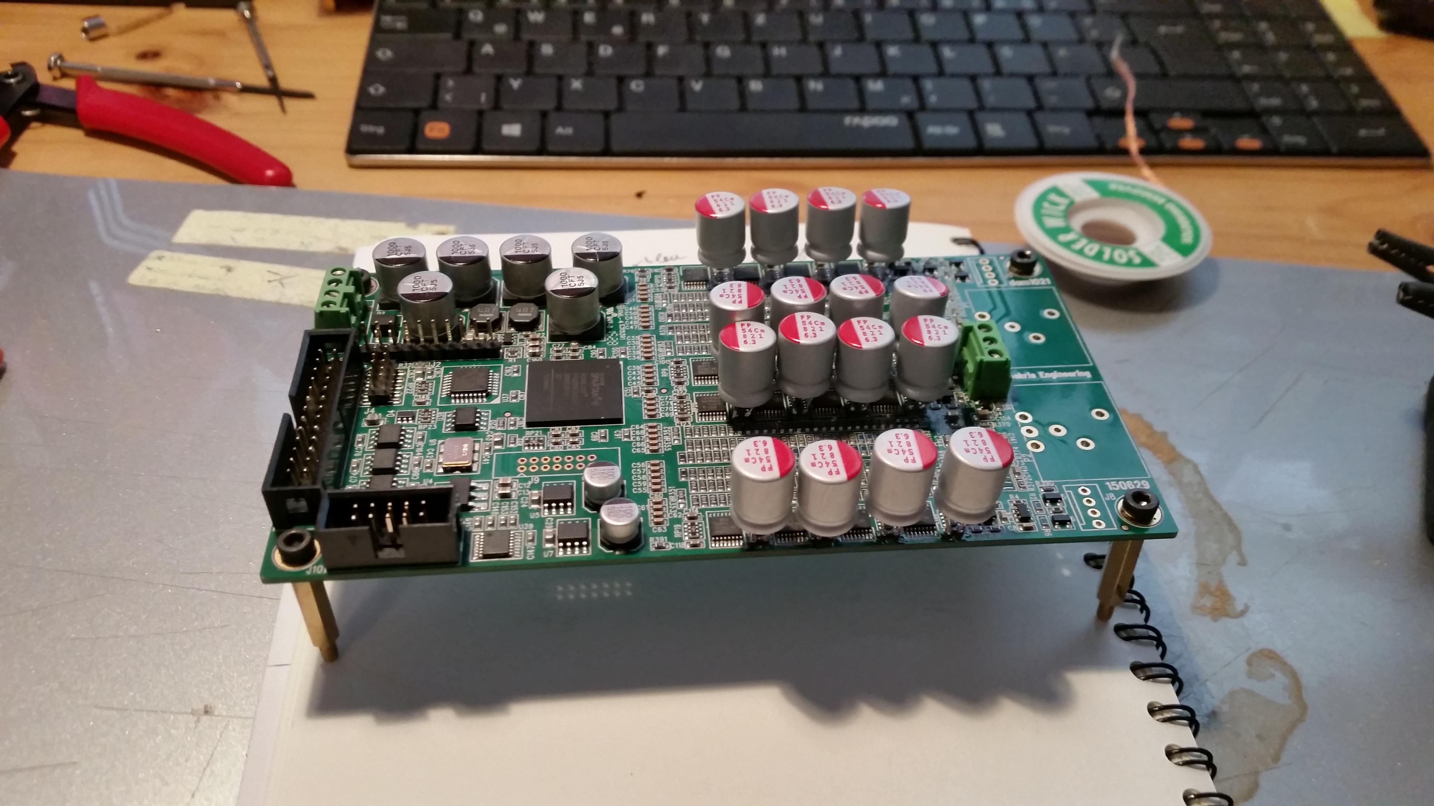

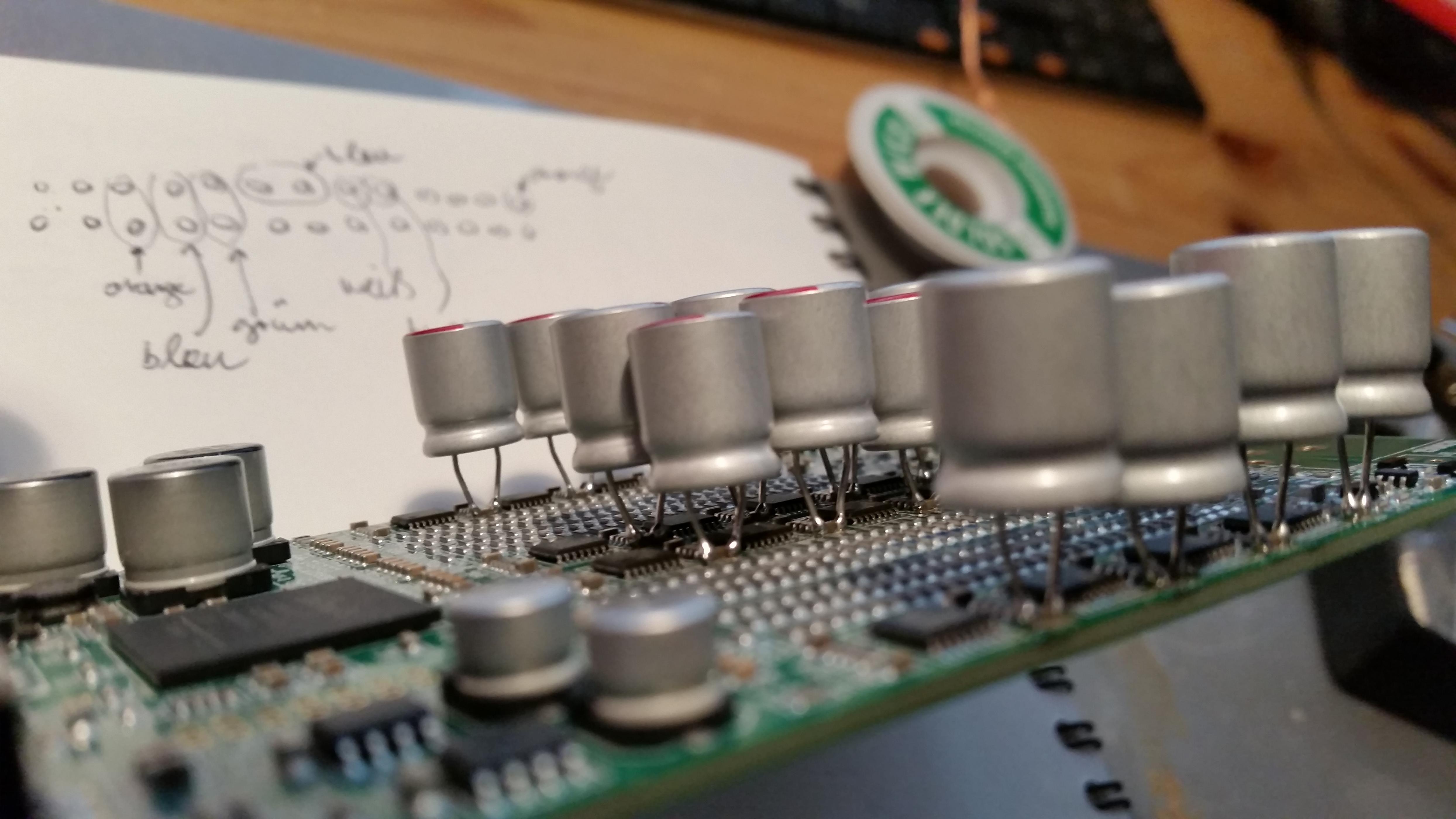

- First i have done the "16 caps mod" (16 x Nichicon Aluminium Organic Polymer Capacitors 16V 330uF) on a board from the first version. As Rodeodave says: "They are definitely making a difference (subjectively)." 😀

Nice !Another VRef mod, 16 820uF FPCAP polymer caps directly across the ceramic caps. They are definitely making a difference (subjectively).
Objectively too 🙂 (lower noise floor in ltspice)

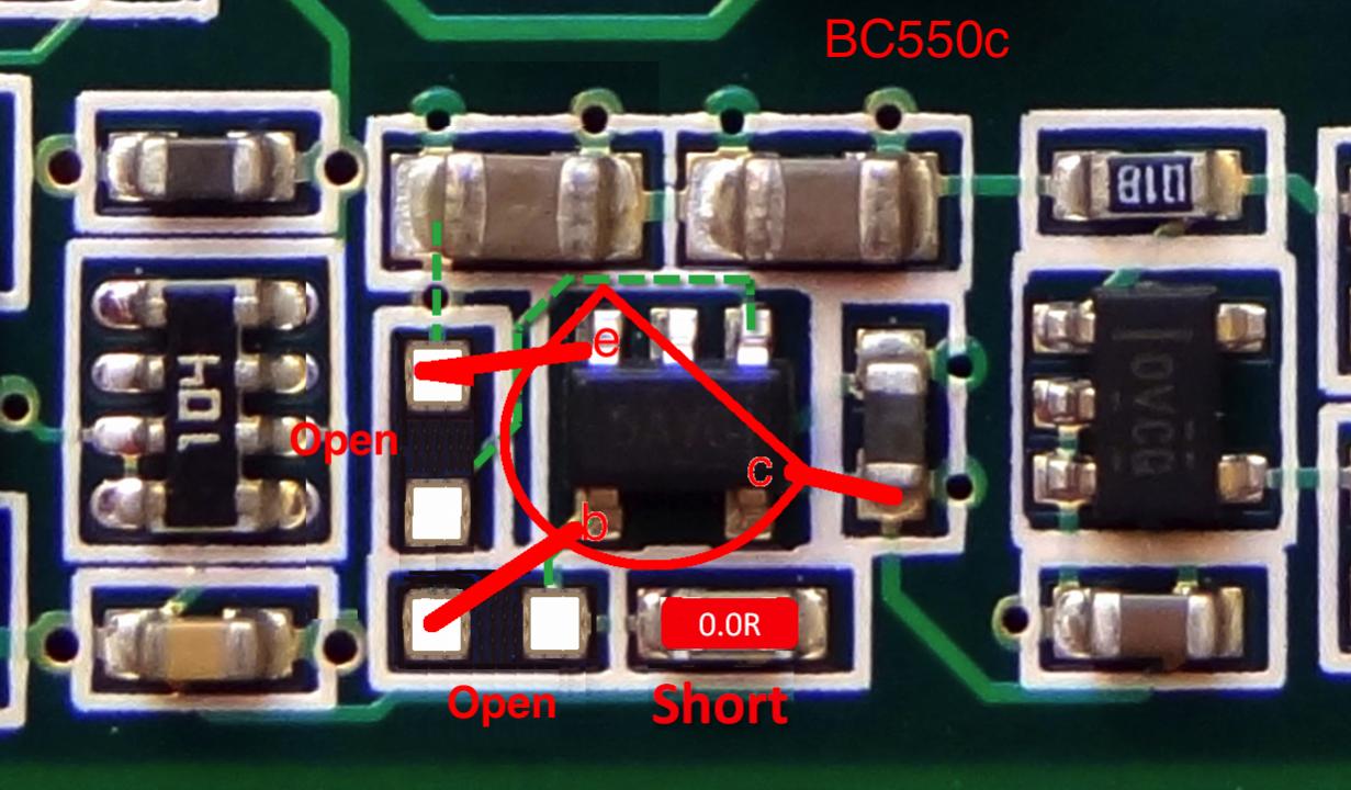

Is the transistor mod (BC550/560) can co-exists with official vref mod? Or will it be further improved?

It is an improvement to Official mod vref. Two components are removed and put one transistor. Co-exists with 16 cap.Is the transistor mod (BC550/560) can co-exists with official vref mod? Or will it be further improved?
Thanks.
I see from a later post that one resistor has to be short, is that true or I just leave it untouched?
