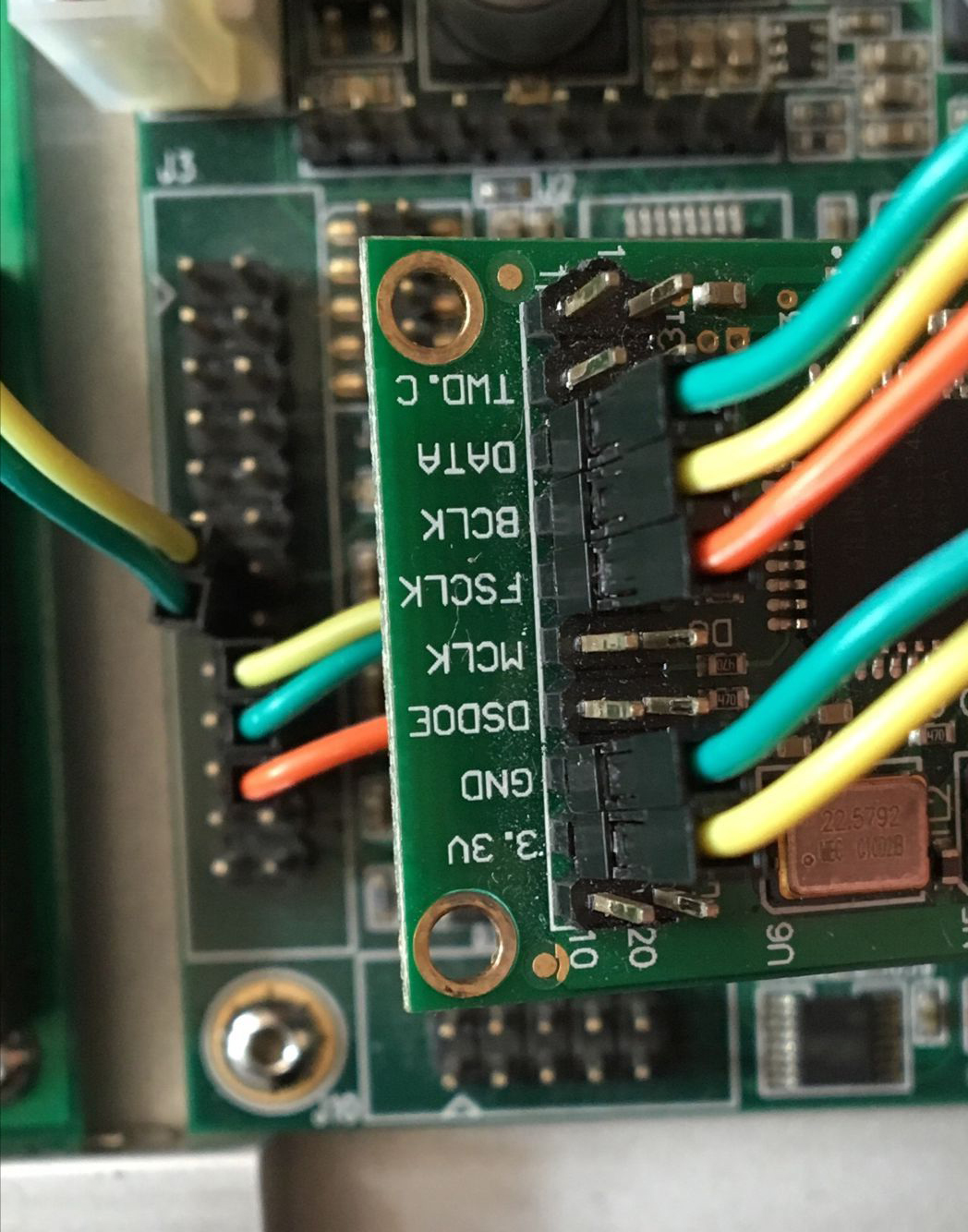

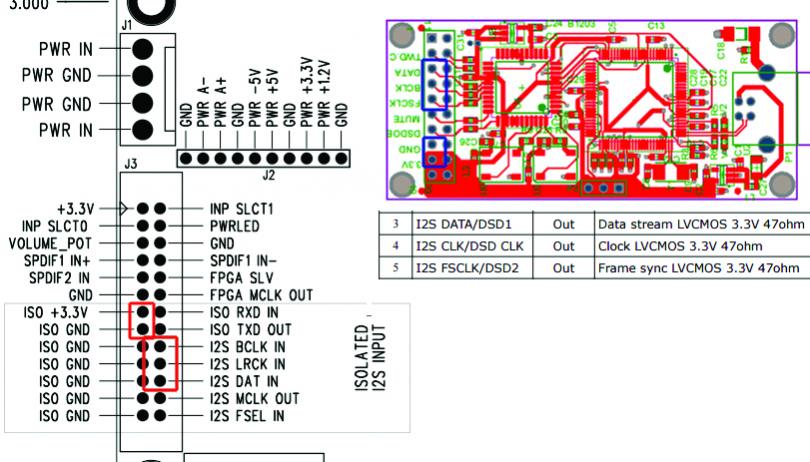

I have updated FW to 1.04
Connecting Amanero Combo 384 to R2R as attachment.
Using Audirvana Plus as player ( try DoP 1.0 and DoP 1.1)
When Playing DSD content, it works fine.
When Playing PCM content, CH1 not sound, CH2 song playing with loud noise
What's wrong? My connection is correct?
Best Regards
Best Regards
Oh
connection wrong
swap green and orange at R2R make all works
Thanks my expert friends
