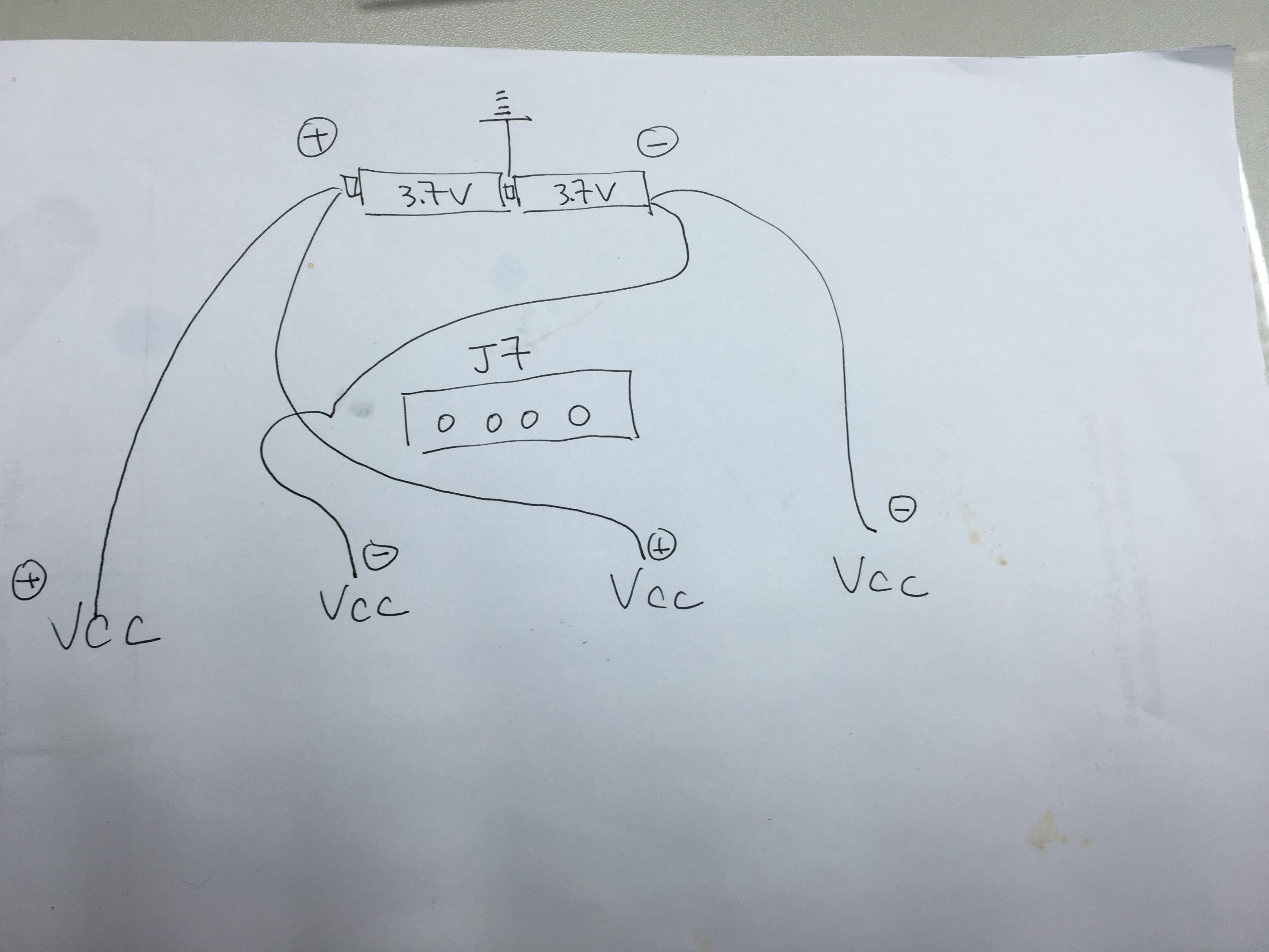

Battery supply to resistors
For battery supply, I bought 4nos of 3.7v rechargeable batteries and going to attach a battery box on top of chassis. 4nos of 3.7v batteries will be connected in parallel. I am going to connect all the 16 nos of vref of resistors like the photo shown. Can someone kindly tell whether correct?!
Also if the original 4v supply to resistor still connected to power up the resistor, will both power supplies will burn up the resistors?

I am going to use battery to replace the vref and direct feed into the shift reg. I've checked online about charging of lithium battery and it seems that charging IC should be used to prolong the battery life and for safe. In addition, I found that it is better to parallel multiple battery to yield better result.
So could you share with me the configuration that you did? I would like to parallel multiple battery, connected by relay when the dac is on, with another relay that connects to charging circuit when the dac is off and the charging circuit is on.

you need a switch on + and - vref
the polarity looks wrong on your diagram
if you get that wrong id very much doubt anything good will happen
wtf is that
besides a dac killer?
its a reasonably simple mod but very unforgiving for mistakes
please guys do your research
measure twice and cut once 🙂
everything is in randys blog or at tir na
be safe....
