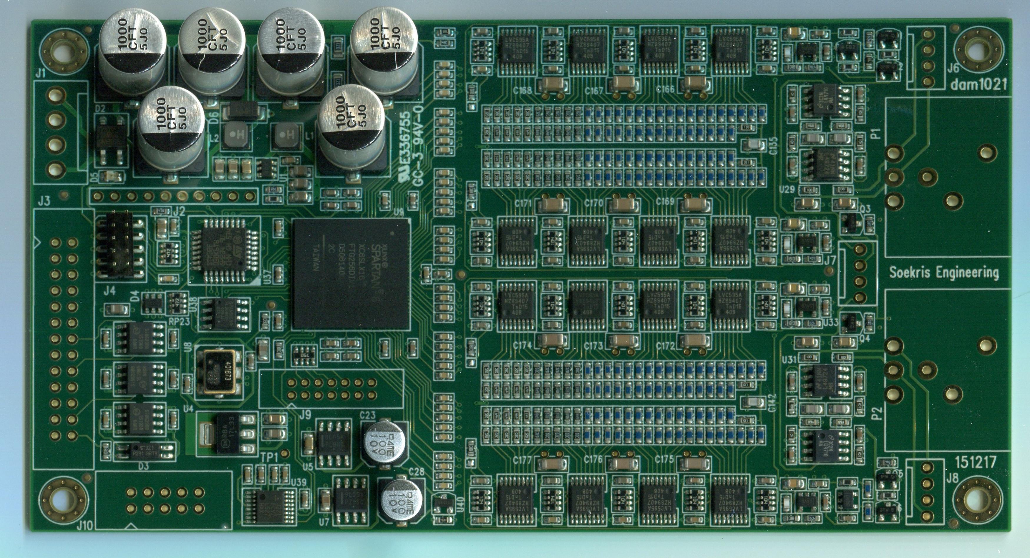

I just took delivery of my DAM1021 rev. 3.0 and as promised I would post a photo. Things that are clearly different between this and the picture featured on the Soekris website are:
1) Larger power supply caps > 1000uF rather than 820uF
2) Additional MLCC caps > C168 through C177
3) Large enough holes next to new MLCC caps that allow for caps to be soldered
4) Six transistors, Q1-Q6 on the output, I'm assuming for muting
5) OnSemi 3.3V regulator, lower noise than previous one
6) Switching regulator circuit reworked, large flyback diode
7) Added LED D5
8) Added D4, (zener)diode array, logic gate?
9) Added U40, MOSFET?

thanks for the pic

Missing 4 resistors rows...

Thanks for the nice pic!
1) Power supply caps became 1000uF in Rev2.
4) Q1 & Q2 existed since Rev1, Q3+ were installed in Rev2.
7) LED D5 was always there.
I believe that the missing resistors are due to the custom resitor values that Soren managed to procure.
thanks for the pic,
do you think the muting board is not necessary anymore?

No its not, and this circuit is also used in v2. Haven't needed muting circuit since. The only noise at poweroff is a slight click if anything.

Q1-Q6... is the raw out now going through transistors? Or is it still "really raw" as direct from the resistors?
I'm pretty sure there's nothing going 'through' transistors, there's no need for that. I'm assuming the opamp outputs are tied to the collectors of these transistors and they subsequently get pulled to GND when muting. Obviously they do nothing when the output is not muted.
That is a jfet parallel with each raw output, don't affect anything when unmuted....
