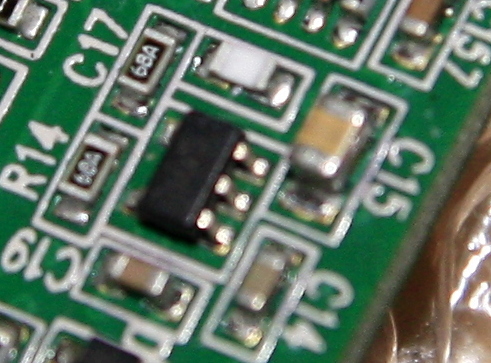

My board dam1021 arrived a week ago . I contacted Soekris but it looks like he has Christmas break. I have few question regarding this board . So I decided to ask hire.
1
Does this board have Vrev factory mode(see attach. pisc )
Two resistors are 499R and i dont know what is that white part next to the reg. Shall I leave it or shall put there 0.1 r as described i factory mod.
2 Shail I add cap to existing C15 or go for 16 cap mode or both .
3 Im using only RAW output , so what i gain by removing op amps .
4 Where shall I connect power from shunt reg to J1 or J2. What advantage give connecting to J2 ?

I don't, in my case (rev1 0.02%), I desolder the onbraod regulators but forget to re-input the 1.2V power, then it behaves similar to your case, the LED blinks but signal can't be locked. Reconnecting 1.2V then it works perfectly.
