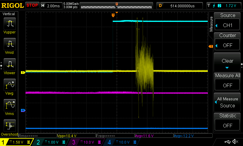

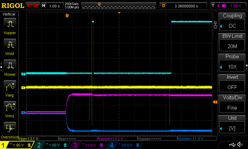

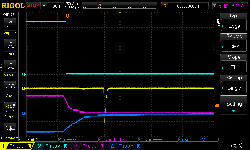

There seems to be a glitch on pin 18 during poweron that causes it to go high during one of the pulses emitted on the analog outputs. I used a 27k resistor, did not have 27k4 on hand.
Here are the signals during power on.
CH1 (yellow) is the unbuffered analog output.
CH2 (cyan) - pin 18
CH3 (magenta) - V+ on J1 connector
CH4 (blue) - V- on J1 connector
Notice how pin 18 goes high for a short while during power on. The last output pulse happens right before pin18 goes properly high. I would prefer to have a slightly longer poweron mute period, just in case the timing of that last pulse varies. Does it depend on the resistor value?
attachment.php
Zooming in we can see the pin18 glitch enables output right before a major pulse:
attachment.php
Power off looks good, pin 18 goes low before any disturbance on analog out.

You really check things 🙂
27K resistor is ok.
Looks fine on my scope, but checking the firmware I could imagine a situation, depending on how the dam1021 is powered, that could do that.
In you first scope screendump it seems like that the power off circuit is actually triggered just as the EN_AUD signal goes high as it power up again after five seconds.... Can you do the same plot, but with the -4V ref instead of the -12V input power ?
Will investigate and fix it.

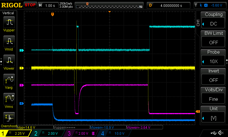

Here is a trace with Vref.
CH3 (magenta) is -4V ref
CH4 (blue) is -12V input power
This is with unmodified DAM hardware, only the 27k resistor is added.
Input power is +/-12V from simple LM317/337 regulators with 2x2200 uF filter caps per side.
Another strange thing is that the poweron output pulse amplitude is so high - well above 10Vpp, on one occasion I saw 20Vpp. How can those voltages appear on unbuffered output? Perhaps the output opamps are wreaking havoc?
