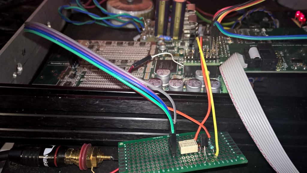

Another strange thing is that the poweron output pulse amplitude is so high - well above 10Vpp, on one occasion I saw 20Vpp. How can those voltages appear on unbuffered output? Perhaps the output opamps are wreaking havoc?
Mystery solved - I had accidentally switched the scope probe to 1X mode. Thus, the power on spikes are not 10-20Vpp but rather 1-2Vpp which makes a lot more sense. Does not make the power on plops any less nasty though...
A pin18 driven muting relay is working pretty well, just need to make the power-on glitch go away. Here is my ghetto-style prototype :)
