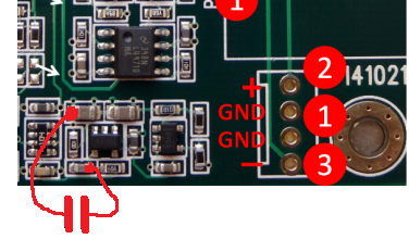

Reading the page of our DAM-master friend Paul, and measuring various parts of the source of 4V, I realized a lot of noise in the opamp output, this noise that was being filtered by output capacitor and the 10R series resistor. This noise was being generated by some signal difference between inverting and non-inverting inputs of opamp. Clearly we have some trouble here! I tinking the ceramic capacitor used here was not doing its job, since we have approximately 0V on the same, and high-K ceramic capacitors sometimes dramatically reduce the capacitance value when used with no DC bias. But when I bypass this capacitor with an 47µF electrolytic, the noise reached 100mV at opamp output, worsening the noise on the 4V out capacitor. Instabilities, is it? Or potential/noise difference between reference and feedback line?
Anyway, I decided to grab this electro capacitor and direct connect in the output. In theory, we now have a single gain unity stage and without using the stabilization feature, but I got a VERY good result, and now is totally impossible for me to see some noise from the 4V source on my oscilloscope! It's very clean! If I ground the signal oscilloscope probe (or disable the oscilosc input) results in same trace!
So there is the tip, and if someone wants to prove it in practice are welcome.
Soon I make one illustration to show the cap position.

Illustration here...
This worked very well in practice, without instabilities!
I'm are using the Nichicon FP series I talked in some earlier post, and I confirm their efficacy: I have measured a little less interference than alecm before making this "strange"-upgrade. Definitive recommended!

Since this cap operates without biasing, I recommend using bipolar electro or at least an ceramic with guaranteed value with 0V bias. If you use an polar electro, you not need to worry about polarity due to 0V bias.
Ops, your photo differs in some parts positions in 4V reg circuit. This is an different model/prototype?
Since the 4 regulators use the same component positions, you can copy the positions to other 3 regs based on my illustration, but make sure if your PCB is same from my illustration.

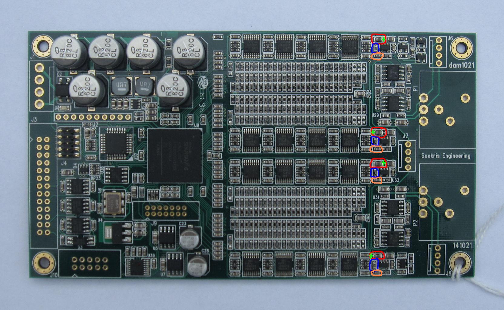

Okay, here is the official recommendation for vref buffer circuit, after I spend some time simulating and real hardware testing. The original circuit was ok, I didn't spend that much time on it originally as things seems to work fine. But yes, there is room for improvements there...
The output capacitors, marked with red, can be paralleled as much as wanted, but a single 47uF X5R 0603 capacitor is really enough and will fit nicely.
The output series resistors need to be much lower, I recommend to parallel the existing one, marked with blue, with a 0.1 ohm 0603 resistor.
The feedback need to be moved to before the output resistor, by paralleling the feedback capacitor, marked with orange, with a low ohm resistors, t.ex. 0.1 ohm 0603.
I strongly recommend to parallel additional parts instead of removing parts as there then is much less chance of damaging anything.
These modification will result in less than 1 mV p-p ripple, at all frequencies, with no peaking or changes in voltage precision. It's also what the next production series will look like.

The "feedback" cap and the 10R res are inverted in your photo.
The Soekris PCB photo showing factory upgrades is equal to mine PCB, but not the upgrade; my upgrade change the buffer behavior.
Ironically, my upgrade also results in very low noise and zero peaking in 4V line, so I will make other channel with Soekris propositions to compare.
Would be bridging those resistors an option? Or do we need those little 0.1 ohm resistances?
You need to have those small series resistors on the output, otherwise you will get a peak on the output with those large capacitors.
You can use shorts for the feedback capacitor, but since you already would have to source those 0.1 ohm 0603 resistors it's easier to use those as shorts....

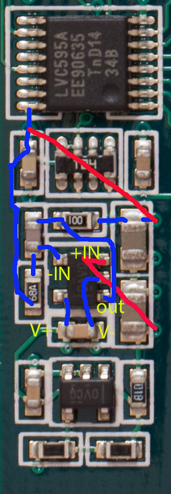

If I traced the PCB correctely this will short out and In- (red on the back or inner layer).
Not exactely what I would understand by "feedback to be moved to before the output resistor".
100% feedback is still feedback 🙂 Also called unity gain buffer....
With this illustration I see I make an AC buffer with my coupling cap, and that will not have the 0R1 proposed by Soekris so maybe it have some peaking. Is more easy and correct in principle using the Soekris proposition, but even so I will compare the 2 alternatives.If I traced the PCB correctely this will short out and In- (red on the back or inner layer).
